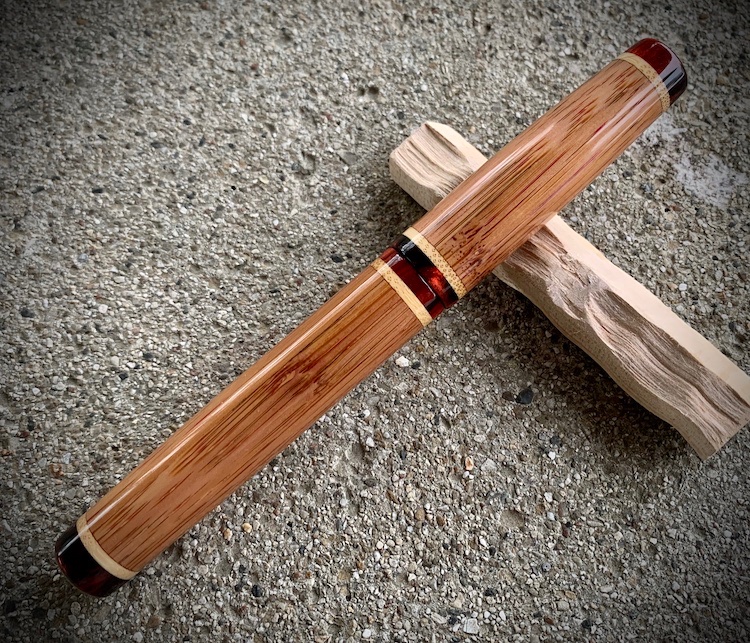

Got a bamboo blank from Woodcraft a long time ago. Decided today to turn it for a Fiona kit. Started with the skew and was not impressed. The bamboo is laminated with layers at a right angle. The end grain chipped and splintered. OK, let's keep going and see what happens. After all the end grain was turned off, I had two nice pieces with the grain in the line of the tube. Now to finish it. Will try to remember to post the final pen.

I used CA to finish it. I started with a used cutting board. The barrels I stabilized but it really didn't need it but you can see some red in it though.
