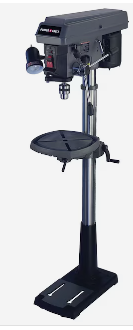

I still have the owners manual for my (1994 Northern) drill press. I have the receipt in the manual, something I never do, I paid $225. Would have to spend a lot more today ($1000?). I got the new chuck from LittleMachineShop for less than $50. Show us a photo of your drill press, what year and make? It might be a keeper.
Sure.. Here you go and thank you. Porter Cable Standing Drill Press 2016
