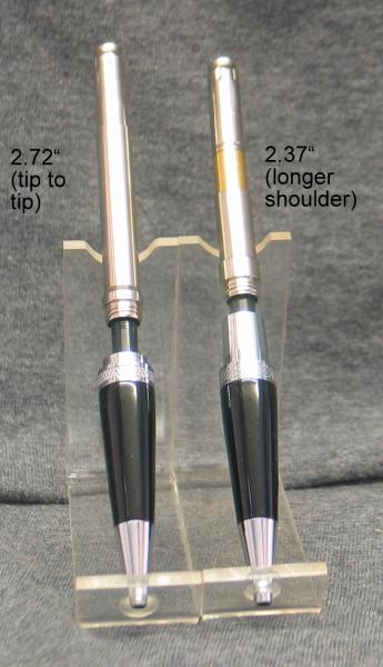

Ernie at Bear Tooth Woods had Sierra transmissions at one time, but I don't see them now :confused:. The Village Workshop has them listed but I've never done business with them. I would make sure the transmission length is what you need (2.72" or 2.37" -- tip to tip -- product photo looks like the 2.37"). I have "sierra" type pens with both lengths and not sure if consistent length from one vendor or not.
