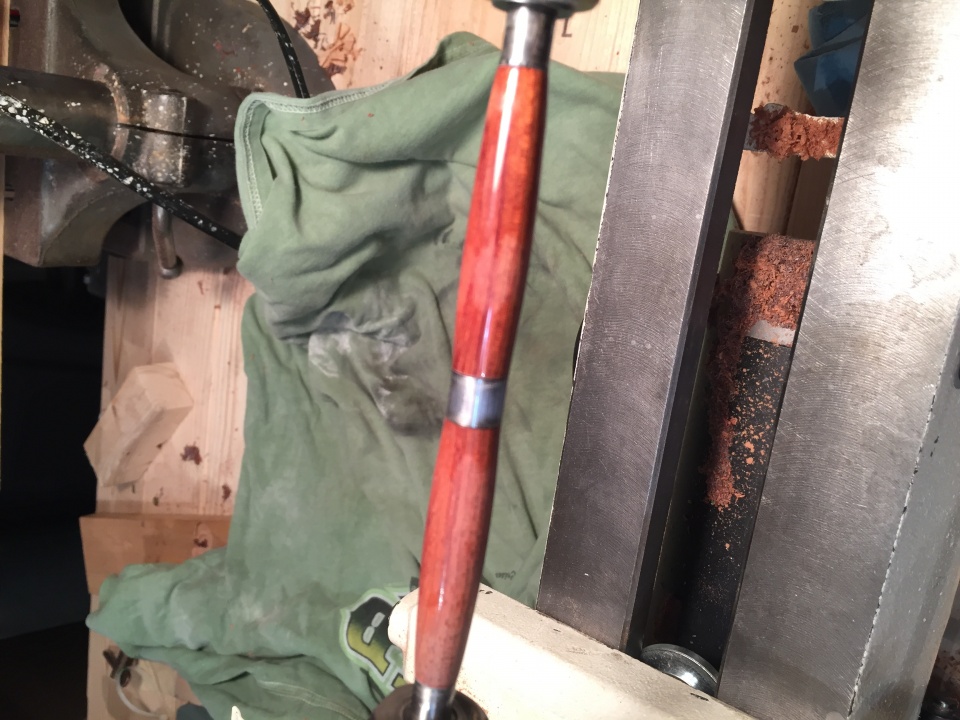

I keep having a problem getting a good finish with CA. I turned the blank (bubinga). Sanded it to 600 and it looked fine. All smooth and no visible scratches. I had lathe on very low speed and applied Super-T Orange CA with paper towel then gave it a spritz of accelerator, waited a couple minutes then repeated this 4 times. At this point the blank looked fine with the exception of swirl marks from the CA application. I then sanded it with 600 to bring some of the swirls out then used micro wet/dry sanding pads to 12,000 and this is what I get. The blanks feel smooth and pass the fingernail test but there are huge blotch areas that remain "unpolished". I have absolutely no problem with acrylics. Can anyone tell me where I am going wrong with wood?

Yep, I remember that same look when I first started doing a CA finish. Like Sylvanite said. looks like your sanding through the CA.

I just *fingers*crossed* stopped doing that myself. At first, I was causing big enough lumps in the CA application that, by the time I'd sanded them down, I'd burnt through to bare wood somewhere else. What really helped me was turning the lathe speed up. Initially, I was applying the CA at 700RPM. By switching up to 1600RPM, I'm applying the CA MUCH more smoothly which turns into less sanding and no burn-through.

Thanks very much to all of you. In looking closer at the blank I am sure that you are all right on. One of the Youtube vidoes I saw had a guy applying the CA by hand turning the lathe. I am going to opt for higher speed and a little more CA. Thanks again.

I would hold off on the "little more". Try to apply too much at once and it doesn't set fast enough and becomes a snot ball. I did that one too.
I use a single drop of CA about 1/8" in diameter to do the full length of a long-ish blank like the Rollester. One drop wiped on at 1600RPM, short shot of accelerator, 30 second (using a timer because I always guessed wrong) pause to let it set, then repeat. 3 coats of thin followed by 10 coats of medium. So far, that's working reliably.

Do more coats, not more ca for each coat. Many people go through the same thing when starting with ca. As you get more practice you will get the coats to go on smoother and therefore will require less sanding and you won't go through the finish.

You still never said how many coats.
Is the ca you're using thin or medium?
I can't see how really fast speeds would help anything. Anywhere between 300-700 has always worked well for me. Good smooth application is what's most important.
I've actually done the turn by hand method in the past as well with medium ca. It works well too but I found that it was absolutely essential to sand between each coat.

I have been using Super-T Orange (Medium). After reading all of your helpful responses - I have been applying too much at a time (a 6 to 8 drop puddle on a towel) and only 3 or 4 coats. Yesterday I purchased some slower setting Stick-Fast thin and medium. Now all I need to do is practice what you all have said. You folks have done some really beautiful work.

I also had the same problem until just recently. I started using a medium CA instead of thin and applying about 8-10 coats spraying with an accelerator in between each coat. The trick is to get a nice even coat, so I usually go across the pen twice in each direction with each coat of CA so it smooths it out well. After my last coat, I wet-sand using Acrylic Polishing Pads, I skip the first one and start with 1800 grit and work down to 12000... this has worked great for me so far. Best of luck!
