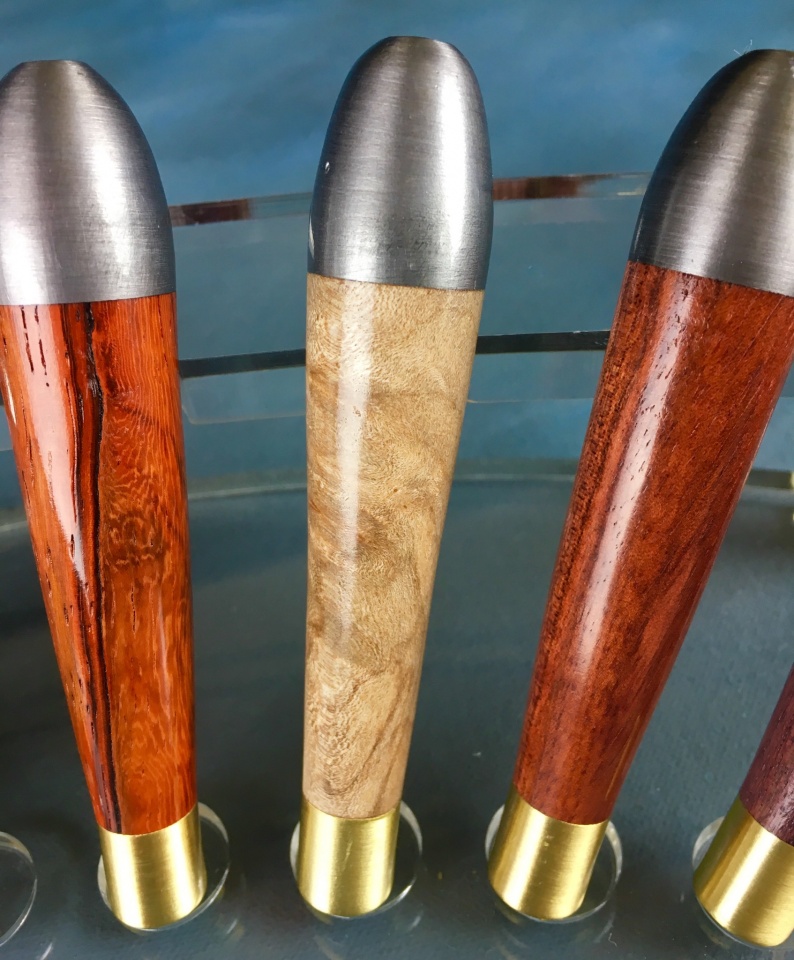

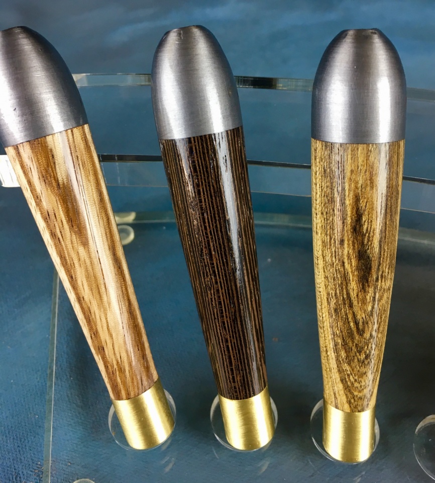

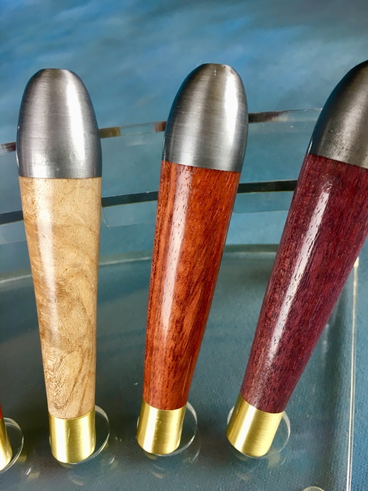

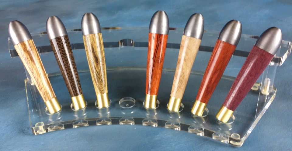

These are exotic hardwood "cedar" plugs used for saltwater fishing. To make them requires quite a few of the pen turning techniques. They were purchased fir a display and not for fishing so additional buffing was used to bring out the shine.
Luckily I have made over 500 so far. If the albacore run this year many more will sell.

I am gonna plead some ignorance, I get the concept of making them, but I have no idea what you would do to fish them. Do you mind explaining that on here to us inlanders.:confused::confused::biggrin:

You send monofilament line through the plug. Then attach a special hook called a needle eye hook to the mono using a crimp. The mono is pulled back into the plug and this special hook goes up into the tail of the cedar plug (brass end). Troll it behind a boat in the ocean and lots of different fish eat it and find out about the hook the hard way.
Here's me with a 25 pound class yellowtail caught on one of my plugs. You can see the hook, crimp, line and cedar plug made of purpleheart.
Pray the albacore run this year close to San Diego; I'll be rich!

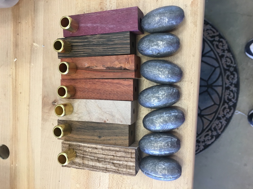

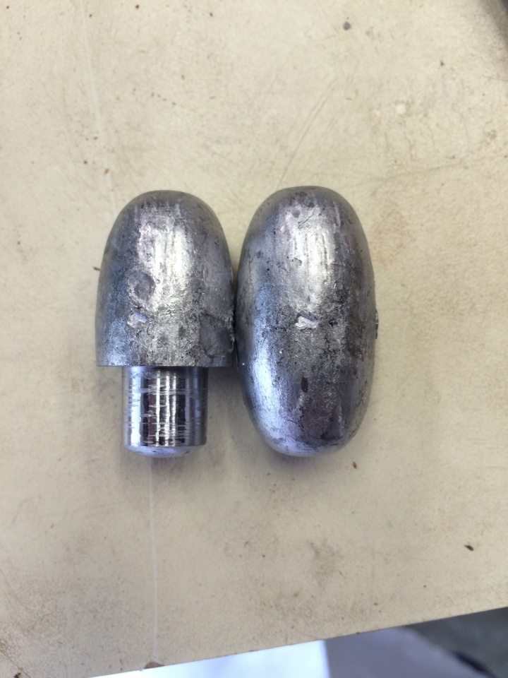

Turning lead
Just curious. From the looks of your parts picture, do you turn lead weights?
Yes, carefully. Here are before and after photos. To think I used to be afraid to turn a tenon on a Euro pen!
