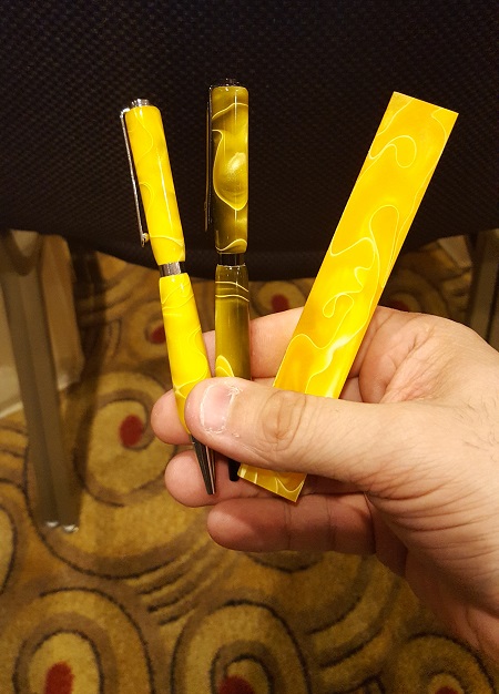

Here is an example of the same blank reverse painted two different colors, one is white, the other is black.
(not my pens, they were part of a demo at the MPG in Ohio this year)

The yellow pens above were part of my demo in Ohio. I use Testors paint to paint the hole with a q-tip. For 7 mm you will also want to over-drill. I use a 9/16" bit to give me the clearance for the paint. Never had an issue with the 10 mm and bigger. I know a lot of people suggest painting the tube and it works, but what you are trying to accomplish is bouncing the light back to the blank. Painting the hole the light will reflect through the blank and then back. Painting the tube the light now must pass through glue also. Both work. You can choose my experimenting. Just my opinion.
As you can see for the demo pens above you can also take advantage of the fitting to fool the eye on the color. The darker pen has black fittings to enhance the dark tones, the light used silver. Adjacent colors impact the perceived colors.

mg , thanks for the advice and added prospective on hardware color , those yellow pens really show what you are saying , and they are beautifully done .

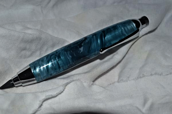

First back painted blank , also painted the brass tube , Teal Tempest AA blank from Exotic Blanks . I painted the brass tube and inner hole in blank silver , this blank was pretty translucent once it was turned down , I got good coverage with the acrylic paint and you can't see any glue gaps , used epoxy . Thanks for all the tips folks :smile:
