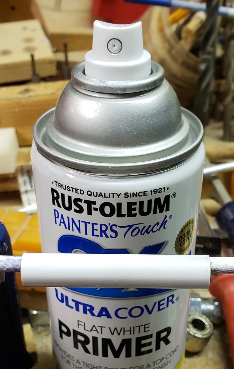

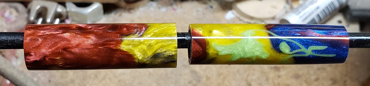

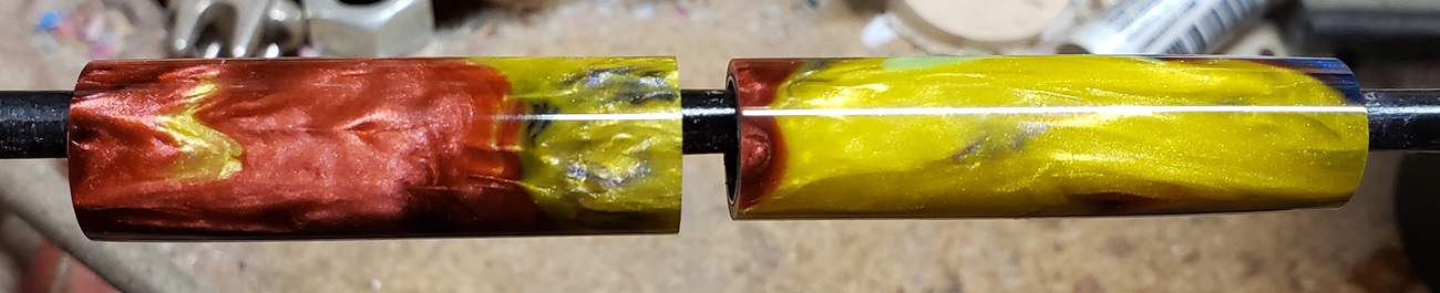

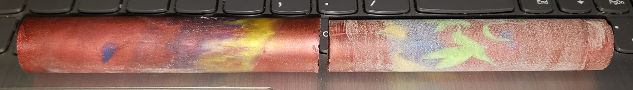

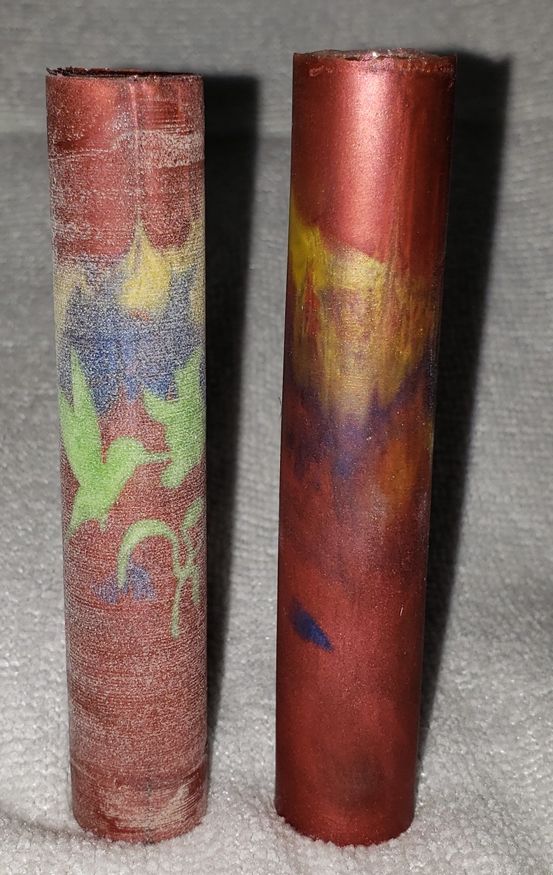

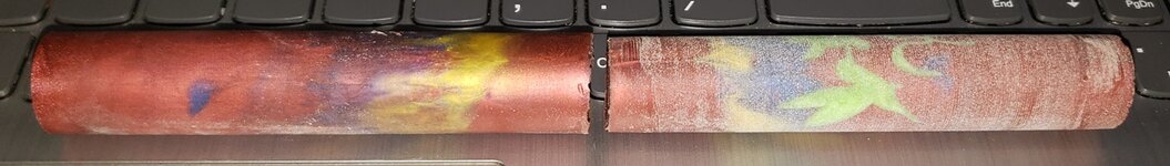

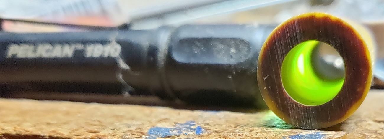

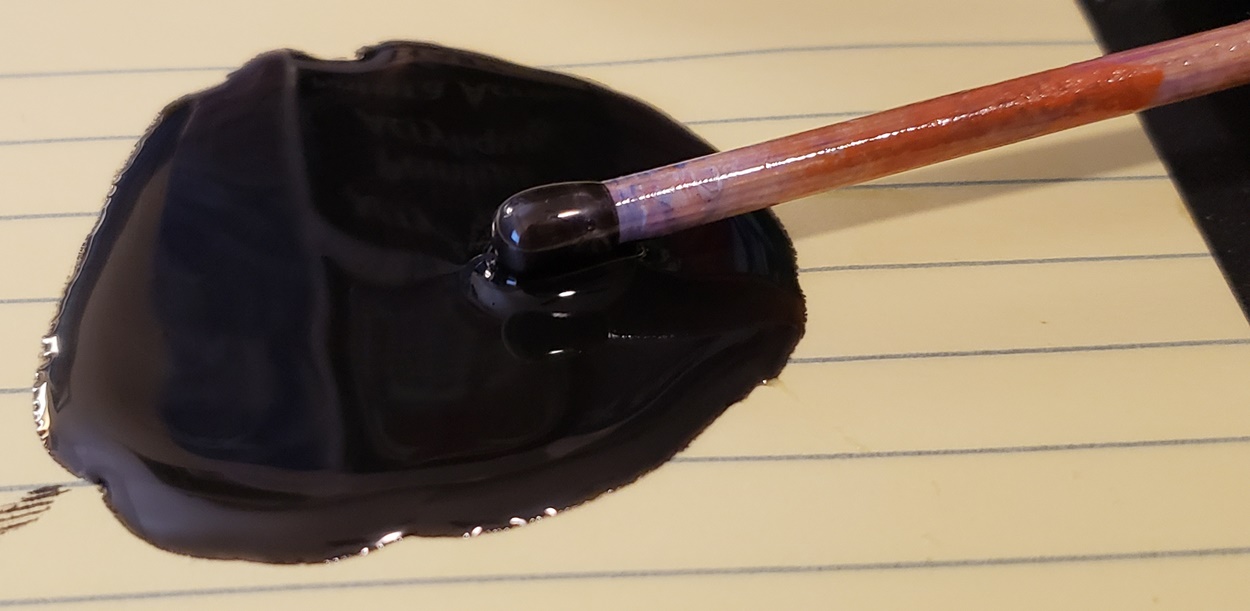

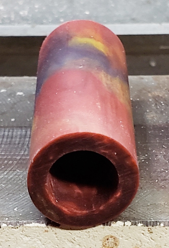

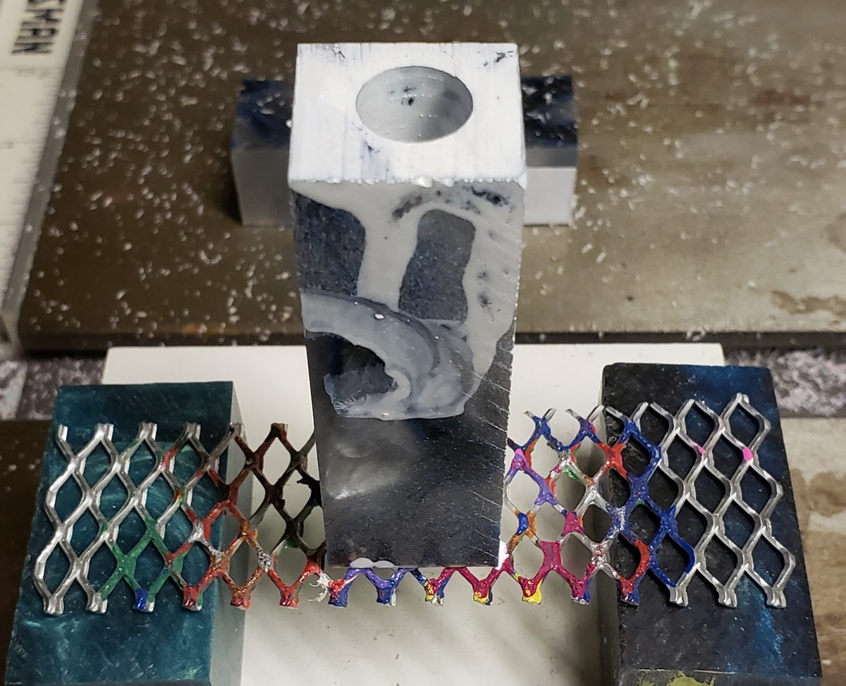

I'm working on a Rotacrylics hummingbird blank. Is back painting necessary? If so, what color? Black?

How thick will the wall be on the finished product? Do you want to brighten the colors? While I have no experience with rotacrylics, I would consider silver or white.
Another thought... isn't it 4 am there? Go back to sleep. 😉
The pen is a Jr. Imperial, which uses the same bushings as the Majestic Jr. The hummingbird will be on the lower body. It's a 10.5mm drill bit, and the OD on the bushing is 0.516". So that leaves a wall thickness of 0.051".
And I start work at 5:30, so I'm always up at 3:30. I've always been an early riser. A lot of my best pens are made before 5. 😴

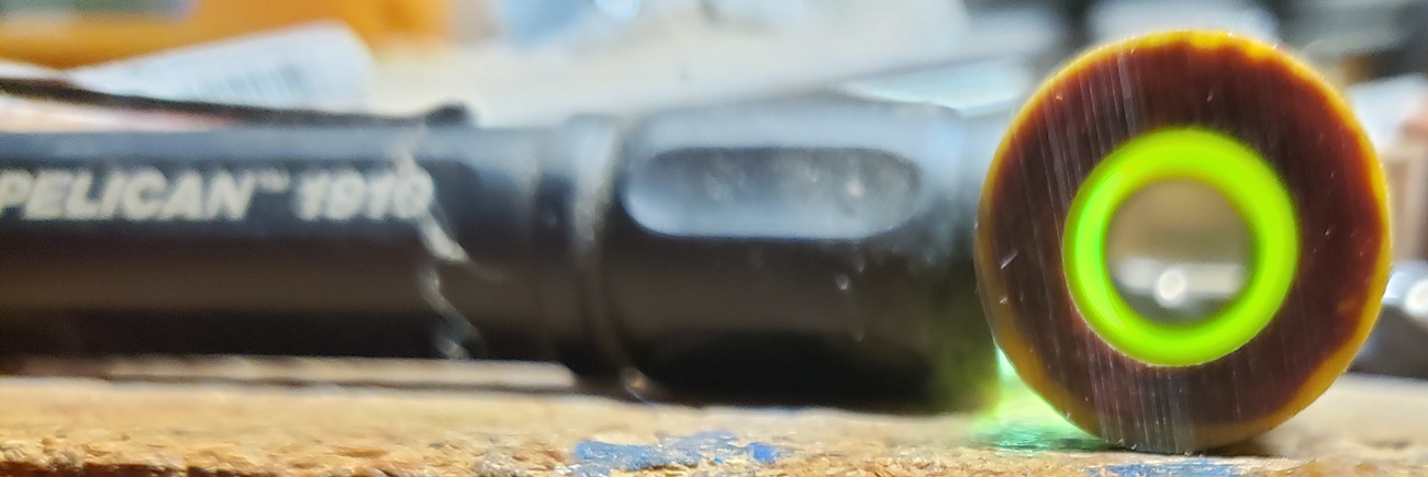

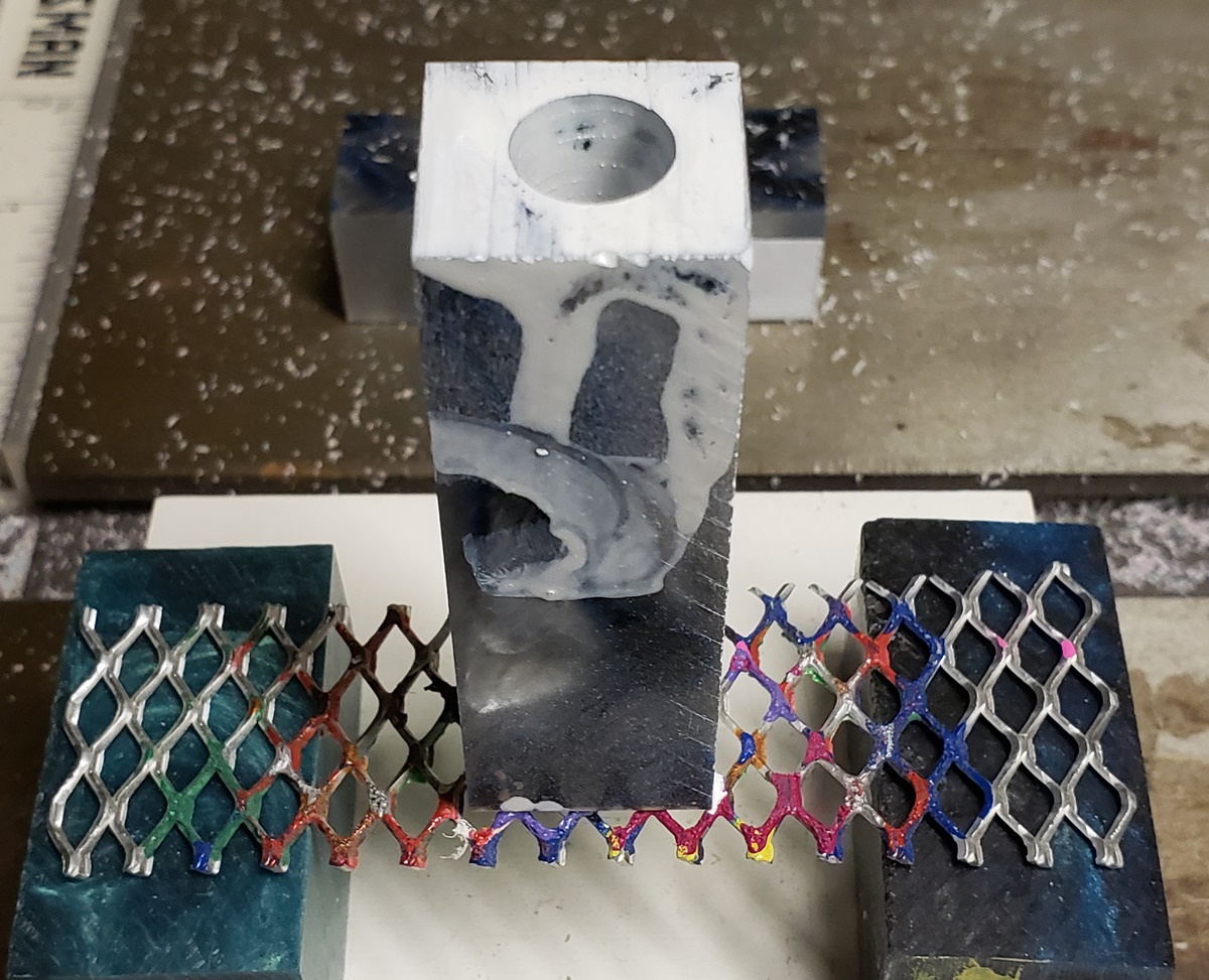

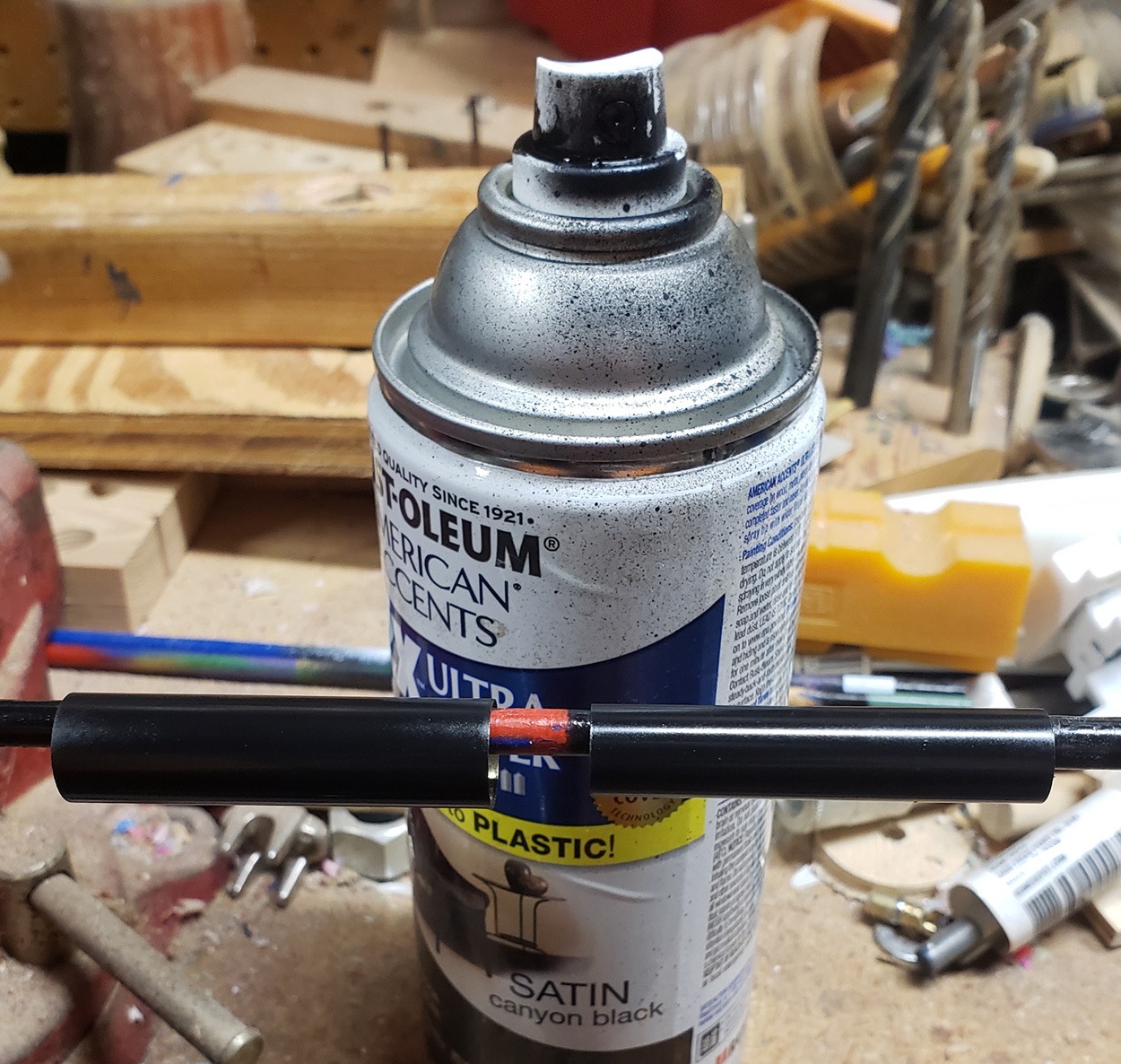

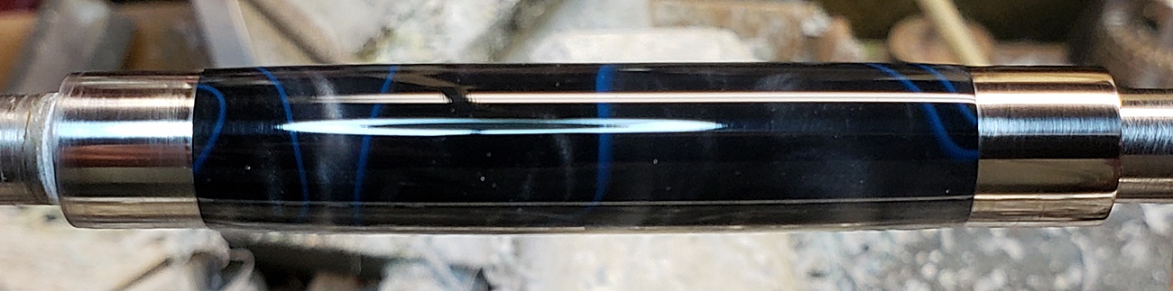

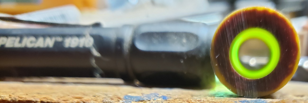

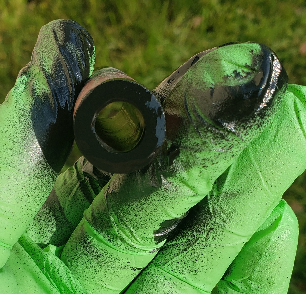

I did watch Ed's video, it was helpful. And I don't really think back painting is necessary, but don't want to take any chances. I've been unpleasantly surprised in the past. I shined a flashlight through it and it does look at least somewhat translucent. I'll probably go with black paint. Usually I choose paint that's the predominant color of the blank. But I'm afraid red paint may make the hummingbird look brown. Todd suggested silver in his post above, which is also a possibility.

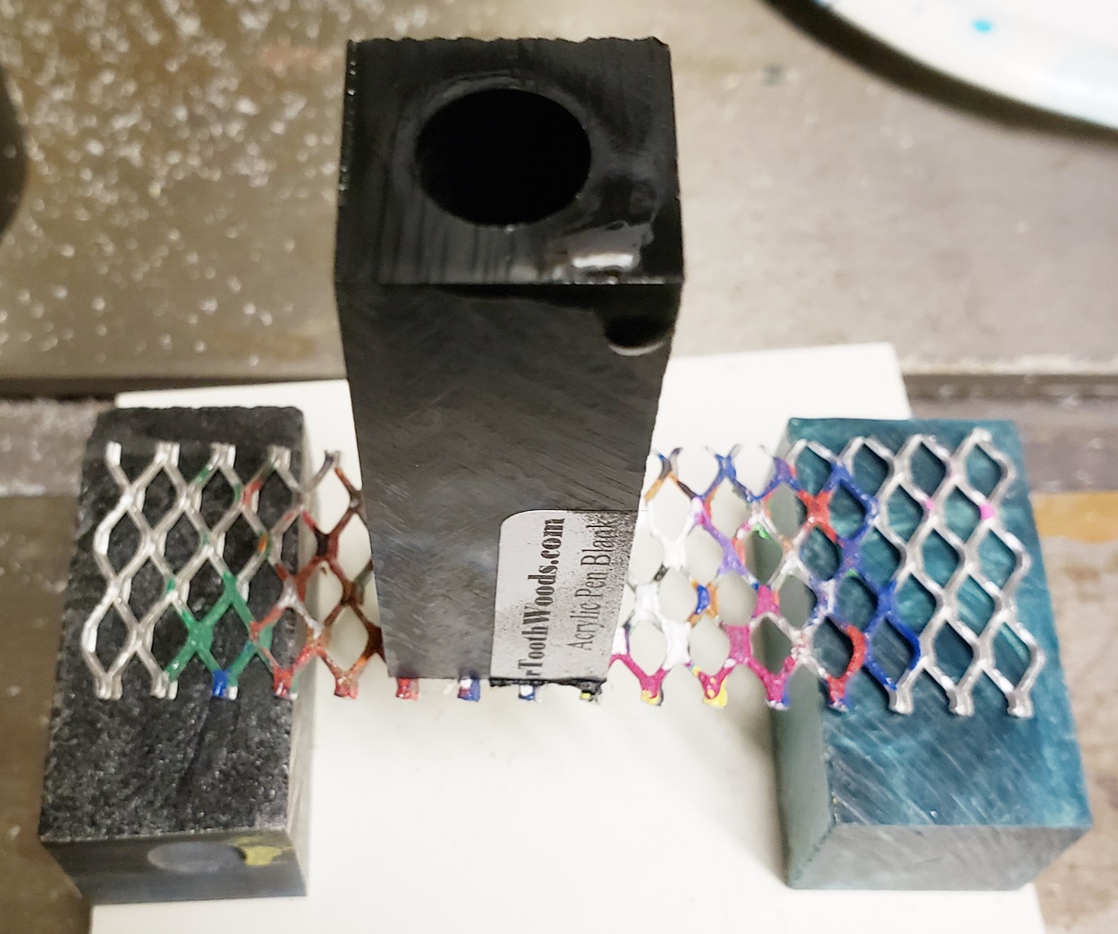

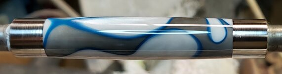

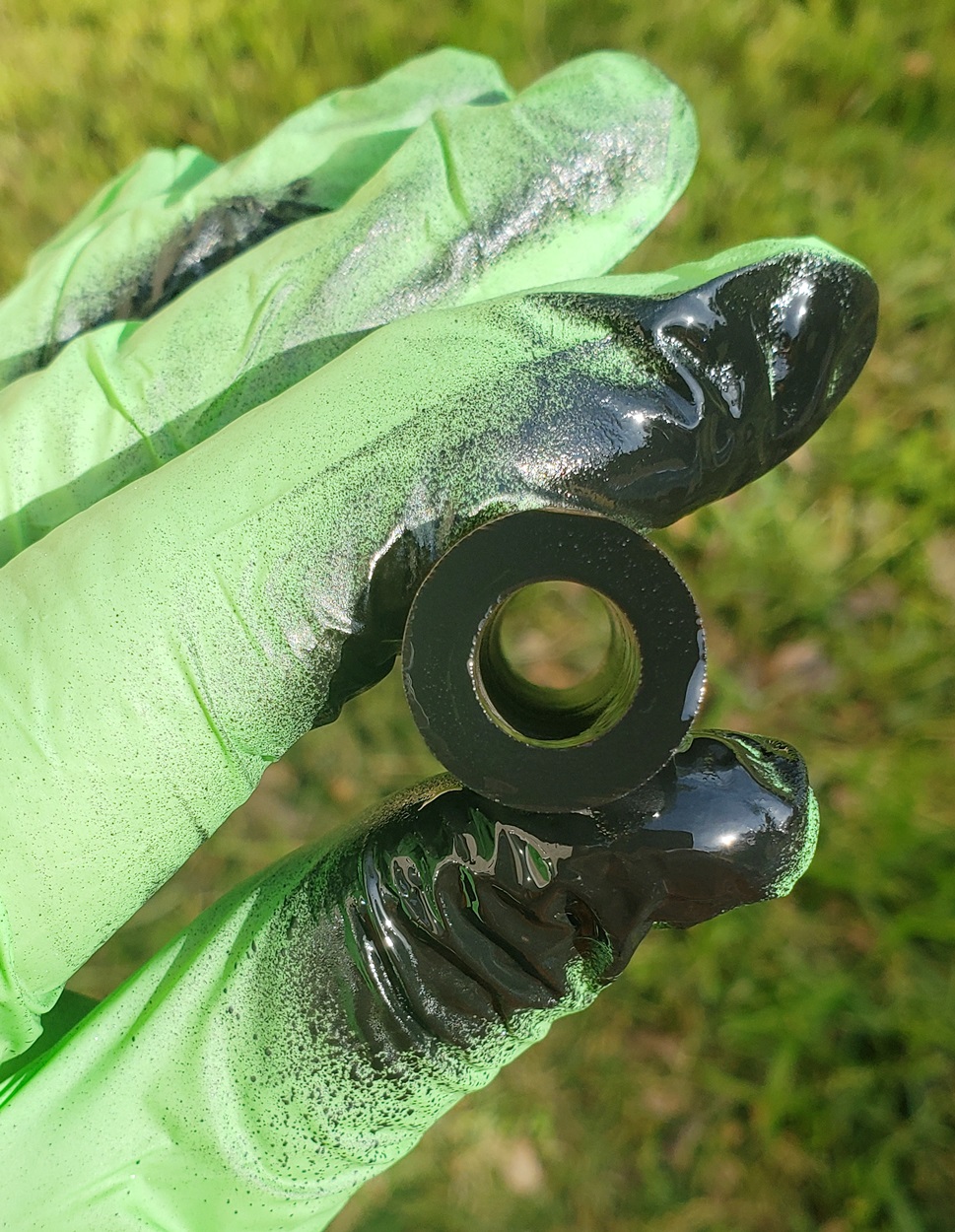

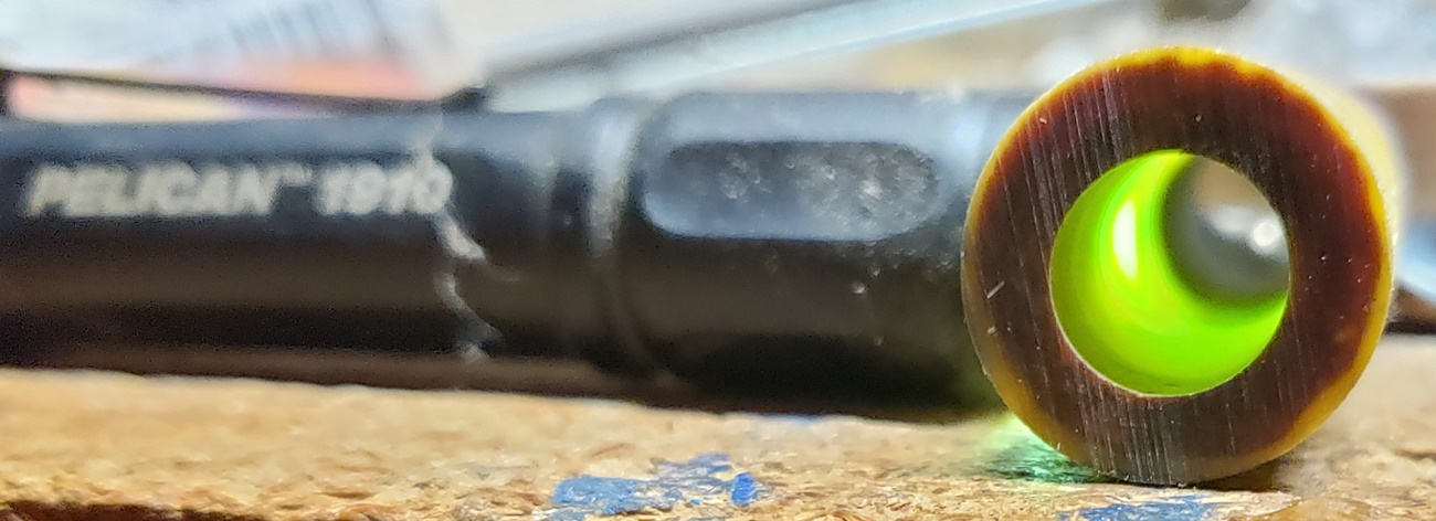

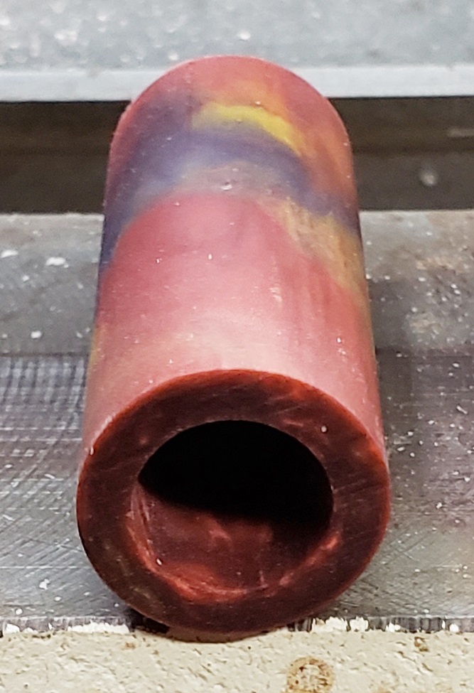

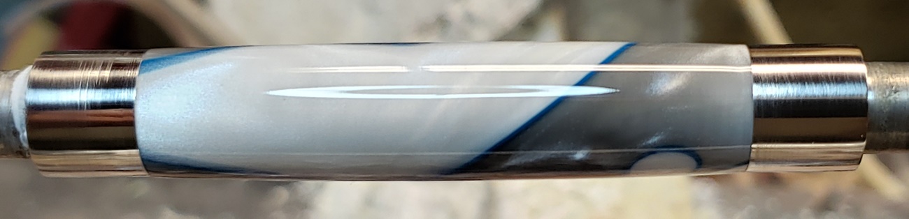

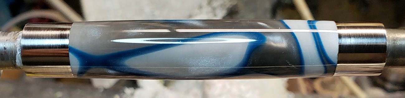

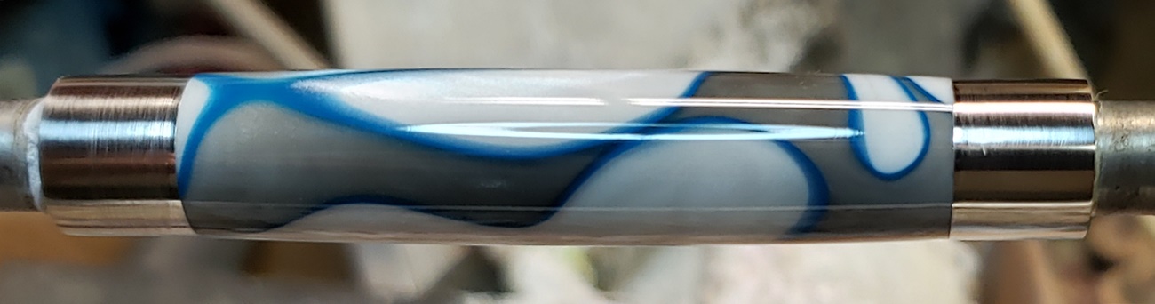

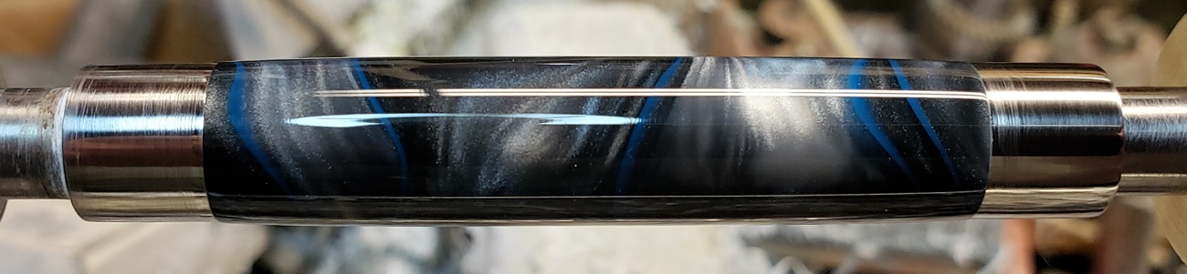

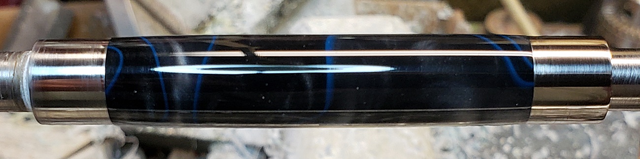

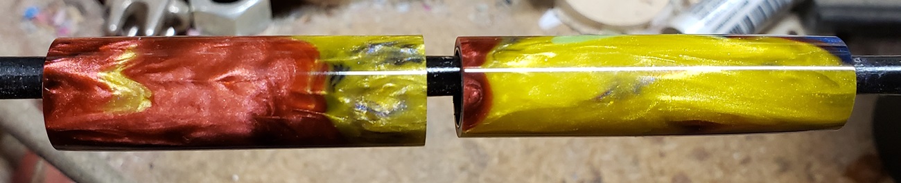

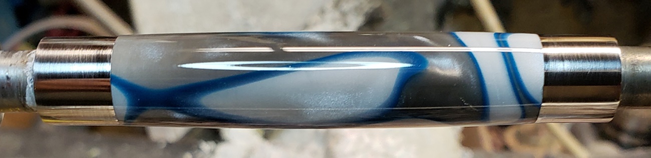

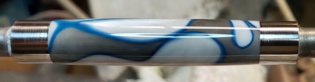

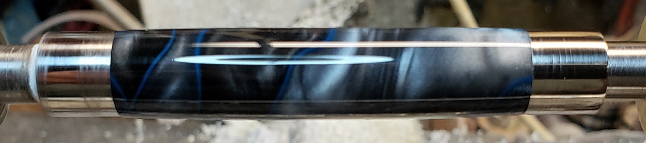

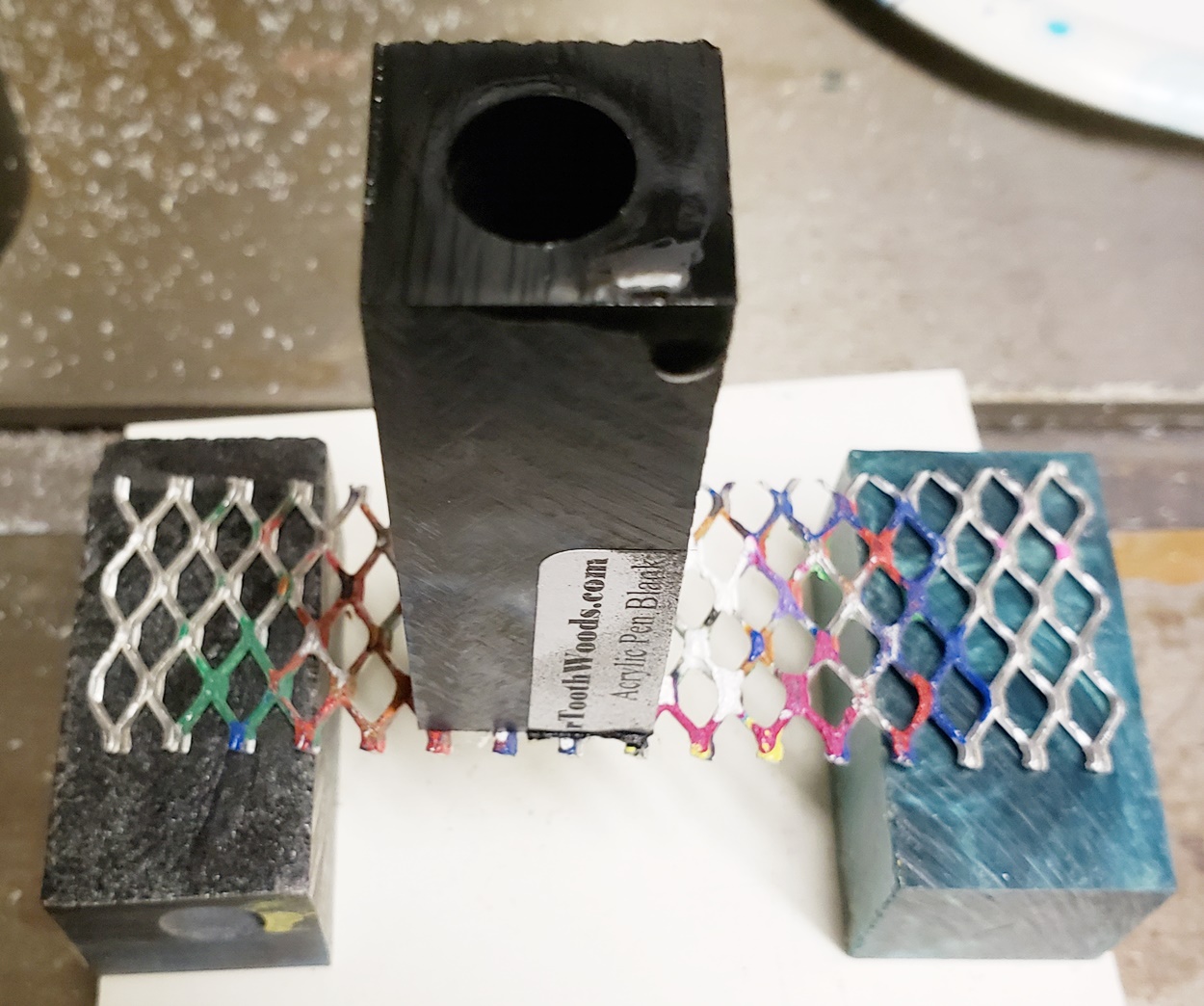

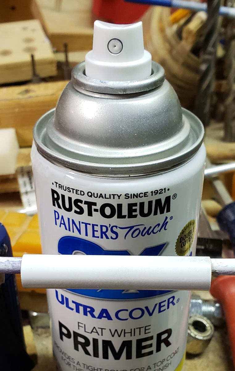

I did an experiment a while back with back painting. Two halves of the exact same blank, one painted white, and the other painted black. Huge difference.

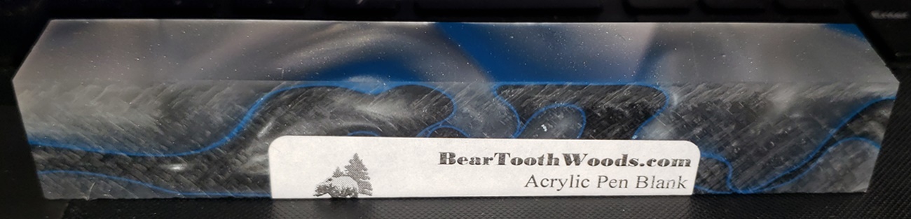

Very good info and pictures on back painting! I haven't got into that... yet. I do have a few blanks that probably should be painted, so I'll get to try it soon. Great blank for your demo! Do most blanks have that dramatic effect, or does it need to have a lot of white in it?

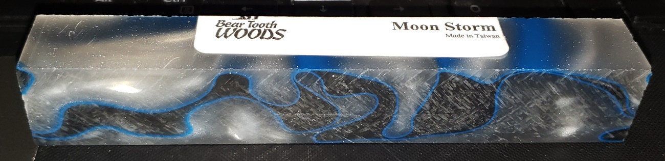

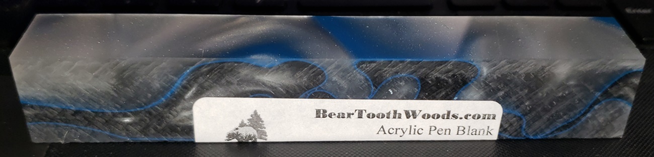

I really like that blank! Where did you get it?

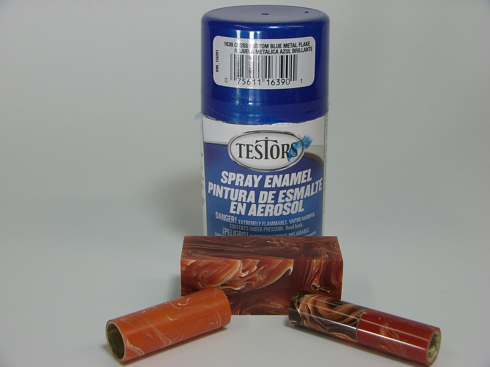

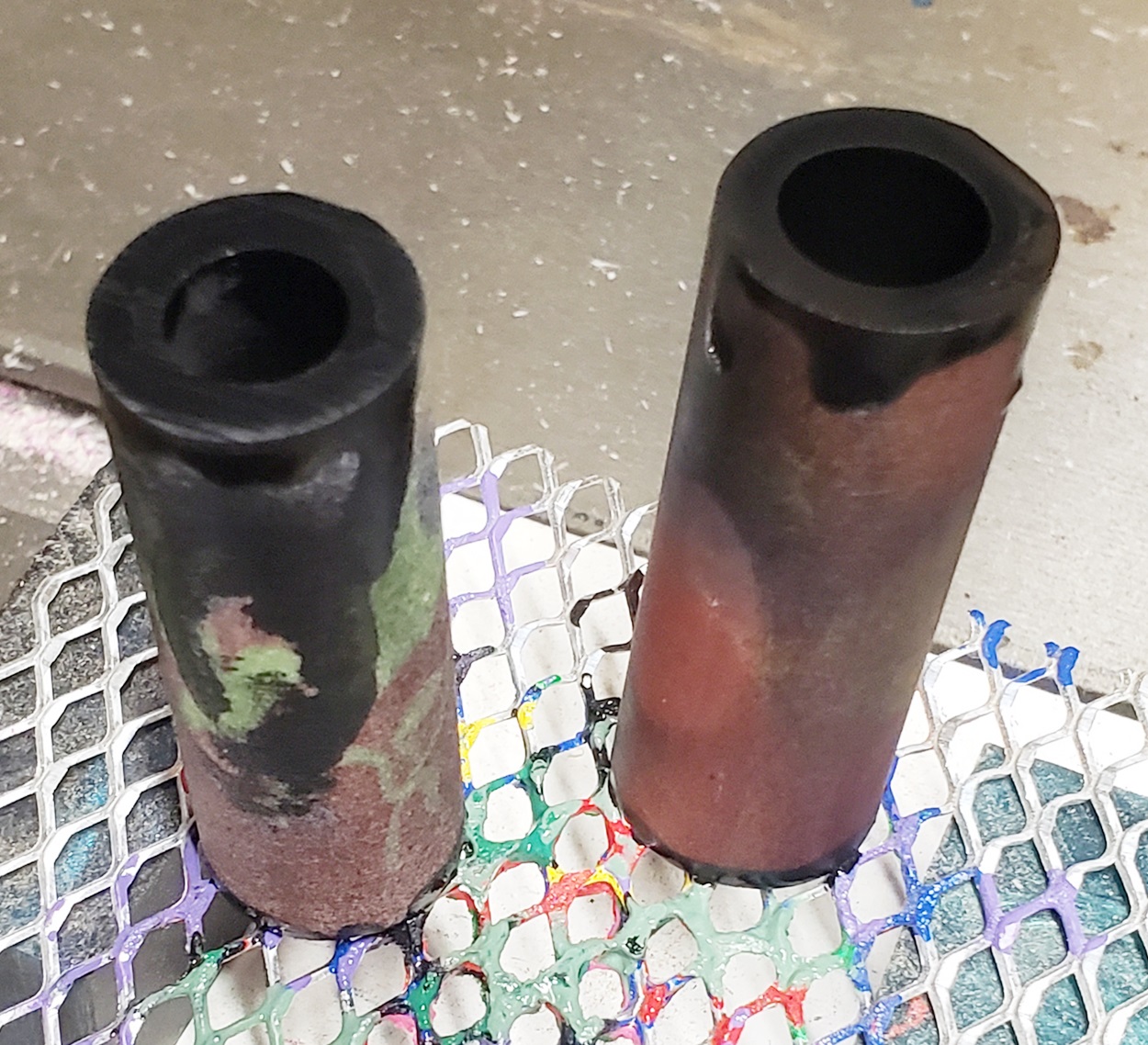

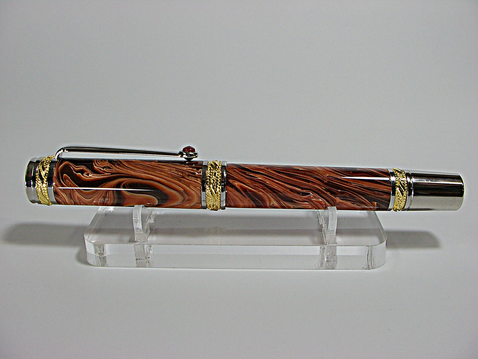

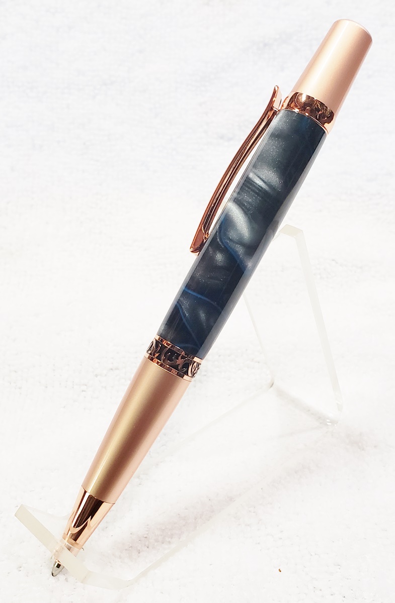

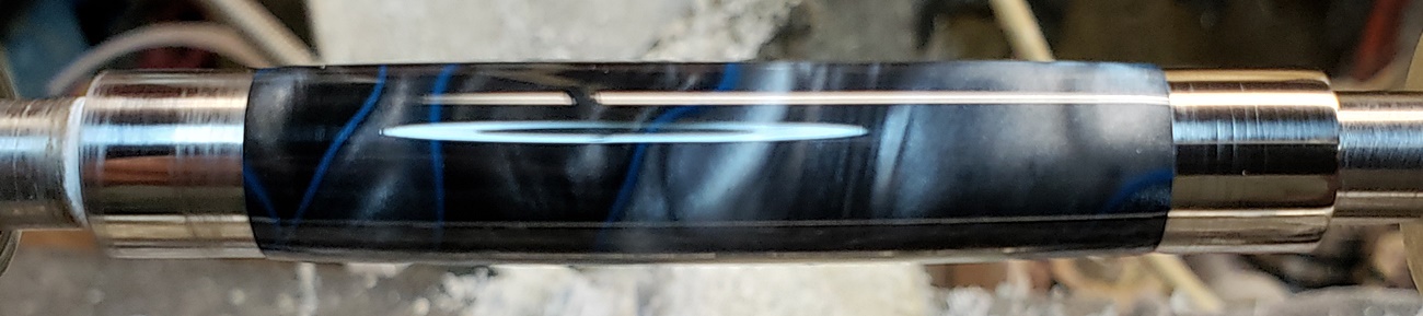

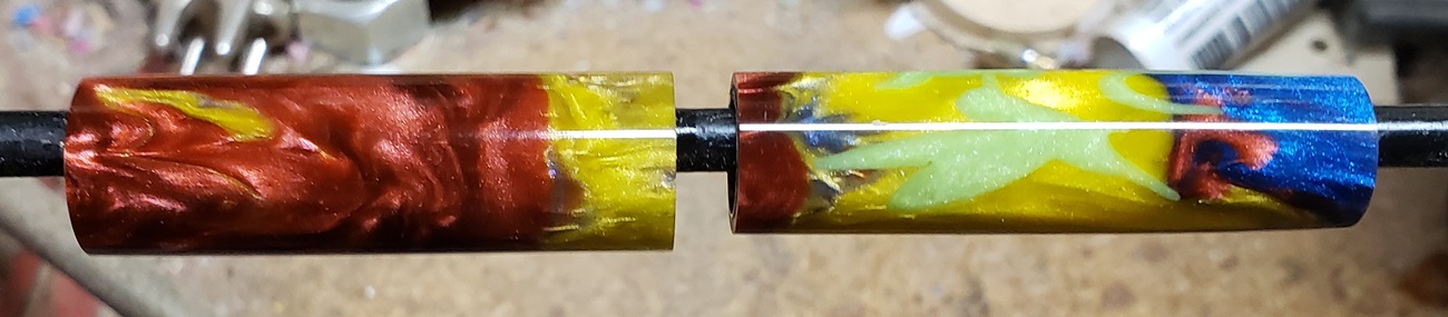

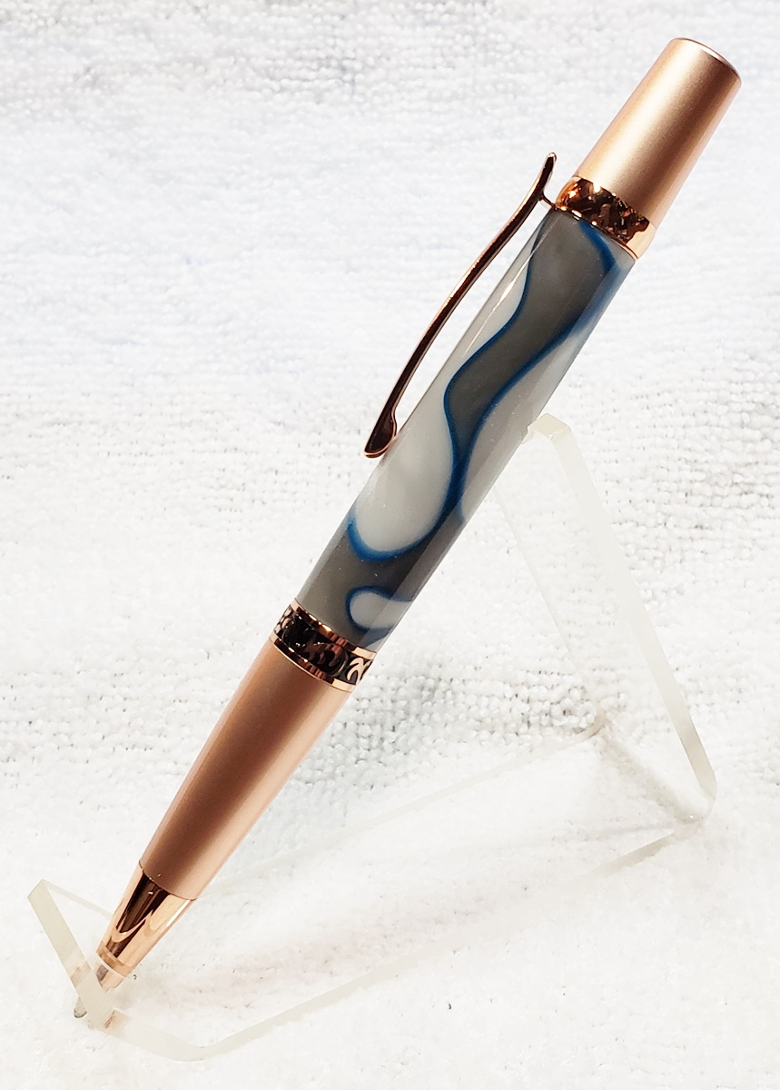

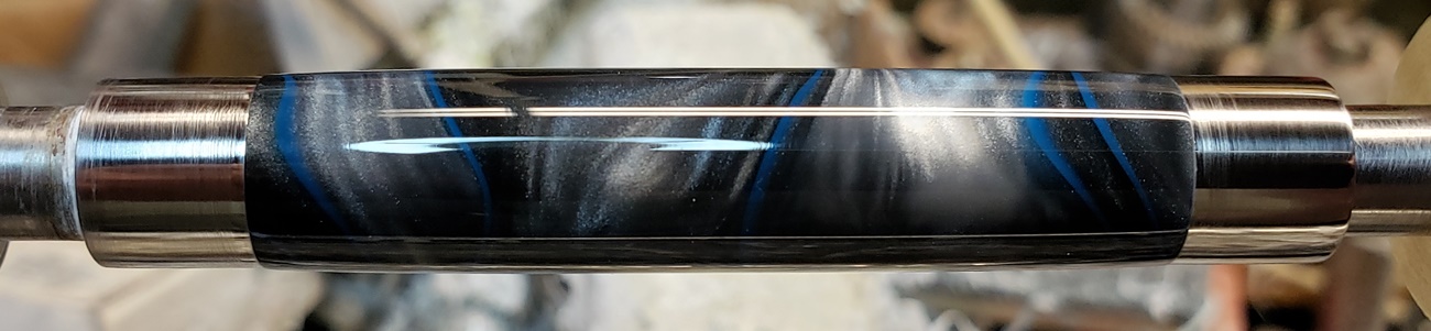

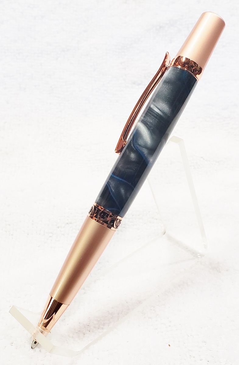

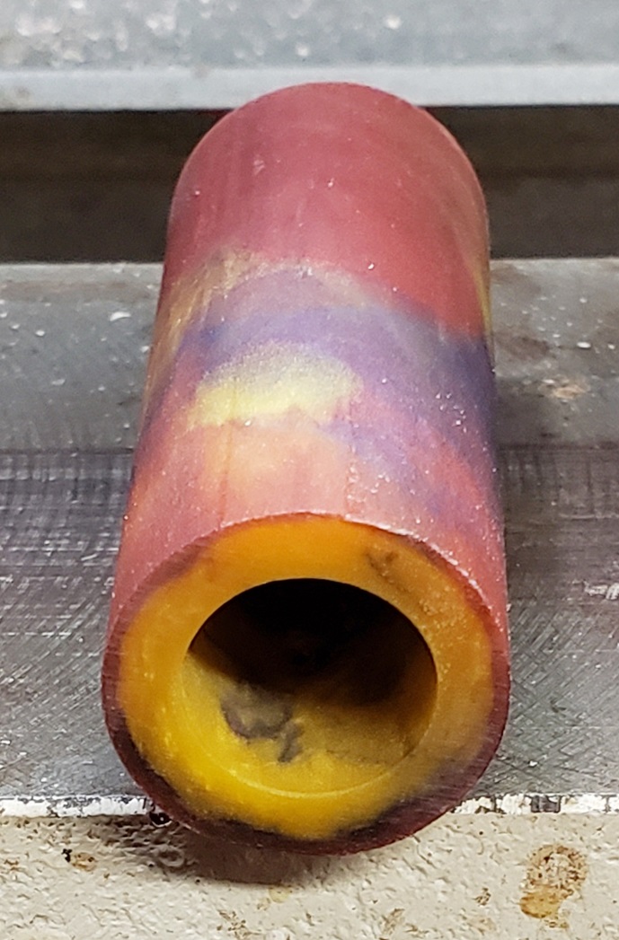

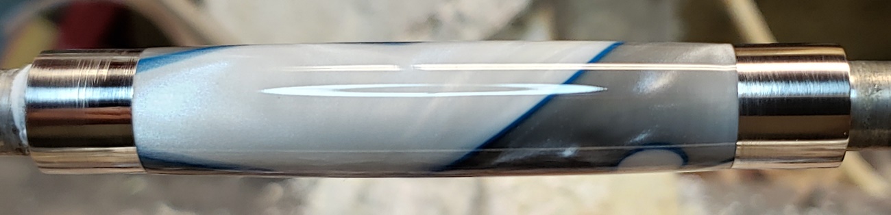

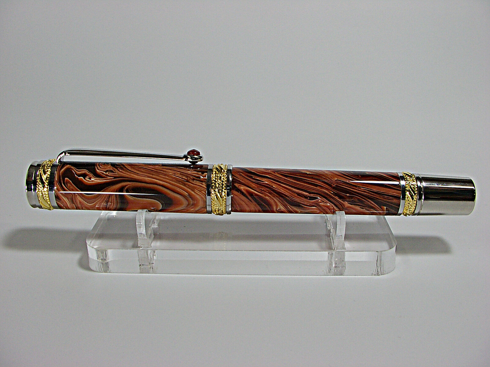

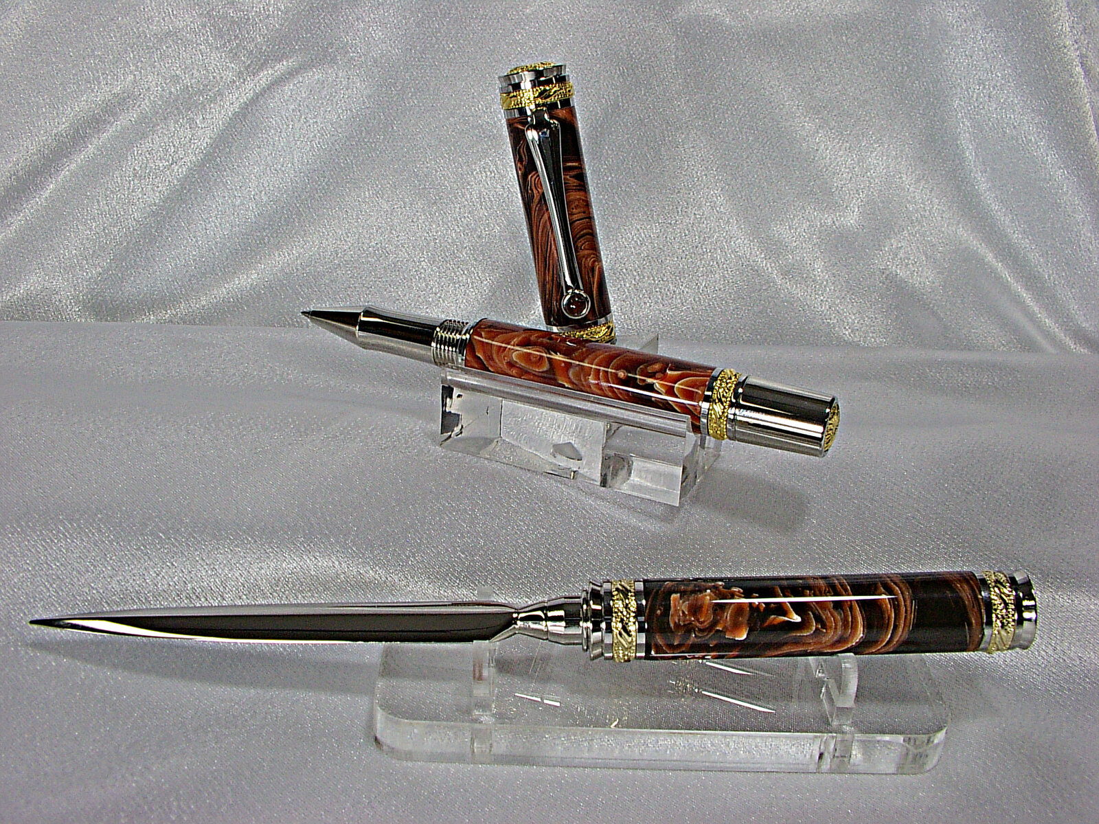

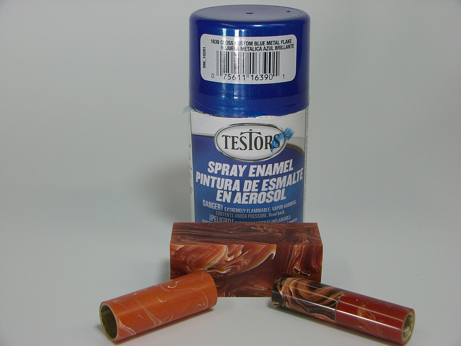

Gary alot depends on the blank and colors used. Most transparent blanks need painting. Using different colors for the painting can drastically change the look. Here is an example of a pen I made. All the same blank the one on the left was back painted with white. The ones on the right, the lower section was painted with a reddish brown and the top one was painted with a metallic blue spray paint and that was the one I went with for the finished pen. The blank in its raw state is in front of can. Have included photo of finished pen also.

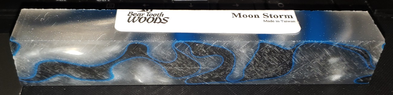

It's called Moon Storm, from Bear Tooth Woods.

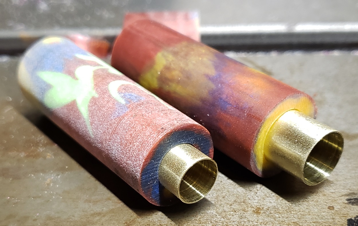

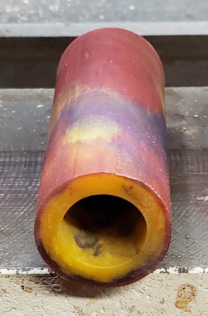

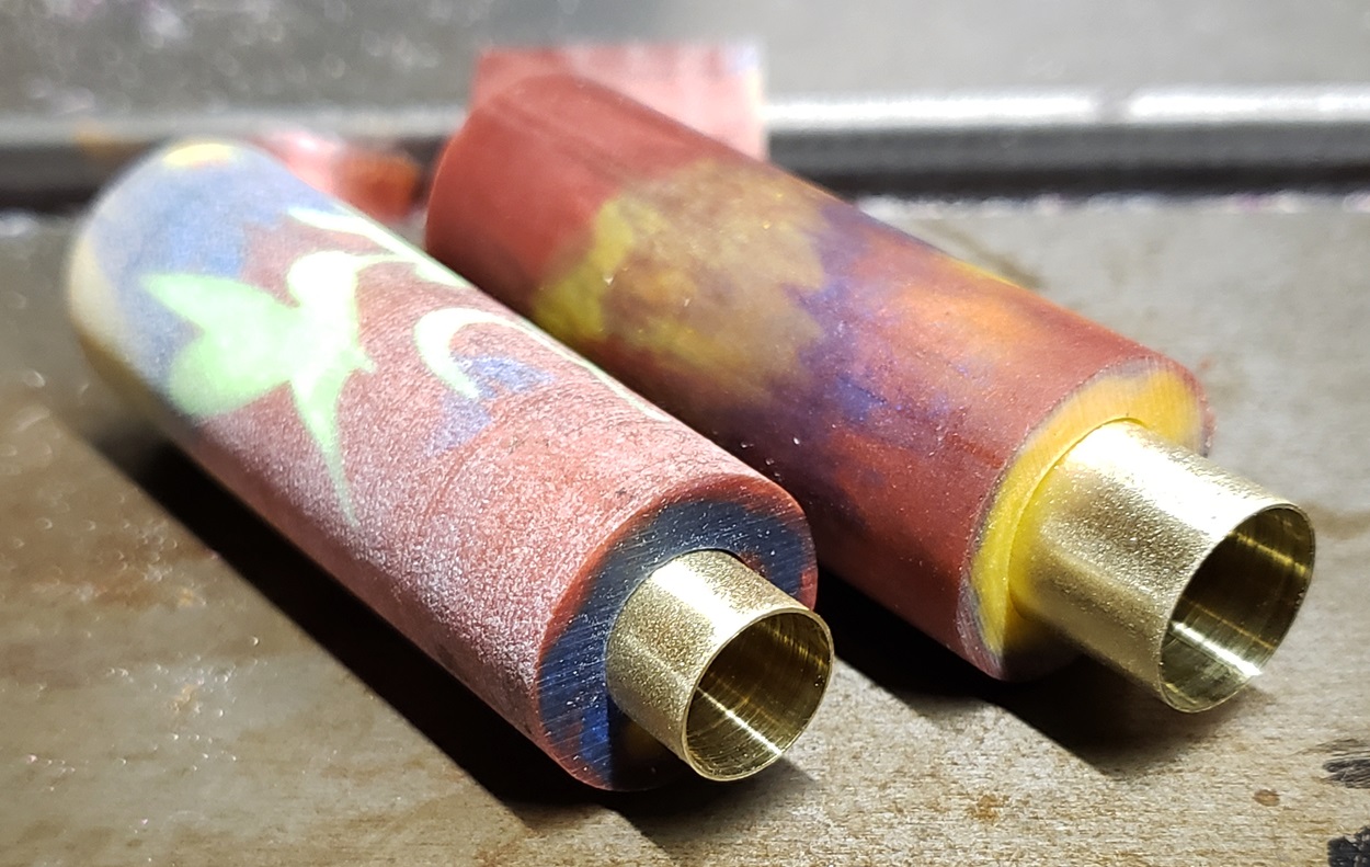

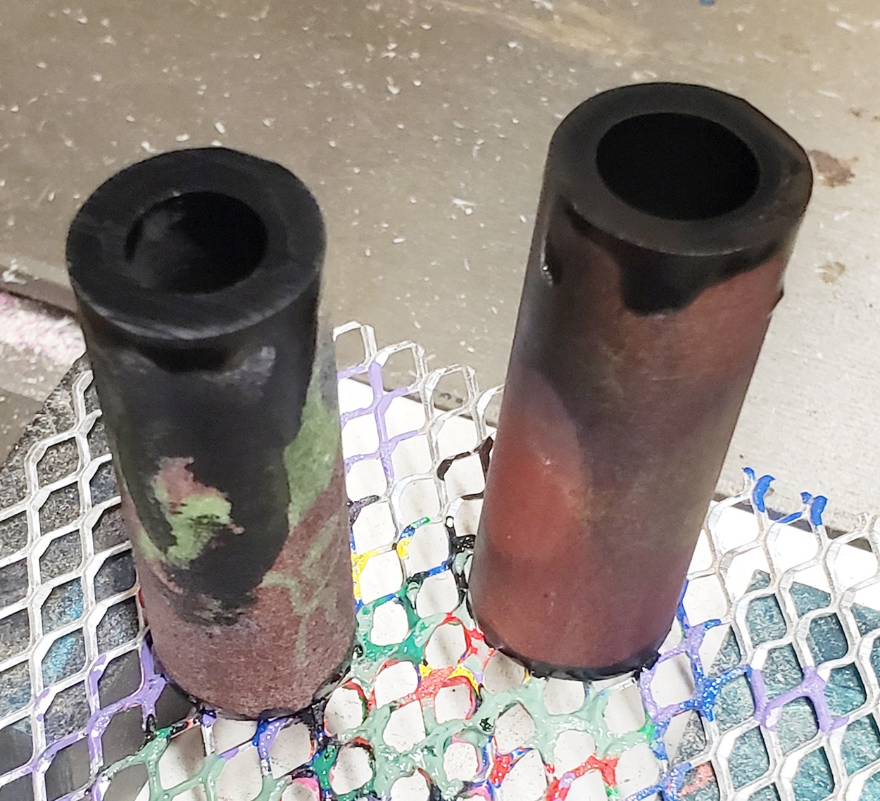

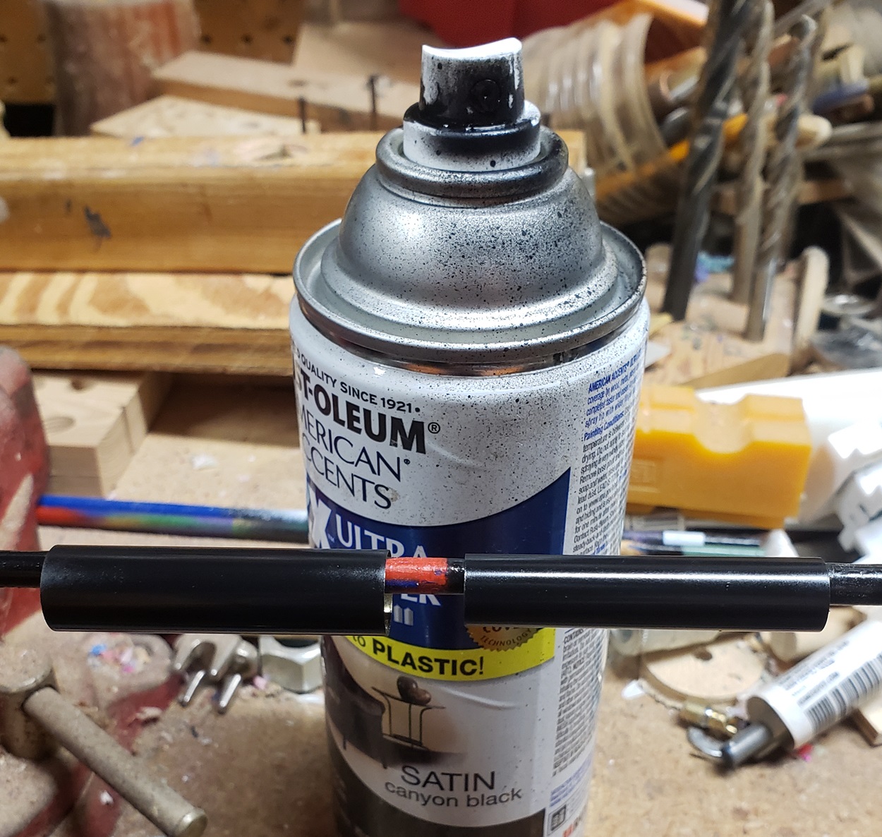

I think I've decided to back paint it with black. If it turns out the material is opaque, it won't matter. But if it's translucent, I'm afraid white would make it look too pale.
Too late to change it now.

Gary alot depends on the blank and colors used. Most transparent blanks need painting. Using different colors for the painting can drastically change the look. Here is an example of a pen I made. All the same blank the one on the left was back painted with white. The ones on the right, the lower section was painted with a reddish brown and the top one was painted with a metallic blue spray paint and that was the one I went with for the finished pen. The blank in its raw state is in front of can. Have included photo of finished pen also. View attachment 326559View attachment 326560 View attachment 326558
That's a beautiful pen, John. I would never have thought to go with such a contrasting color as blue, but the results speak for themselves.

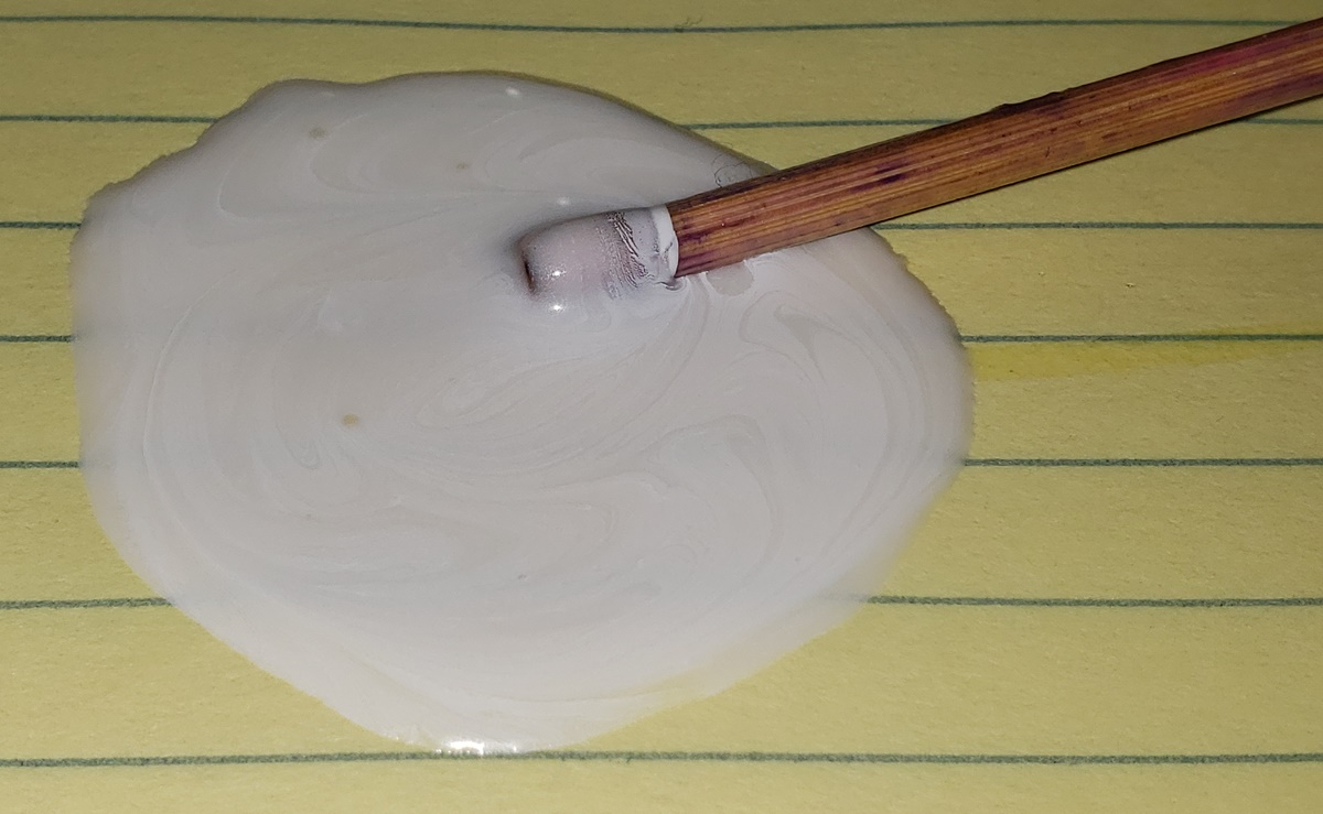

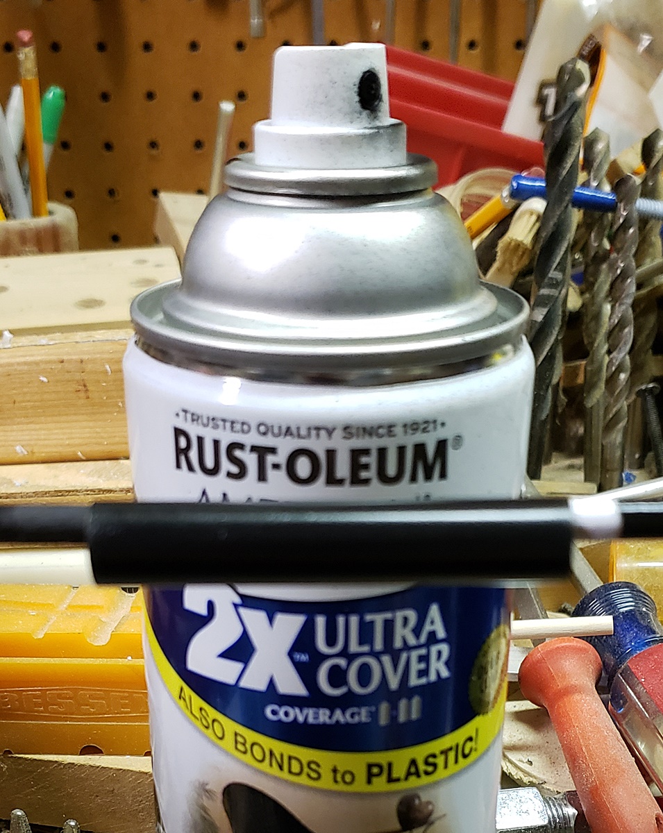

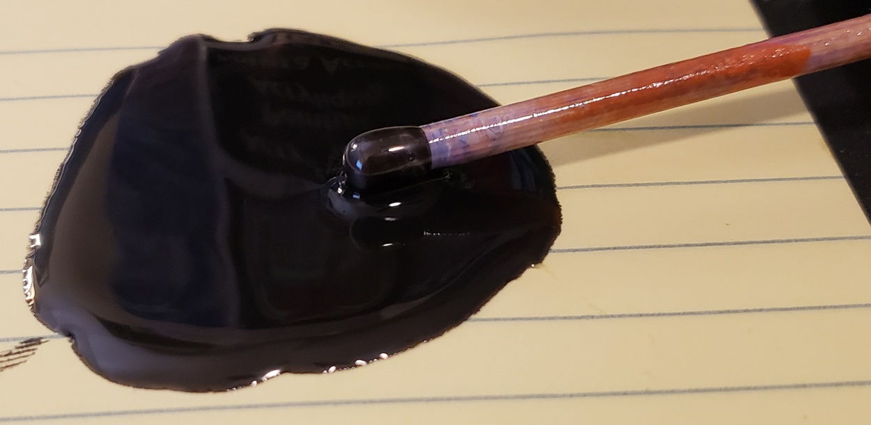

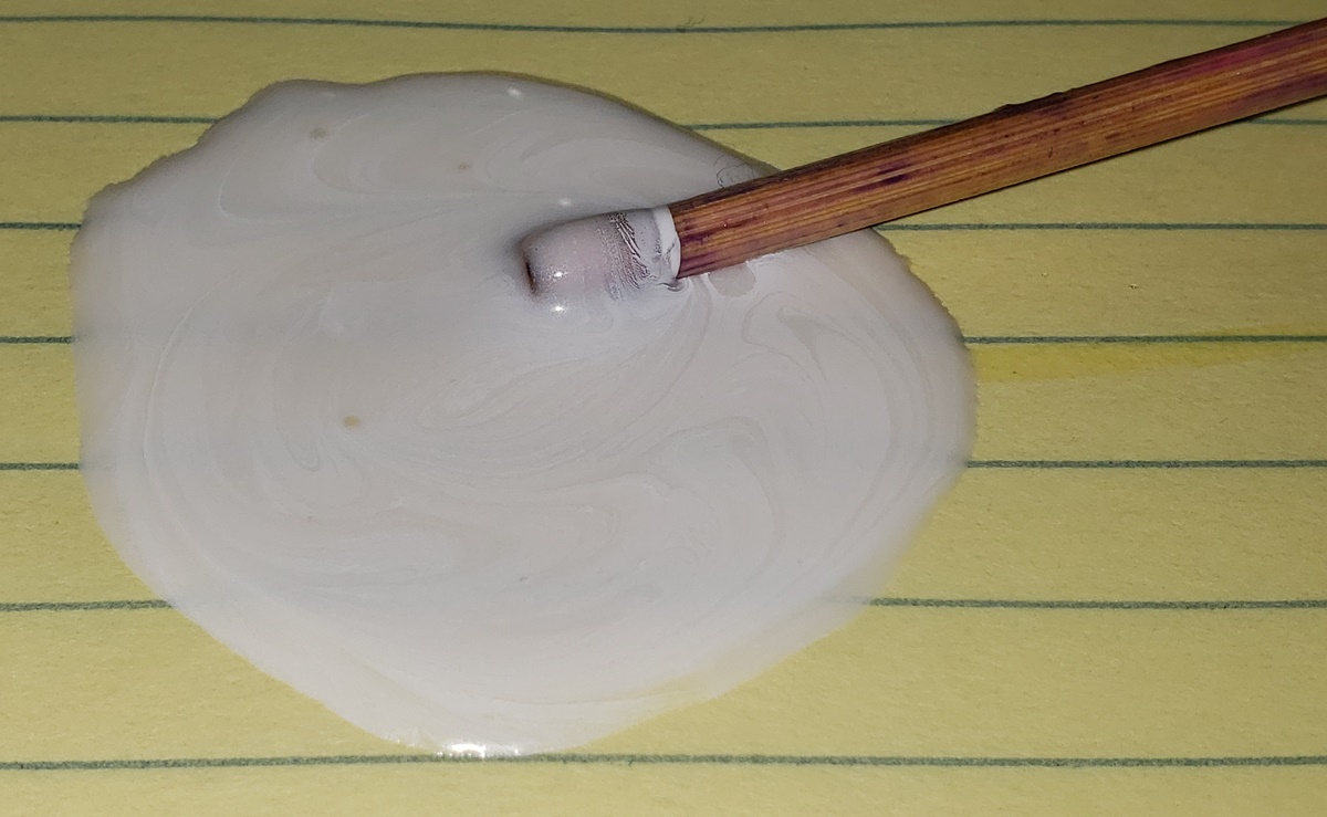

I meant where did you get the hummingbird blank. But looking at the Moon Storm one...I have to get a couple and try that!! Thanks! What is best to paint the inside of the blank...a Q-Tip?? Let dry overnight, or a couple of days? Looks like you colored the epoxy also...just acrylic paint from Walmart?
I need another project like a kick in the butt...but I think it's cool and have to try it!

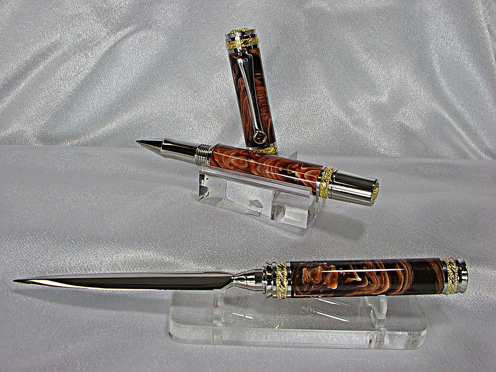

John, that's an awesome pen!!! What is it, Emperor?
I would NEVER have thought the white and blue painted came off the same original blank. Learning how to do this will add a whole different level to my pens!

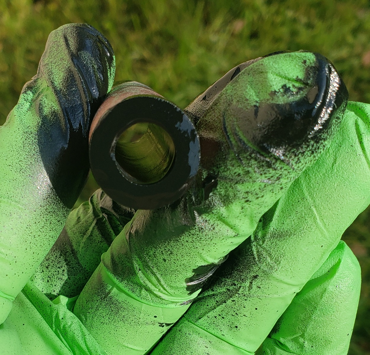

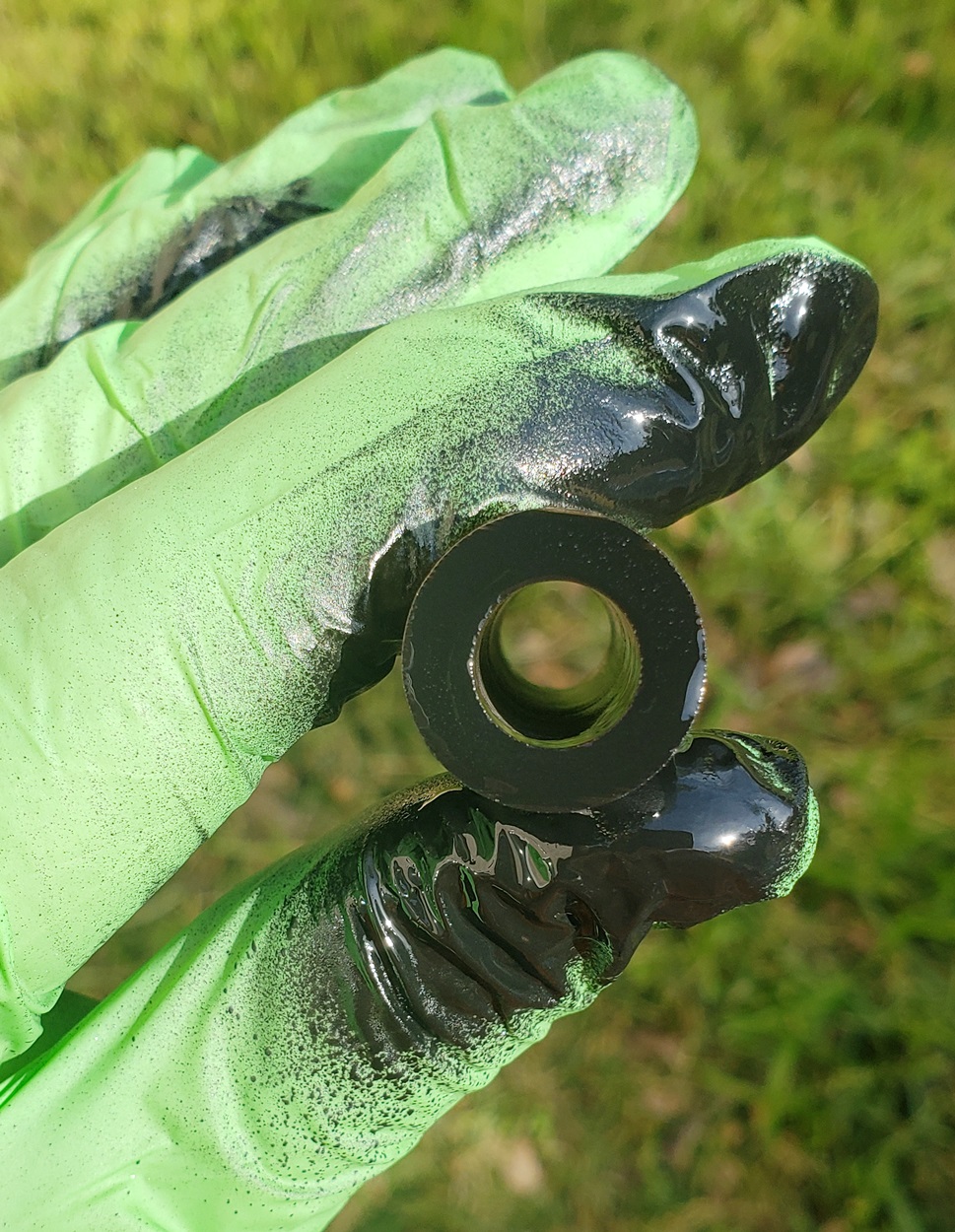

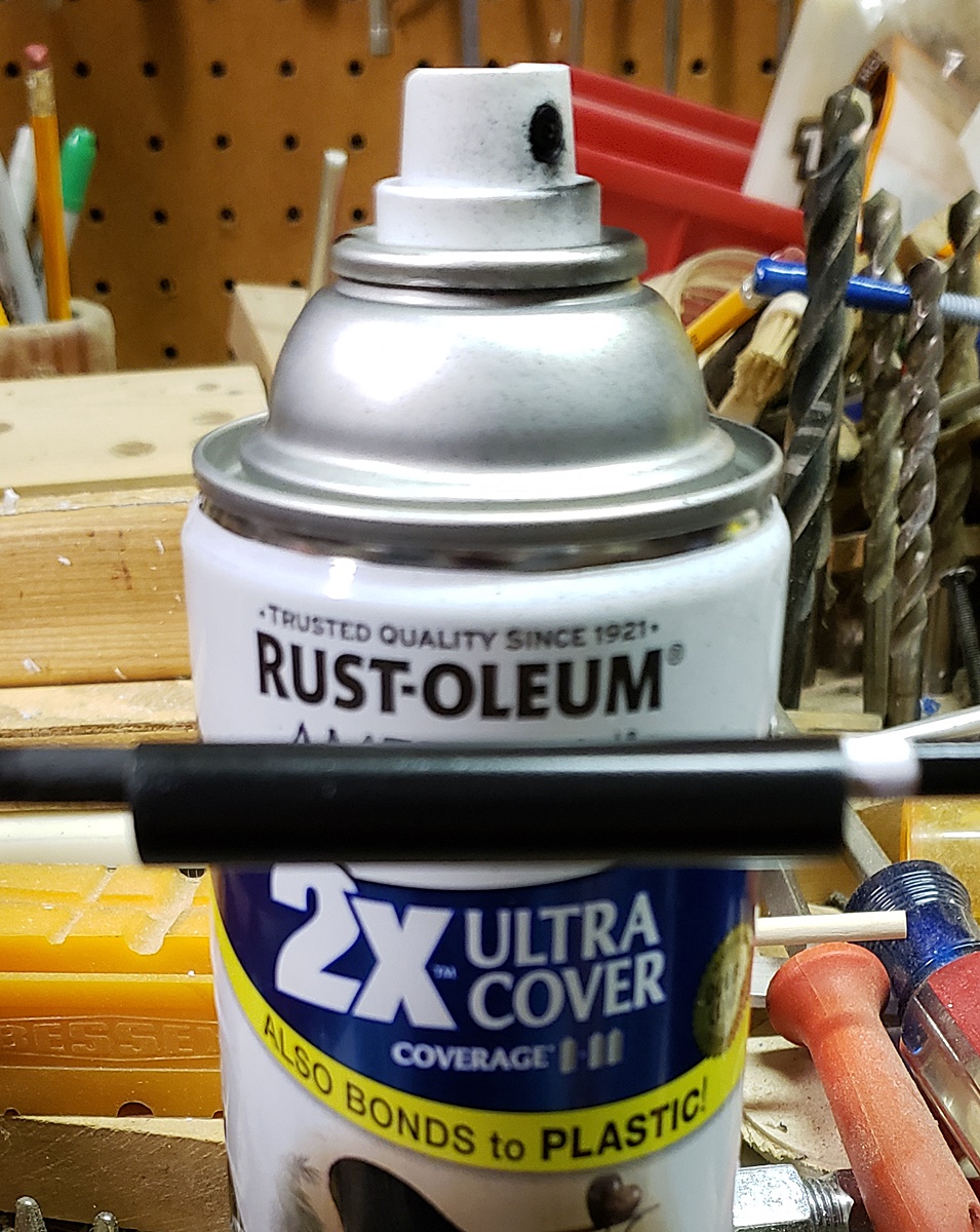

I got it from Exotic Blanks. I use enamel spray paint for the bores and tubes, and cheap acrylic paint from Walmart (good guess!) to color the epoxy.

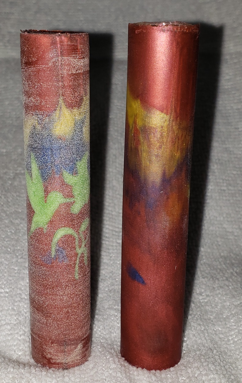

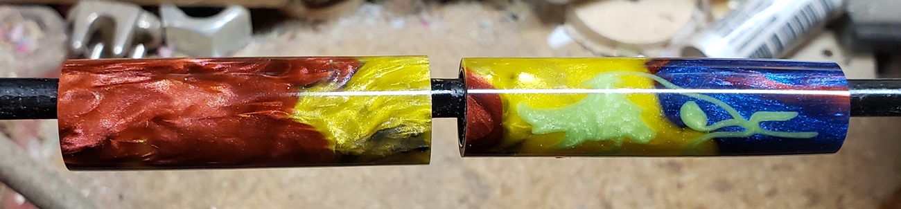

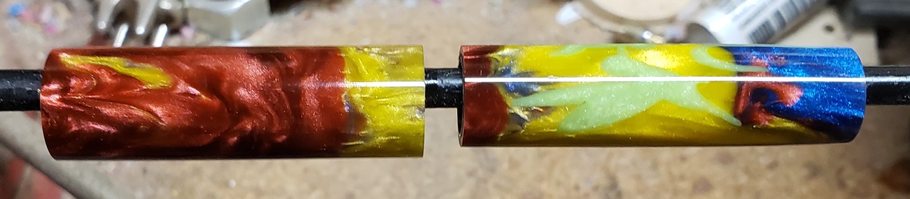

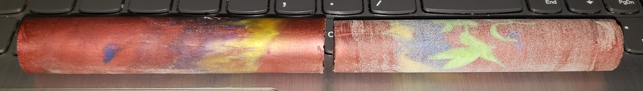

I'm not 100% certain that back painting was necessary. But there are a few black spots that might be the paint showing through. I think with such expensive blanks, it's best not to take chances. If I ever turn another Rotacrylic, I will definitely back paint it.
Thank you. Yes there were drastic color shifts with each color for sure. I thought the white just washed the blank out. The brown/red made it look muddy and the blue just popped it.
Thank you. The pen is a full sized Majestic rollerball. The letter opener is the matching set to the pen. I took the clear crystal out of the clip and replaced with one made from the same material as the blank. I do that on occasion.
