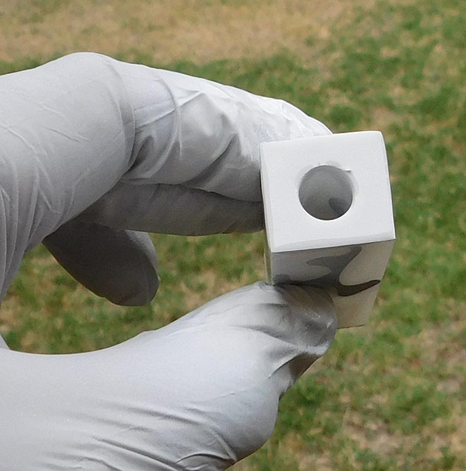

I'm curious as to how everyone "back" paints tanslucent acrylic blanks. Do you use spray paint, or do you use bottle paint with a brush or cotton swab? Or perhaps some other method? I use spray paint, but have trouble covering the entire inside of the hole, especially with smaller diameters.
