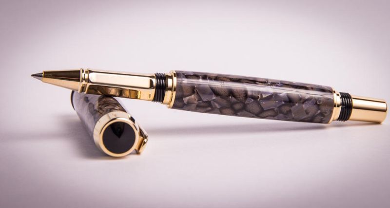

I used to be here under a different handle (don't even remember what it was now), and just wanted to share some of what I've been up to.
I'm not sure what I used for a blank on the gold baron, I don't believe it was an instaview blank, but if anybody has an idea, I'd love to know.

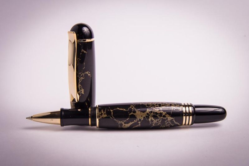

The Black TN baron is Santine, and has some really nice movement in the wood.

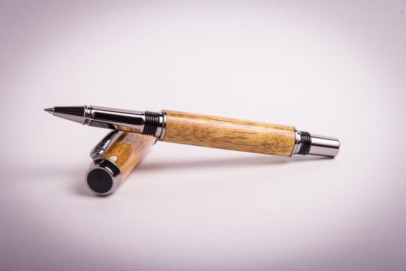

THe Churchhill is Black w/Gold matrix TruStone. I LOVE how it looks, but it's the slowest thing to turn I've ever worked with. Lots of trips to the grinder to touch up the edge.

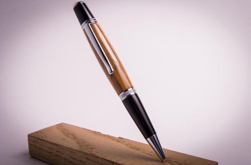

The Sierra is Olivewood.
Finish on the acrylic types, wet sand through 12000 MM, polish and a final coat of ren wax.
The Woods get dry sanded through 12000 MM, 15-20 very thin coats thin CA with accelerator spray. (I've had very mixed luck with BLO, this always works for me), let cure 24-48 hours, then finish out just like the acrylics. Sometimes they need to get started with 400 wet and 600 wet to get any bumps out.
Nothing done to retouch them, only changes from the original shots are just crop and add the shading around the edges of the image.
