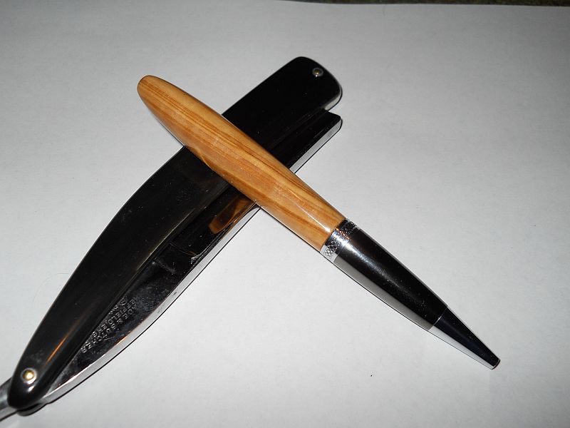

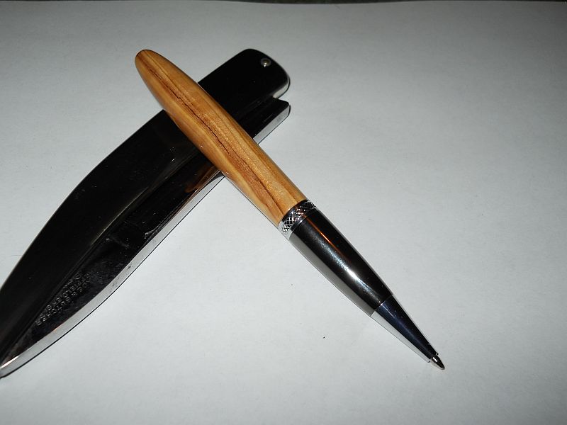

The other day I was looking at the end cap i made for a jr.gent and wondered if I could do a closed end like some of you do.Well I had left was a chrome/gunmetal classica.Shouldn't be too hard to do I only need a way to secure the transmission.5/16ths brass tubing made a tight press fit, much better than the endcap assembly.Drilled 3' deep with a 5/16" bit,pressed in a 1" length piece of tubing.Then redrilled it with a 27/64" bit for the body tube.Split the blank,damnit,oh wellI guess i get to try my hand at stabilizing a crack.Took care of that with plenty of CA inside and out.Turned,finished,and assembled.What do you think.

tELL ME THE STEPS ON HOW TO secure the transmission i WAS GOING TO DO A CLOSED END SIARRA BUT I DID NOT KNOW HOW TO DO IT WITH OUT THE END CAP TO secure the transmission
