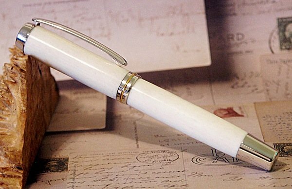

Here is a piece of the Axis Deer I got from RTJW... beautiful stuff..
Kit is a Platinum Jr Gent Rollerball..
blank was sanded to 600 grit then polished with automotive rubbing and then polishing compound, then plastic polish followed by Cellulose sanding sealer buffed with 000000 steel wool cloth and 2 coats of TSW and Ren wax... real nice glisten almost looks like ivory...

Thanks Ryan... maybe I am too conservative, but I have never been one for embellishing the shapes of the kits, and certain materials just look right nice and plane... on the Jr Gent and Baron the most I might do is give the body a touch of swell.. not much just a bit...

Nice pen as usual Griz! Axis is my favorite antler to turn. I too am not a big fan of the "curvy" profiles and beads and coves, but those that do them do a nice job also. Its our diversity that makes this group unique.

A very elegant pen Tom, I love when antler can be turned white like that, giving it the ivory look. I can take antlers both ways, white or with the natural rough showing, both have their own individual qualities. That's a sharp one.

Well, I'm here to learn. What is "Axis" antler?
Clearly, Griz, it (along with a great penturner) makes a beautiful pen, but does it have the cracking problems I have experienced with deer antler? And, when you turn it, does it smell like having your teeth drilled (those of you who are too young to have been to a dentist before the water squirts out of the drill, it used to get hot and smell-a memory I'd like to forget)?

Now for what you really wanted to know... the antler of the axis deer is almost all ivory.. virtually no pith at all.. it turns like a hard acrylic and did not have any smell whatsoever... it also finished like a dream.. no CA needed at all.. after final sizing using the skew in a scaping manner, I polished with automotive rubbing compound, cleaned with a damp rag and then used automotive polishing compound, cleaned again and then plastic polish on a damp rag... finally some cellulose sanding sealer buffed out smooth and TSW and Ren wax... I will buy more of this when Johnny has it available.. I have 2 left, one is big enough for a El Grande Elite kit I have the other will do another Jr Gent or Baron I think...

I think it looks great, and I know I might get killed for saying it but I think is most (not all) cases less is more when it comes to pen design. Not as fun to make but I personally think it looks better.

Since signing up here 6 or so months ago, I've probably looked at a thousand pen pictures or more. Tom, that pen is certainly a top 10, probably a top 5, and if I could see some of the top pens side by side, yours would have a strong shot at Best of Show!!
Outstanding job!!
