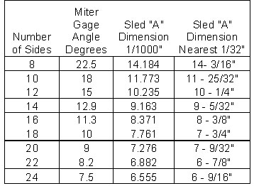

After going to the website and looking at Figure 5, you have an opportunity for improvement in the sled. Measurement C which he has fixed in the calculations at 3" actually varies as you move the sled fence up and down to change Measurement A. Thus the calculations are wrong and get very complex to correct if you use his measurement points. However if you change the measurement reference points the calculations are easier and you can use the plywood you brought.
I would suggest the following changes:
(Side "A" left side of Website diagram, Leading edge is top of Website diagram)
  • Center the Right-hand runner precisely 27.00" from Side "A".
  • Precisely place the pivot hole such that it is centered on the Right-hand runner and the edge of the sled fence is 3.00" from the leading edge.
Now using the Excel spreadsheet referenced in Fig. 5 of the website and plugging 27" in for "B" you get the following table
Hopefully these changes make sense.

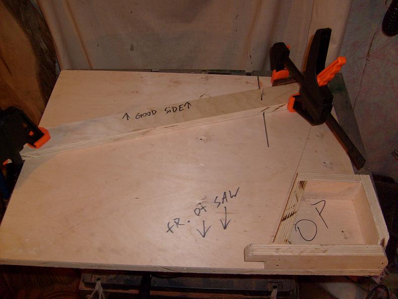

well here is my starter version. Equipped with a little box built right on the top, with a built in push block as well. When i eventually saw through the fence like i know i will, I am going to move it back more toward the "box" a few inches. I am also going to add a couple of those little quick release clamp thingies to hold the material while i cut. I also think i am going to get some keystock to use as the runners. I think that would offer a much more accurate fit.
