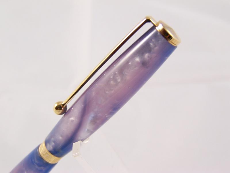

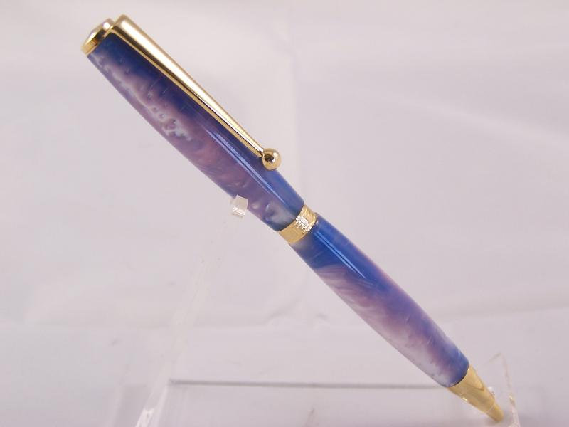

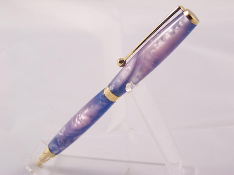

This is a 3 dollar blank from psi that i painted reverse painted blue with spray paint. Put it on a WC slimline from a long time ago that i never got around to using. http://www.pennstateind.com/store/WXMP09.html
I thought it was pretty cool, i plan on getting more!

I have a silly question. When you say reverse painted, do you mean you painted the inside of the blank after drilling? If so, is that preferable to painting the tubes?
Thanks,
Chris
crabcreekind
Feb 16, 2011
1,412
Eugene, Oregon
Thanks,
Chris
Yes i painted the inside of the blank, sometimes when i paint the tubes it will leave a milky spots when i turn it and it looks crappy.
ToddMR
May 3, 2010
1,715
Columbus, OH
Good job. Did you leave the cb area not turned down snug with the cb on purpose? It looks good either way. I too prefer painting the inside of the blank myself. Seems to go on easier etc. That is a nice color too.
crabcreekind
Feb 16, 2011
1,412
Eugene, Oregon
No i turned it down all the way but the WC centerband is thinner.
