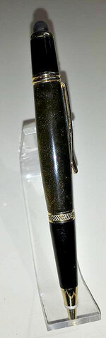

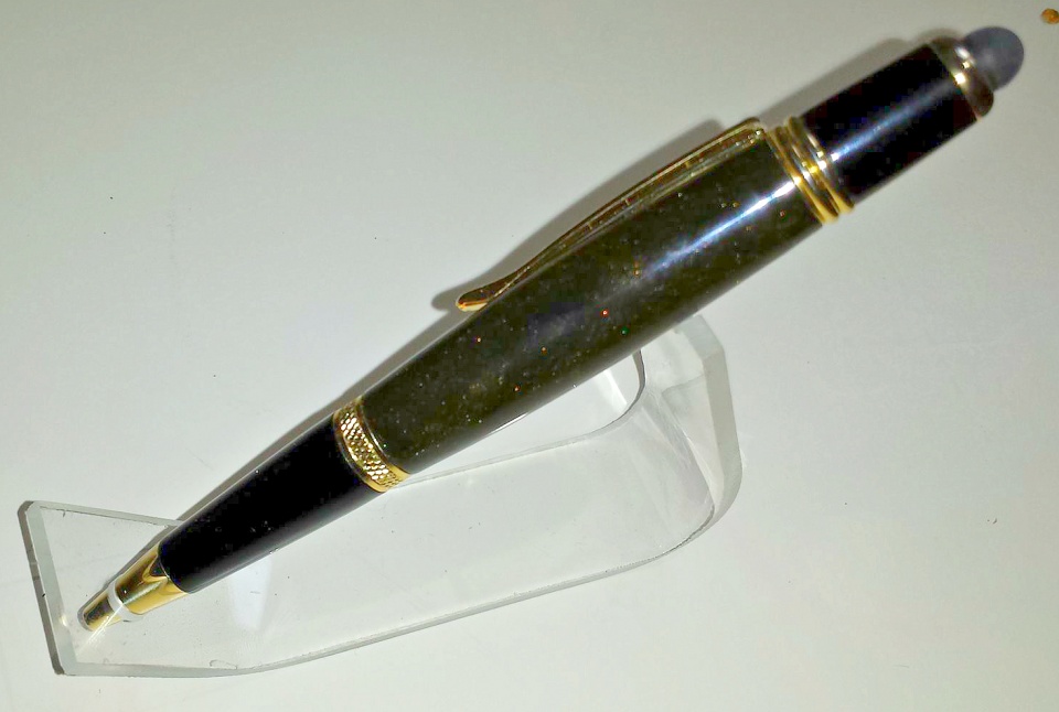

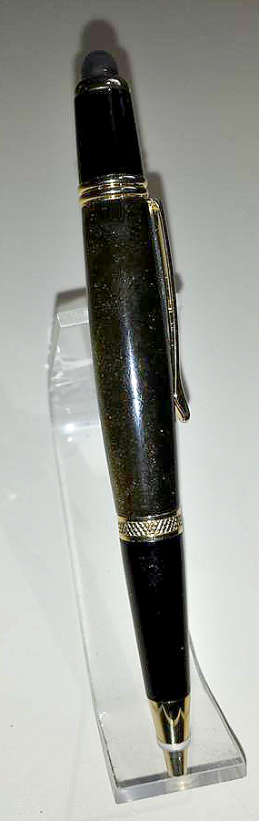

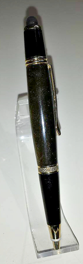

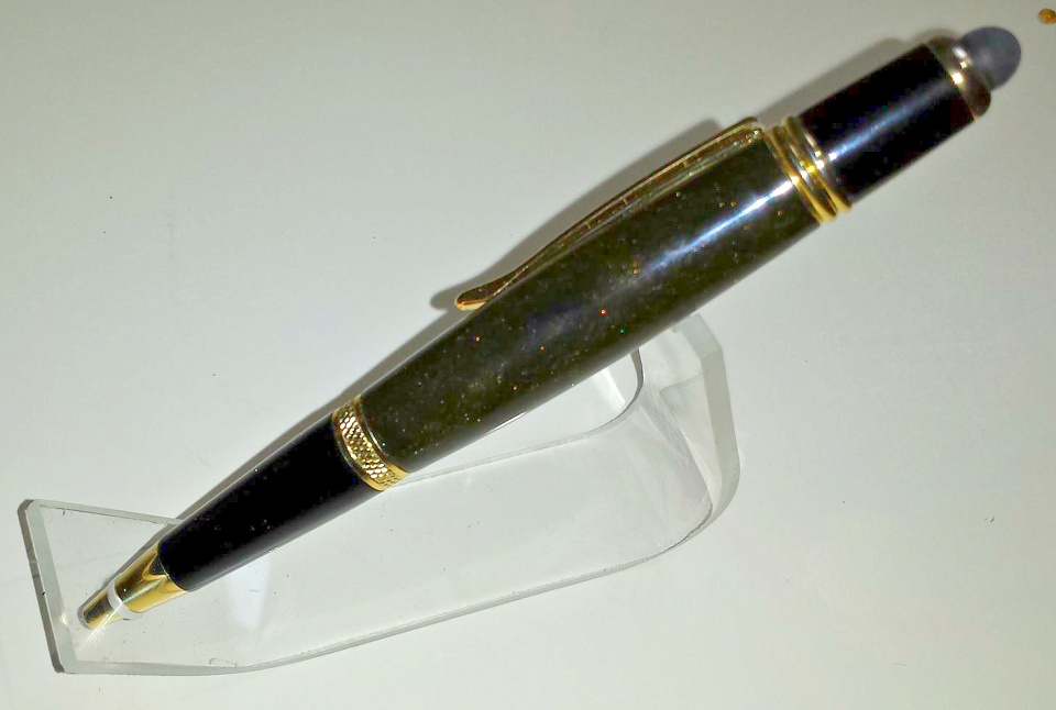

I received these blanks from Chris99210 as a gift. I cannot thank him enough. It was my first time turning inlace acrylester and I had success, mostly because of his suggestions. I also used a SHARP SHARP skew and sharpened it often during the turning. It was different to turn, but also easy to tell when I needed to sharpen. When the skew was sharp, it left almost a polished surface, but as soon as it dulled, the surface became cloudy. So LOTS of sharpening and I had success!
The pictures do not do the pen justice. It has such deep colors in it they have to be in just the right light to show off. But I gave it as a birthday gift and he LOVED it.
I look forward to turning the rest of the blanks he sent as a gift. They finish so nicely!
Thank you again SOOOOOO MUCH!!
