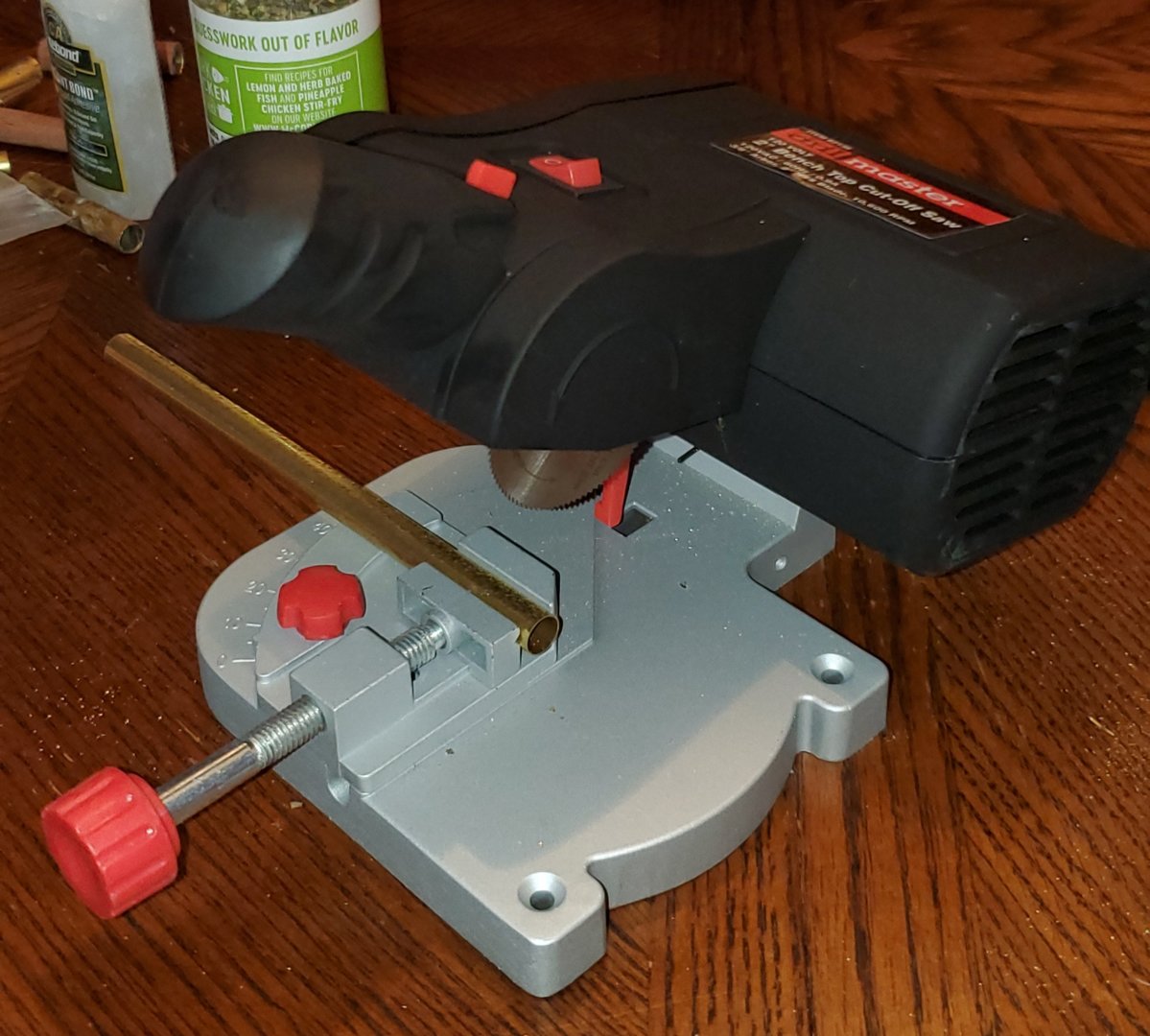

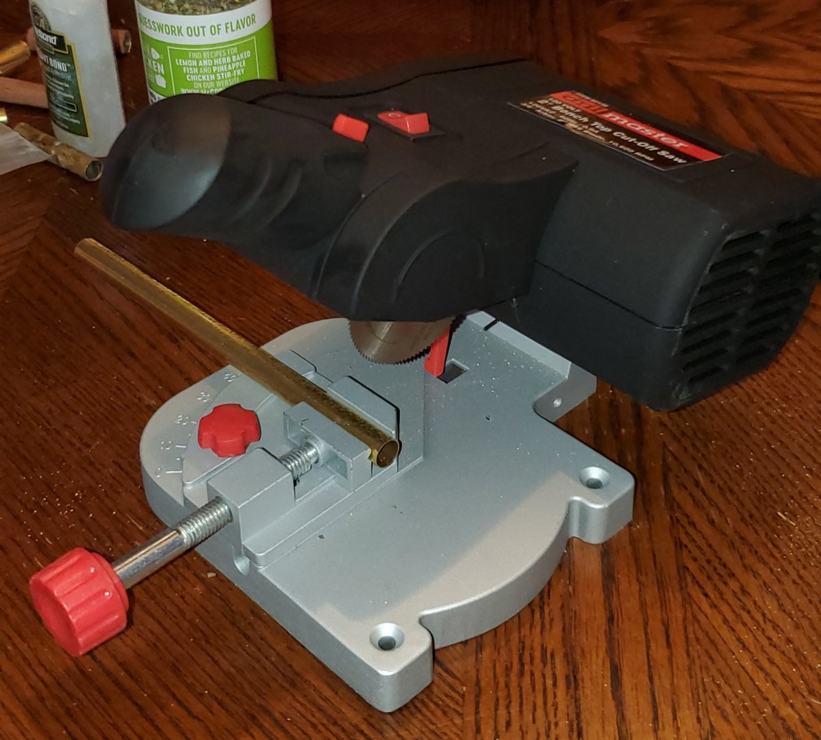

I'm new but my mentor lead me to this awesome little tool and I thought I'd pass along the info. This little is used to cut brass tubes. I was using a mini pipe cutter but this tool is much better. It's a mini 2" cut-off saw (Chop saw) This little tool cost me a whopping 22.83 after tax at Harbor Freight using their Everytime you shop little 20% off in store flyer. You can score it cheaper If you run across the 40% off coupon they had perodically. Does great mini cuts and lots 3x faster than a pipe cutter and much more accurate. There may be others that have ideas that work but this one is awesome 20190523_210207.jpg20190523_210145.jpgIMO. Happy Turning

Looks useful ... would like to get one. How well does the angle adjustment work ?
But with only a 2" blade you couldn't cut pen blanks, I wouldn't think.

I've had one for a couple years and use it to cut strip wood for making train models. It has quite a few hours on it with no issues. It's depth of cut is only about 3/8" maybe up to 1/2". Definitely not 3/4". For cutting small stock it is well worth the money. The miter gauge is ok. For model work it is fine, but its not accurate enough for fine detail miters.
