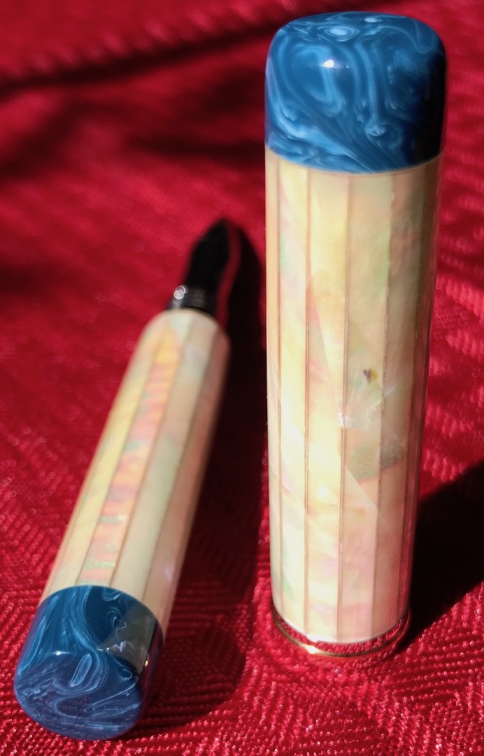

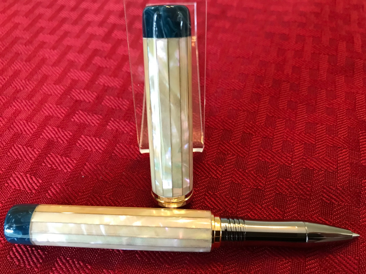

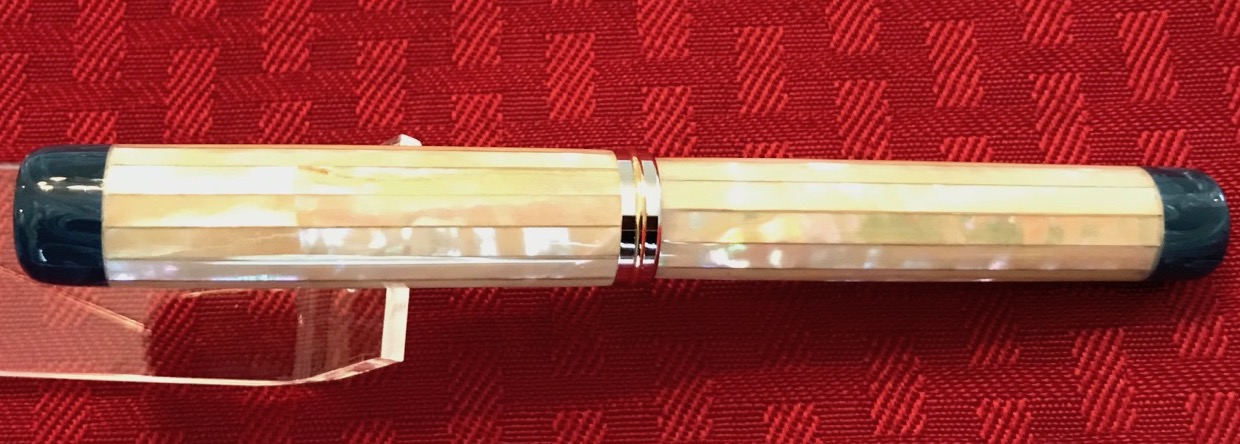

The Awabi blank comes pre-drilled (update: made by Ron, purchased from Exotic Blanks) and I made end-pieces out of left-over Amedeo blue. The length is 4.875 inches (compared to 5.25 for Jr. George), so I used a Schmidt Short P8126 which accommodates this shorter length and can fit through the Jr. George head.
The pen shimmers in the light, although I'm unable to catch the effect with my smartphone. Made for my wife's bday, hopefully she will like it. Having constructed only kit pens, this was a fun exercise, and a small step towards making a fully kit-less pen.
Something that bothers me: the tip of P8126 is a wee short. Ideally, it would protrude 1 additional millimeter. Possibly a parker refill would work better; I avoided it this time because the springs for that refill look weak, but perhaps I'm mistaken. CC welcome.
-Max
