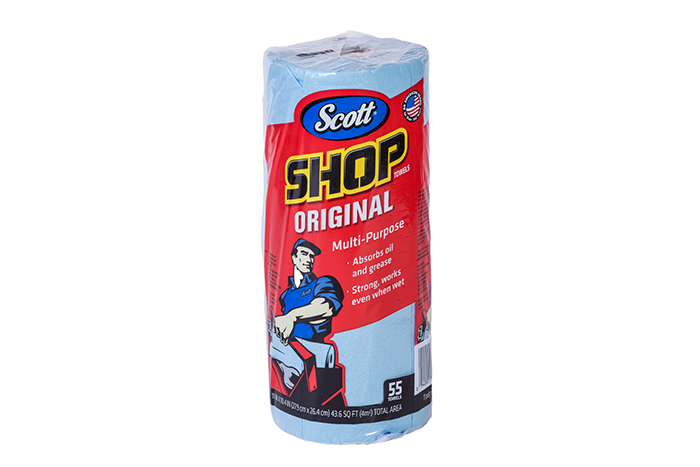

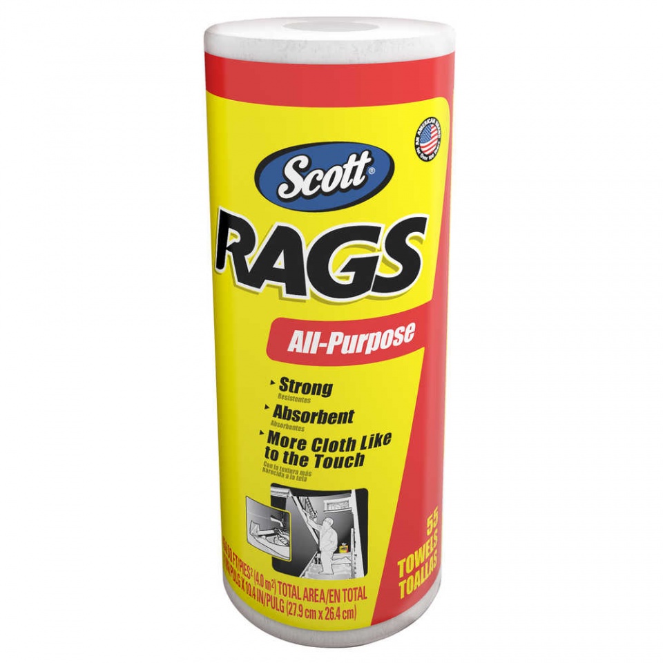

rd_ab_penman
Jun 1, 2007
1,646
Red Deer, Alberta, Canada.
These work best.
Les
