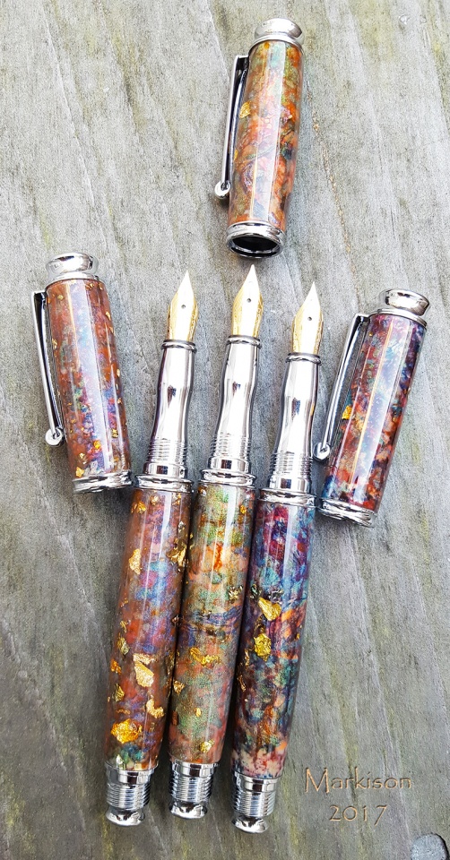

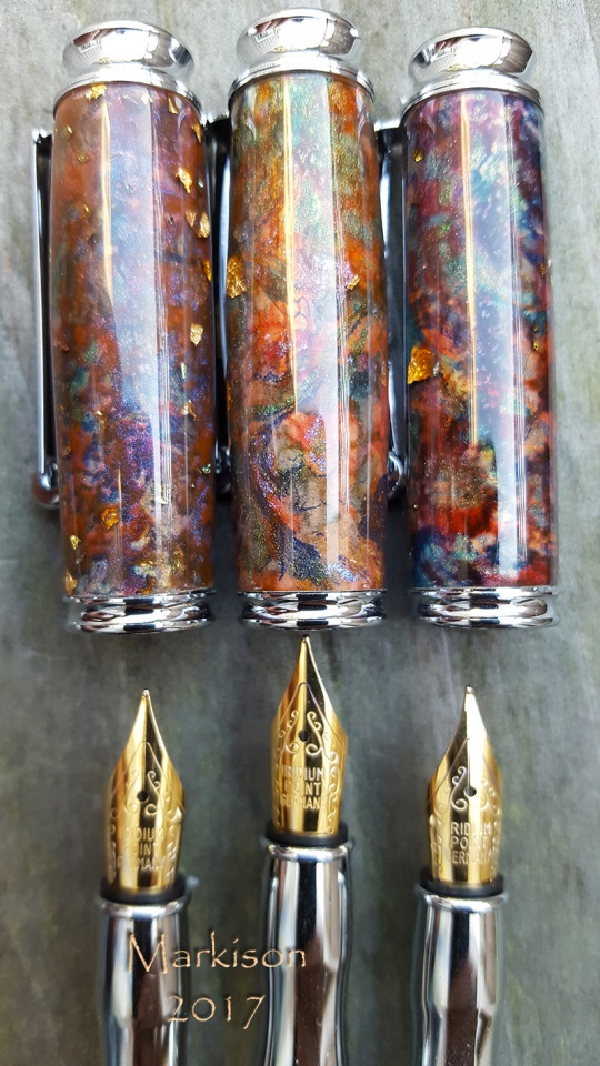

A dear landscape painter friend requested Autumn Leaves themed fountain pens for field sketching. Here's the resulting Virage trio:
Steps:

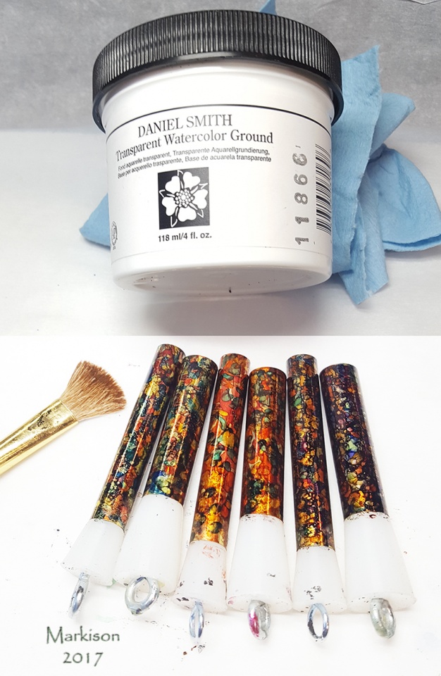

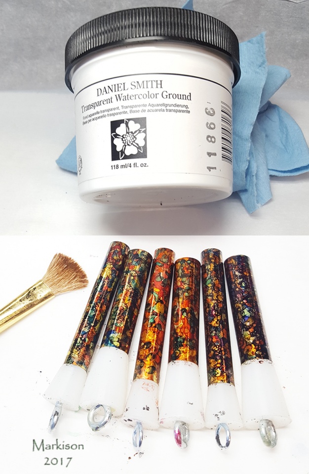

Acetone-washed brass tubes
Alcohol inked paintings (Copic and Blick brand brush markers), dried overnight
Applied 2 coats of Daniel Smith transparent watercolor ground - each coat dried x 48 hours
Alum'ed (see my previous posts about marbling), dried overnight
Marbled with Golden High Flow acrylics mixed with a tiny bit of mica powder
Cast tube-in with Douglas and Sturgess Clear Casting Resin, mixed with gold and copper flake (50psi)
Turned and finished as usual
attachment.php
attachment.php
Happy Saturday to All - Bob
I don't know if it's the glare off of the resin or not, but the tubes look an awful lot nicer then the finished pens look. Don't take this the wrong way, there's absolutely nothing wrong with the pens. I just think the blanks without the resin looks nicer, maybe it's because without the resin the paint and flake are clearer to see.
Len
Many thanks to all for kind comments!
Lucky2/Len - You make a good point: part of the dulling effect on the alcohol-based ink underpainting is glare - but part of it is probably process. I did not seal the alcohol inks with clear acrylic, so it it likely that the inks flowed up/out into the overlying transparent watercolor ground, causing the muting or dulling effect. Glad for your observation, because I'll try sealing the inks on the next run - thanks!

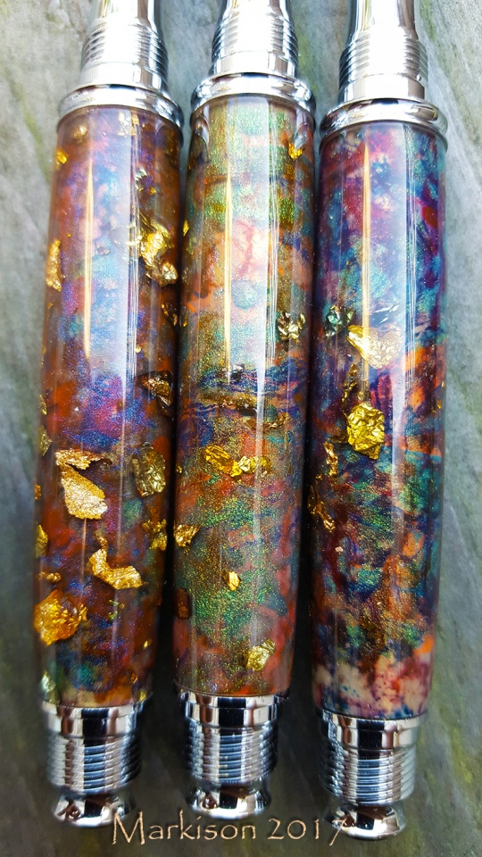

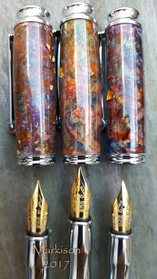

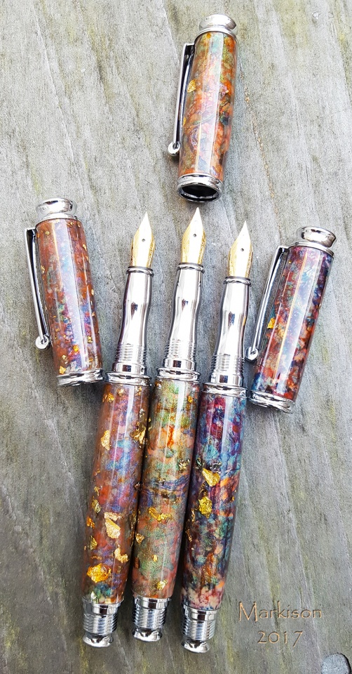

Here are the final close-up views of top and bottom barrels - taken just before the pens left home (still too much glare in the pix):
attachment.php
attachment.php
Thanks again! - Bob

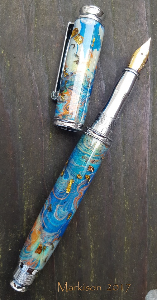

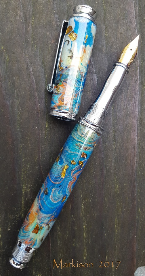

PS: I just turned this pen:
Acetone washed non-sanded brass tube
2 coats of Daniel Smith Transparent Watercolor Ground (without alcohol ink underpainting)
Alum'ed as usual
Twice marbled with Golden High Flow Acrylics (alum'ed between marblings)
Sealed with airbrushed Createx Top Coat (gloss) acrylic
Tube-in PR cast
Turned/finished as usual
attachment.php
The clarity of the marbling without an alcohol ink underpainting confirms to me that the Transparent Ground works well, and if an underpainting is done, it should be sealed with acrylic before application of Transparent Ground. All of this is subject to further experimentation, but I'm pleased with the quality and versatility of the Daniel Smith Watercolor Grounds (I have no financial interest in, nor have I received any free products from Daniel Smith).
