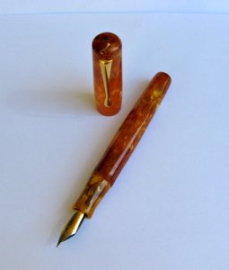

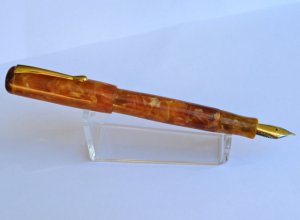

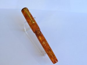

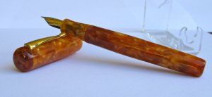

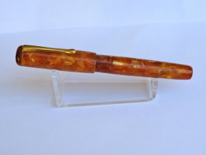

Finished my 4th pen this morning. Though it's a far cry from Shawn Newton's beautiful work, I wanted to try something similar. Thanks for the inspiration, Shawn!
Autumn Golds acrylic from Exotic Blanks.
#6 Two-tone gilded steel Meisternib, Medium
Cartridge/Converter fill
Overall Length Capped: 5.4"
Uncapped: 5"
Posted: 6.4"
Cap Diameter: .67"
Barrel Diameter: .56"
Section Diameter: .5"
I just found the Member Photo Album feature, so I hope I'm using it properly!
Thanks for posting this one Renee!!! Couple of questions for the fun of it...what would happen if you painted the inside of the body and cap? I have to get my mind around the fact there are no tubes! I really like the finial...is it the same material or other stuff? Nice work...looks like your 50th!!
Thank you for the kind words :smile:

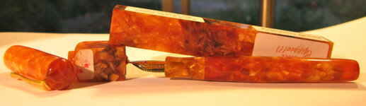

The finial is from the same material as the rest of the pen. Th blanks have some golden areas and some darker brownish orange bits. I intentionally chose to put darker areas near the end of the barrel, where the barrel and section join, and for the finial, so it has that three part thing going on. :rolleyes: I've attached a pic of the blank for you.
As for painting the inside, well the closest I can come would be to fill up the barrel with ink. I use most of my pens as eyedroppers anyway, so pick a color and I'll fill 'er up for you so you can see the result. Mostly it will make the barrel a bit darker, regardless of color.

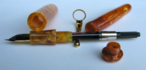

Very cool. I'd like to see the pen disassembled.
I don't think painting is an option. The threads would wear off the paint, and probably ruin the look. A possibility is to make a sleeve of ebonite or alumilite. But that's a lot more work.

Shawn will make you spend your money on tooling, and he's got you hooked by the looks!! Well done!!!
Did I miss it?
What taps/dies did you use? Triple start?
Scott (and clipped too....I'm jealous) B
Great looking pen, Renee. That's a pretty blank.
Very nice!! I won't post my first finished here. It was made from scraps
That looks great!!! Love the profile of the pen and the look of that resin..perfect with the gold hardware!

Thanks for the compliments, everyone! It's very encouraging.
Scott, here are the taps & dies. Single start -- there's no way I could afford triple start!
Finial: 7/16 x 20
Cap/Barrel: 14 x .75
Section/Barrel: 10 x .75
Nib: 7.4 x 5
