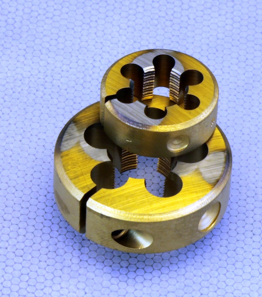

Received mine today, and I'm a neophyte when it comes to this but I need to ask, is it OK that the TiN coating is not covering the surface? It seems, to my novice mind, that it is an incomplete coating, but I need to ask.
Here is a photo:
On the larger die the cutting threads are all coated but the outside is not, but on the smaller die the cutting threads at the end are actually not coated.
I don't know if this is OK.
Thank you.

I will find out. I've already emailed the company and I'll be calling them later in the day.
For those of you that ordered the TiN coating on your tap(s) and die(s), I need you to look at them. If they look as though the coating didn't completely cover the thread cutting surfaces please let me know. It seems as though I missed checking this when I was sorting and packing them.

Mine looks exactly like the picture, it does not seem to be a problem on the 14, but the coating on the 12 does not cover all the threads on one side.
I bought a set of 14mm tap and die.
The tap appears to be fully coated.
The die is fully coated on the front face (the one with the writing), but has the "blotchy pattern" on the reverse face.
It looks like 2 of the 5 cutting surfaces are without coating on the final few threads.

I got mine today and did check it. The tap is well coated and the die has the threads well coated which is the important thing. The one side has 2 rings as you show and that is probably from the method they suspend these to coat them. To me no big deal and I am satisfied with this group buy.
