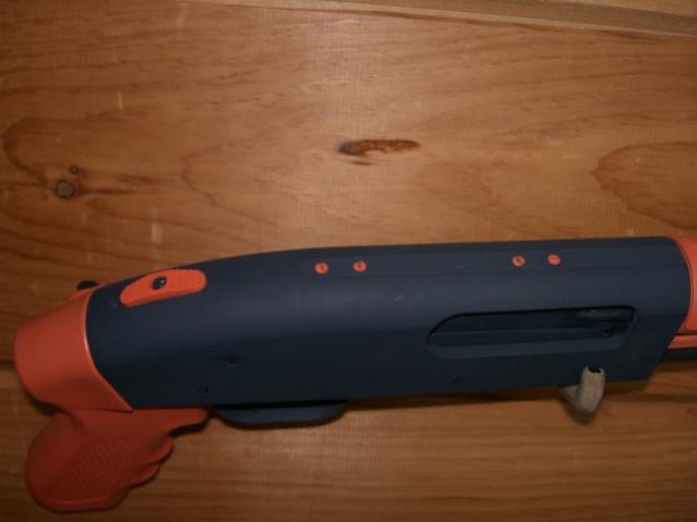

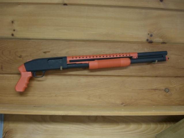

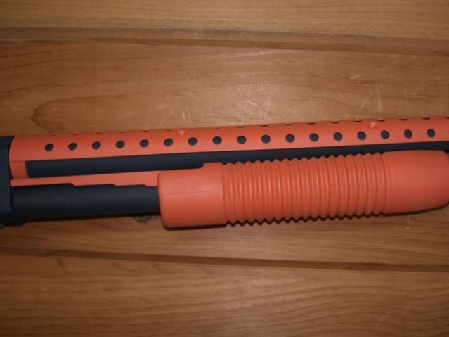

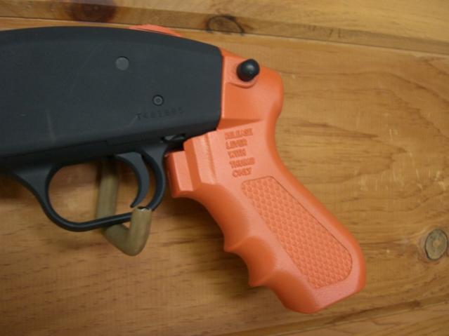

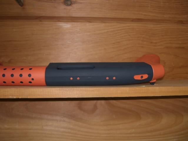

A customer asked us for an Auburn State themed pistol grip Mossberg. Here is what I came up with. As always comments and critiques are greatly appreciated..
