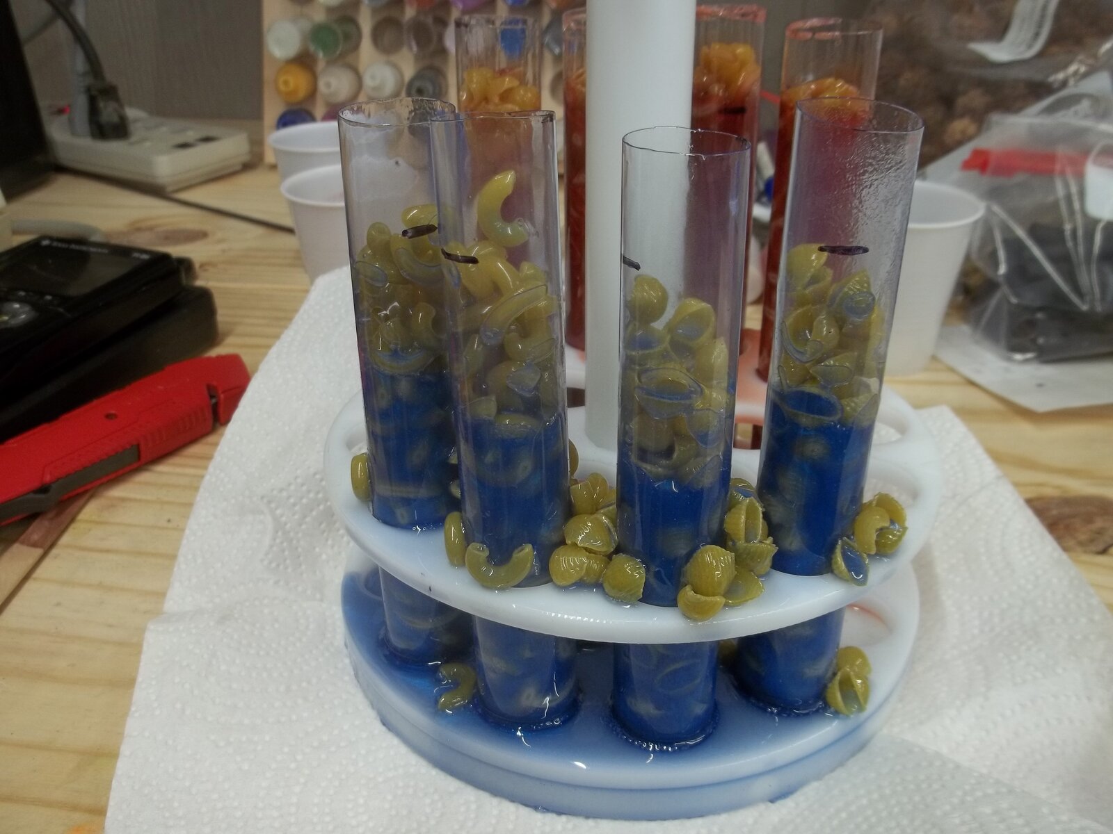

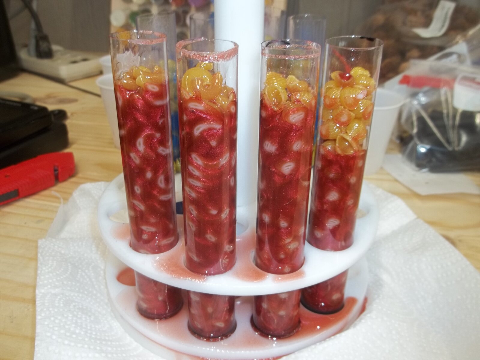

My first attempt at casting embedded objects was a disaster. I was embedding pasta noodles which would trap air so I applied a vacuum to try to remove the trapped air. As you can see the expanding trapped air pushed a lot of the noodles and resin out of the tubes. My second attempt was embedding accorn caps in a block mold, I don't have pics of this one. I used a vacumm again and it looked like there was an explosion in the middle of the block mold. I used masking tape to extend the sides of the mold hoping to contain the expanding air and resin. It wasn't enough, resin and accorn caps littered the bottom of the pressure tank. Since I opened the tank after the vacuum was applied I was able to scoop out most of the accorn caps and resin from the bottom of the tank. I think I am going to go with pressure only and live with the voids caused by trapped air. Maybe they won't be too big.

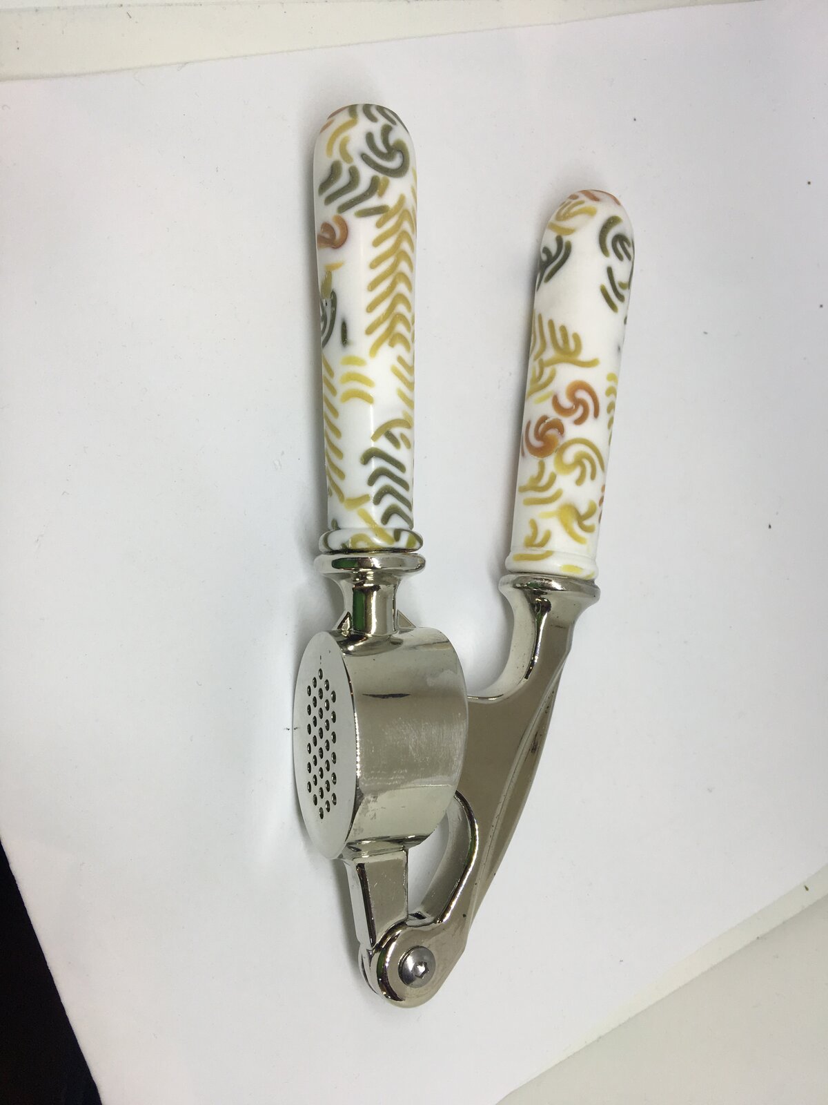

Perhaps you may be using the wrong kind of pasta. Try using Rotini or Rotelle. The are open twist pasta shapes rather than the closed shapes of the noodles which could contain a lot of trapped air. I had great success a few years back with Rotini and Alumilite White. Granted, this is not a pen, but they were pen blanks originally.

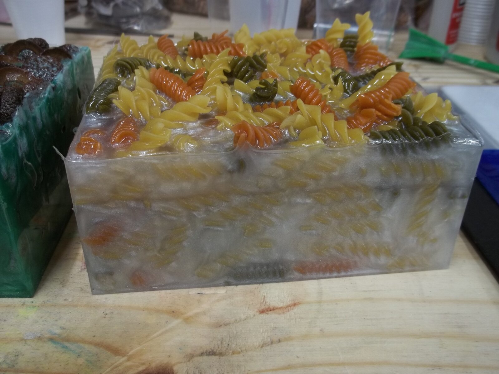

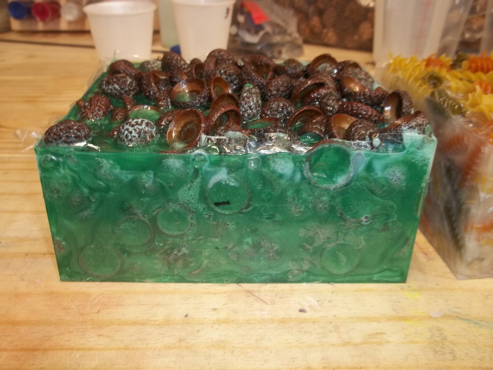

Here are 2 of my attempts at casting embeded objects in a block mold. The first was done without heating the mold and acorn caps. There are large voids visible on the sides and bottom. The second was done with heating of the mold, rotini and part B of the resin. There are no large voids visible. So, I will continue to apply the heat and see if it improves the results on the acorn caps, sweet gum balls and pine cones. Btw, the blocks are 6 x 5.25 x 2.6 inches and should yield 21 blanks.

Your voids aren't because you need vac, they appear to be from moisture in the acorn caps. Any time you see white foam along something in resin it's most likely from moisture. If they are already dry from sitting and not directly from the yard, put them on a cookie sheet and bake them at 215-225 degrees for 30 minutes before you cast them. That should fix your problem. If you recently picked them up you may need longer. I usually store my items in a breathable cardboard box for a year before I use them, but if they are wet when I pick them up I let them dry for a few days before boxing so they don't mold. Good luck!
