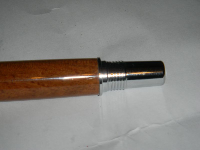

I tried the "Postable Finial Atrax" modification available from some of our vendors and am somewhat disappointed. The bushing sets for the Atrax are as follows: Cap Bushings both are .566" dia. The barrel bushings are .510" dia for the nib end and .480" dia for the finial end. The stop ring for the "Postable Finial" coupler is .510" dia - thus a mis-fit with the bushing for that end of the barrel. Needles to say this destroys the fit. For these mod pieces to work both barrel ends must be turned to .510" dia. There was no note to this effect in any product description (that I saw). Now I have to attempt to dis-assemble the finial end and replace the mod pieces with the stock finial - GURRR:mad: Moral of this story - use the calipers before turning.

Try using the TRITON BUSHINGS for the bottom barrel. I've been making postable Atrax ever since the Atrax was introduced. Alpha geek and I did some experimenting and found that the Triton threads matched the Atrax exactly.
When using the modification "kit" or in my case, Triton rings and threads, the Triton bushings get you closer to a precision fit. BUT, EVEN WITH TRITON BUSHINGS, the most precise fit is to make actual caliper measurement at the joints and finish to those measurements.
Respectfully submitted.
I've learned to always use calipers, even when I have the right bushings. Take your measurement before turning and check that against the bushing. If it's accurate, then go with it. If not then you know to stop early (or late) and check the final dimension with the caliper.
Oh, and if your barrel is tapered at all, You should be able to get away with sanding a bit off that end until you expose the correct diameter. Hard to tell from the picture how much that might set you back but you can always shorten the spring a touch if needed to release some of the pressure.
Just a little tip that might save the final product.
I just assumed they were a different size and I measured them. Of course I have been burned by bushings so much in the past. I usually either mistakenly sand, skew, or scrape my bushings and they lose their accuracy. So now I just turn final dimensions between centers and measure all kits myself. I can understand the frustration but as Carl says you can always shorten the barrel a bit. Or build with CA. I have had to build a coat of .030 with CA before. :)

Thanks Ed, I think I'll keep mine now that I know and can adjust accordingly. Actually I have 2 sets of bushings so the adjustment isn't difficult, the pen simply will not have the .030" taper as designed.
