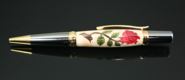

I am attempting to make a pen and pencil kit using lazer inlay kits. I am using Sierra button click hardware. The pen is complete but I am at a loss on what to do with the pencil.
The tube on the pen fits the length of the blank with a band at the top and bottom like the first photo below. The tube length for the pen is 2.42" and the inlay 2".

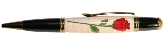

I intended to use the same inlay for the pencil. However, the tube for the pencil is only 1.76". I talked to Constant and he suggested the long stem rose as it was a bit smaller. The inlay is 1.75" and the tube is 1.76". Do you all have any ideas to get a matching band at the top and bottom?

I would cut the bottom of the stem off and just go with a small band of the excess material from the backround blank.You may or may not be able to tell.
