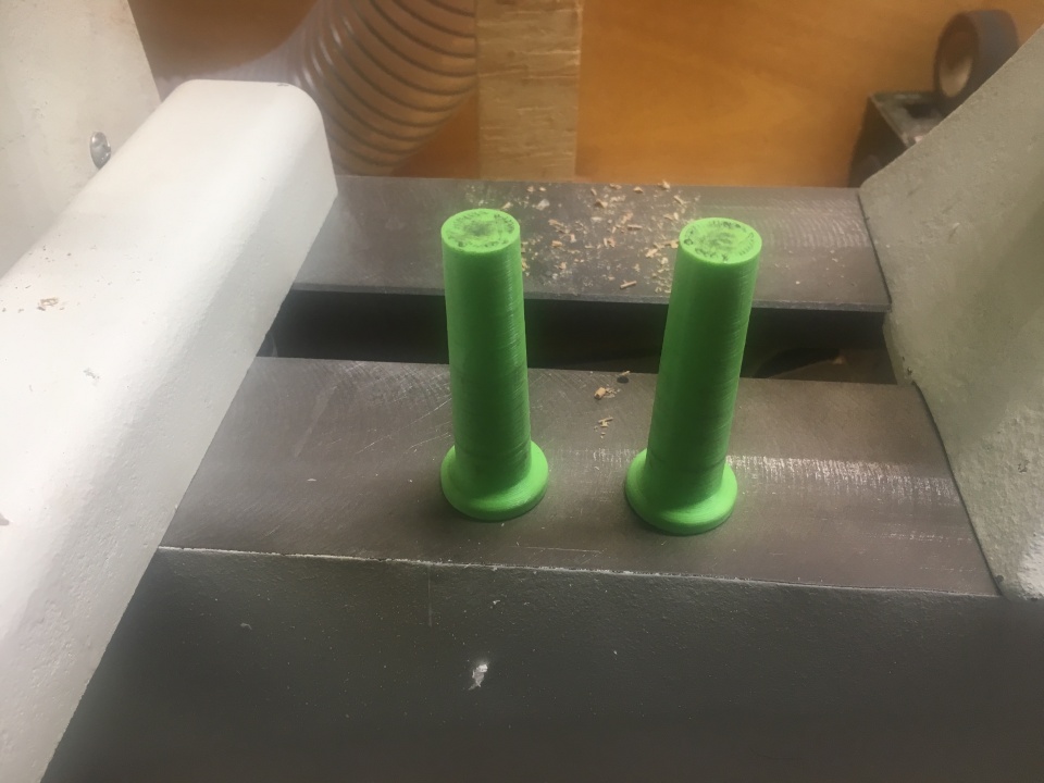

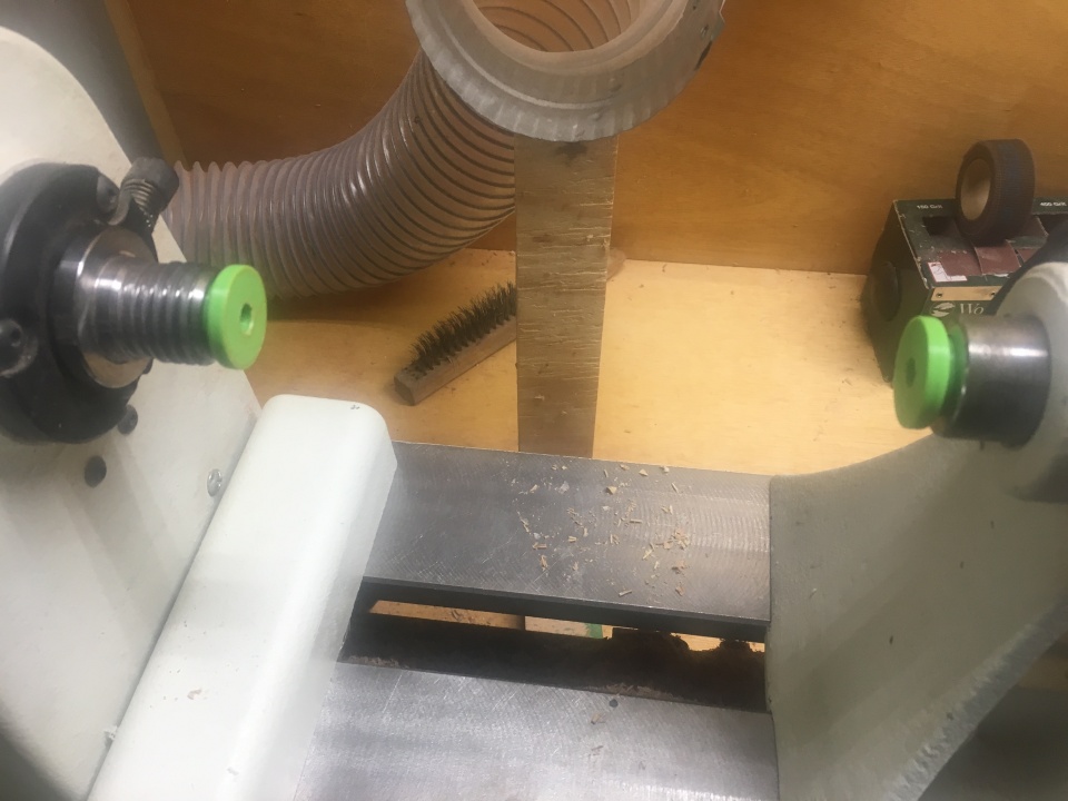

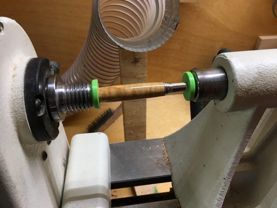

We do all of our assembly on our lathe. My son printed some MT2 plastic plugs. They work great and are gentle on the parts.
JPWO62 PM me your address and I will send you a set. You can count it an early Christmas for next year. Offer limited to the original poster. Sorry. The rest of you will have to adopt a teenage son with a 3D printer.
BTW that is an olive wood burl JR Gent going together in the photo.
