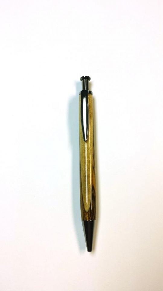

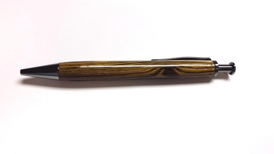

I found a solution here. I looked at converting to a pencil kit, but haven't placed my order with Exotic Blanks yet.
What I did to fix it was change the refill out with one that comes in the LeRoi Elegant Royale kit. The only difference I see is the spring on the refill. I put the clicker refill in the Royale kit and it worked well. The refill from the Royale kit did not stick out of the tip on the long clicker.
I am glad I did not have to alter my long clicker. I think it turned out well. It is a Cocobolo blank segmented with a strip of maple.
The Le Roi Elegant Royale uses a Schmidt EasyFlow 9000 refill - available many places. I don't know what refill comes with the Artisian but it's probably not a Schmidt.
The "solution" you arrived at indicates the problem was likely some obstruction at the nib (assuming no excessive tube shortening), and what Bean Counter said would also likely have corrected the issue. Just by retrying the original refill, and then an alternate one, you were in effect doing what he said. The slight friction between a refill and nib is the most common cause for this type of problem, and doing something to clear that, or possibly compensate for it by replacing and/or reorienting the spring will usually correct the issue.
Glad you are now happily "clicking" along, without having to disassemble :smile:
