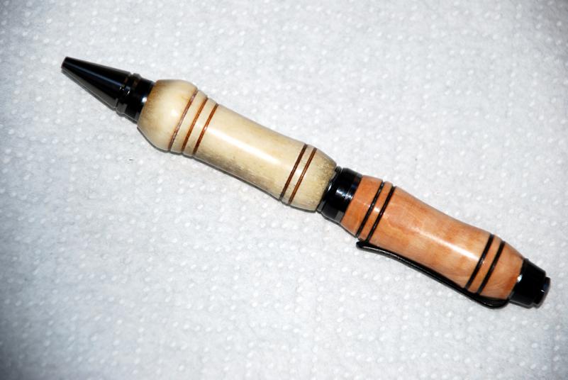

I made these for a pencil artist with arthiritis last year. i also made a similar shape out of one piece of cocobolo with an 8mm tube through it. It was a perfect fit for his ebony sketch pencils. The juniper pencil was actually an egg shaped ornament I had at a craft show. He held it, and asked me to make a pencil out of it.
