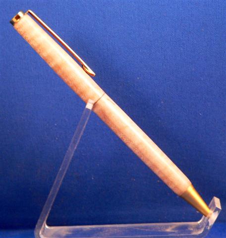

I followed the majority and made it a slim
index.php
index.php
Sorry for the lousy photo
