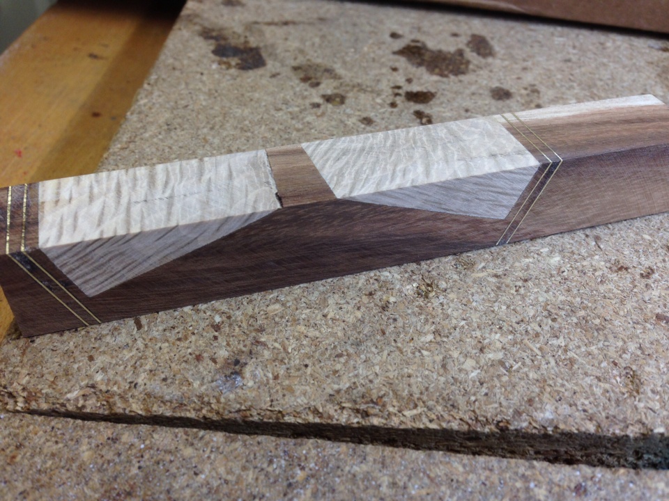

I started with the pen kit. I wanted something understated and refined but without much ornamentation. I needed gold at either end and a band in the middle. I settled on a gold Atrax rollerball.
I figured I would segment 4 slices of brass, 2 at each end, to represent the 4 gold rings. My challenge was to find a way to represent the 2 cherubim at either end with their wings spread out over the mercy seat. I picture the Atrax gold bands at each end would do well to represent the cherubs. Since I wasn't going to make them all gold, I wanted a light colored wood for the wings. But also, I wanted the grain to look like feathers on a wing. Having done some segmenting, I knew that straight lines going at an angle to the cylinder produced round lines over the top of the barrel. I thought maybe zebra wood and even looked at some swirly maple burl, but settled on a blank I got from George, Holly Oak..
My first segment is attached.
As you can see, the grain in this Holly Oak is very strong and should produce some nice feathery looking effects.
Next, I'll splice in the brass. I'll keep you posted on my progress.

I've moved your thread to the blank making forum. I look forward to watching your process, but its not really a SOYP (show off your pen) type post yet.
When you do finish the pen, feel free to create a 2nd post there.. But in the meantime this spot makes more sense for a build in progress.
Good luck! It will be interesting to see where you go with it.

I am doing the same for my pastors, but without the segmenting (not that advanced yet). I found the wood very hard and needed a carbide barrel trimmer. Your segment looks great!

Yea, I was surprised when I first cut into it. It was a lot harder that I suspected.
This is a fun journey to create something new and unique. I'll post the results in a few days. I'm taking my time to consider each step as I go instead of quickly forging ahead.

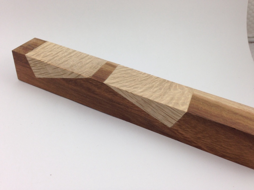

Seems like a good point to stop for a first try. Once you turn it round it's going to look a bit different anyway. I am curious to see the next step of round and on tubes.

I hear your words saying you probably have done enough to make the ultimate blank. If I have learned anything in the last few months of turning it is to trust my first thoughts. I am anxious to see it round as well! :)

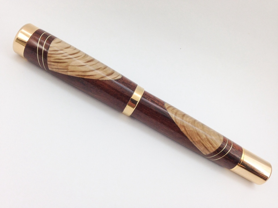

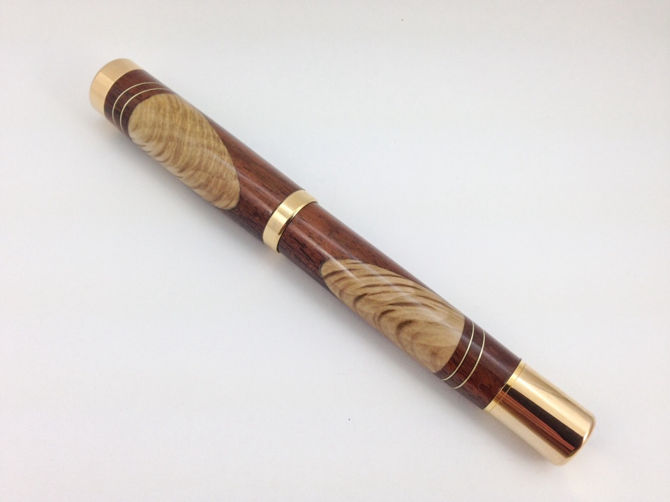

Wow Kelly...!
That is a beautiful pen, regardless what language you speak and or your religious inclinations, absolutely stunning and very well executed.
I particularly like of my Holy-Oak in there but, the segmented lines you added to the blanks, did improved the overall look of the finished product, considerably...!
Congrats mate, you done a stunning job...!:wink::biggrin:
Cheers
George

Thanks George! I really appreciate your words since I know you don't dole them out for nothing!
It was your and Mr. Anonymous's generosity that made the Holly Oak possible. That wood is a joy to work in!

That's amazing looking! Very well done on the planning and execution! The Shittim Acacia I bought looks nothing like that! It is very bland, white and straight grained. However, the logs of Huisache (Sweet Acacia) that I snagged from the neighbor's curb look like that.

See you DID know when it had just the right amount of things going on in it. The added segments really do make a difference. I think it is going to raise a lot of money for your cause. The choices you made of the woods make a gorgeous combination. Gorgeous work!

I like it alot. The story adds to it with having a plan and what you wanted at the end all set up. I think you did a great job showing the parts that needed to be shown and created a talking piece that should raise good money for your cause. Often times we just throw a blank on a pen kit and if we had a story it may help us try something new and create what our imaginations show us.

The blank looked pretty character-less when I got it and I thought it would be pretty bland on the pen, but since it was from the Sinai, it had a different beauty. I was totally surprised when I put the finish on! It resembled other acacia, like Koa.
Maybe I'll bid on the pen myself! :biggrin:

Beautiful pen and you should be proud of it. I am thinking that if you had but a piece of the darker wood through the wings it would have made them look more like wings and enhanced the overall effect you were shooting for.

Oh ... That is a brilliant idea! Kinda wish I had done that. I have two mode blanks so maybe I'll give that a go next time.
Thanks man!

One of the hardest parts of finishing this pen was to match up the upper and lower barrels when the top was screwed into the bottom. It took me 3 tries to get them matched.
Does anybody know a foolproof way to do this first time?

Thanks so much for relating to my quest of a theme pen. I loved the process and really appreciated the inputs. BTW, I donated this pen to the church auction going towards missions in north Africa.
This motivates me to dream up another theme effort! :)
