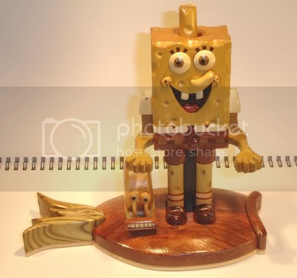

hehe...This is Spongebob with pen in storage mode.

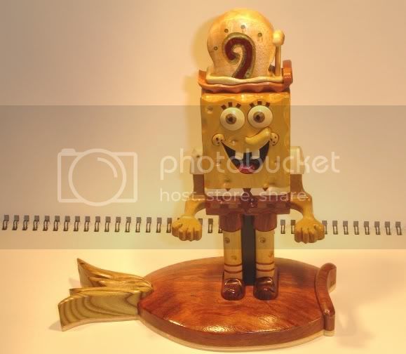

This is Spongebob with Gary removed to access pen. Gary is held in place on top and on base by a magnet

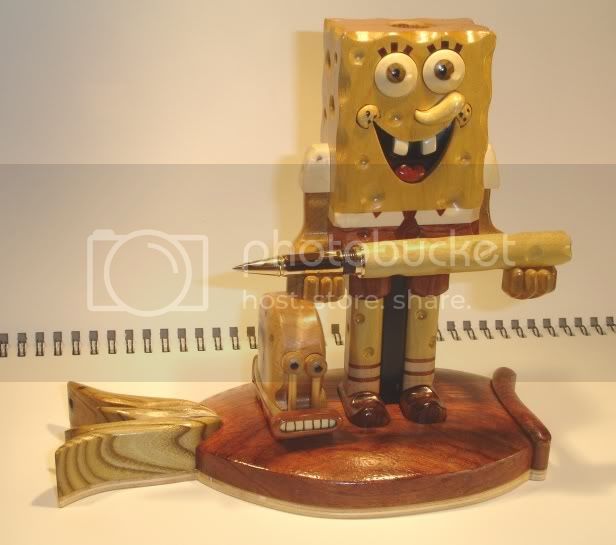

This is Spongebob pen while in use but needed right this second..the pen can be placed in SB's hands.

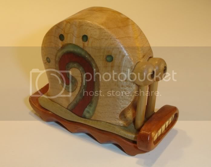

A close up of Gary, Spongebob's pet snail. Meow !
This is a concept that I changed many times over in my mind. I used a sedona rollerball in the end because of it's slimmer size. I did not want a fountain pen to potentially leak inside spongebob, or the nib be damaged during storage or falling out of his hands perhaps...a necessary precaution! The cap tube and insert are down in the bottom of Spongebob, so the pen can be twisted into his body. Thanks for looking. Go grab the kids!

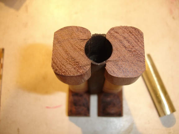

Lower tube insertion
The lower tube not only holds the threaded insert but also gives strength between the legs and body. This is what it looked like after drilling into the legs. I about pee'd myself while drilling this..it is drilled after legs are assembled..omg those walls are thin!!! :eek::eek::eek: I do not own a big fancy drill press...my drill press is a bench model that I bought at a box store about 10 yrs ago for $50. It has no power, but it's accurate no doubt about that!

Very cool Jeff. That brought a big smile :biggrin: How many different woods and what types did you use?
It is Brazilian Satinwood, Bubinga, Ebony, Bloodwod, Sumac, Holly, Maple, Blue Mahoe, Pear, Padouk and one more that is at the tip of my tongue but I can't remember. So that's 11 wood types. Plywood under the base. Black marker, and inlace with a bluish green pearlex tint. Oh...I guess the eyes and dowels are a different wood too..probably birch is my guess. The eyes were maple plugs. Technically his eyes free float, but I don't have any balls that small :wink:, and if his eyes were to float then they are at risk of breaking, so Gary's eyes are plugs drilled into his shell. One eye is a bit higher than the other, but it doesn't make any difference if they are even or way off, because he's Gary...same as Spongebob, you can make his eyes go any direction you want!
