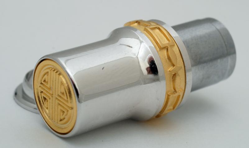

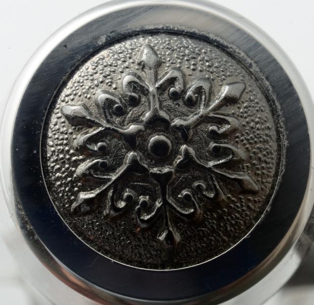

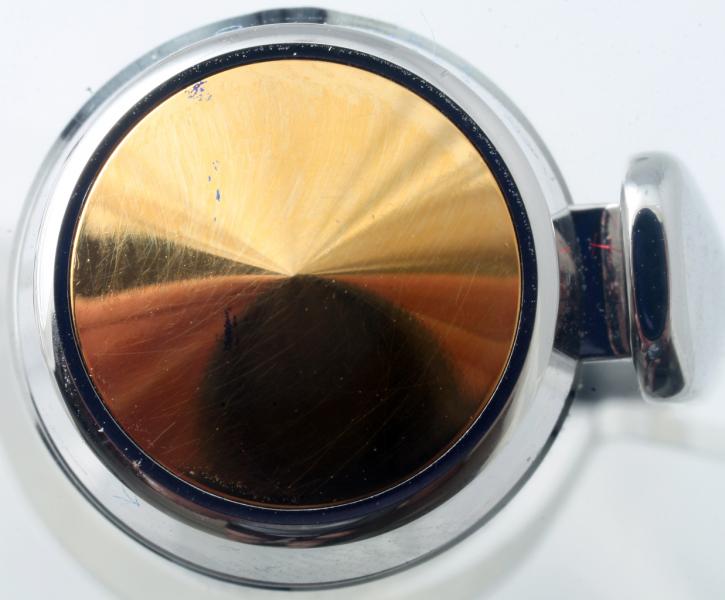

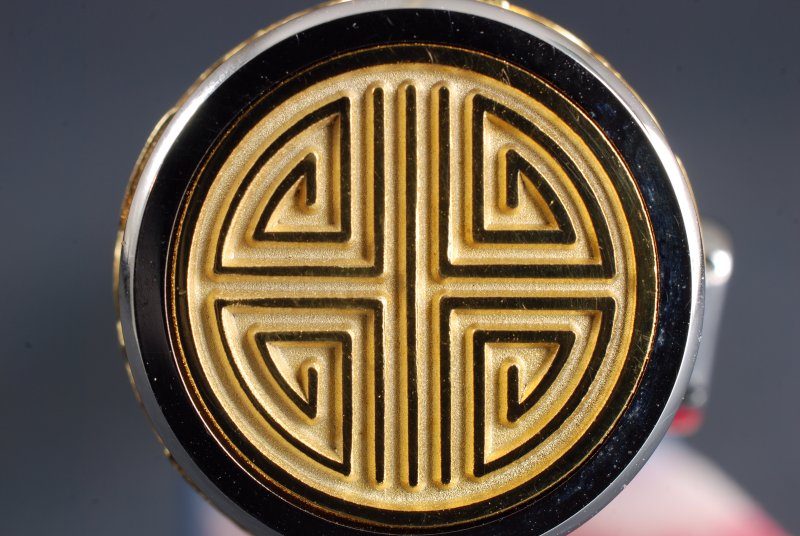

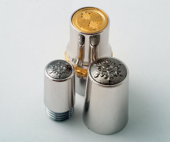

This is something I have posed for some time now. I also have always wanted one so I decided to bite the bullet and do it. The problem is now that I did I am hesitant on the series. After taking photo's and going over them I noticed several things that struck me as odd.

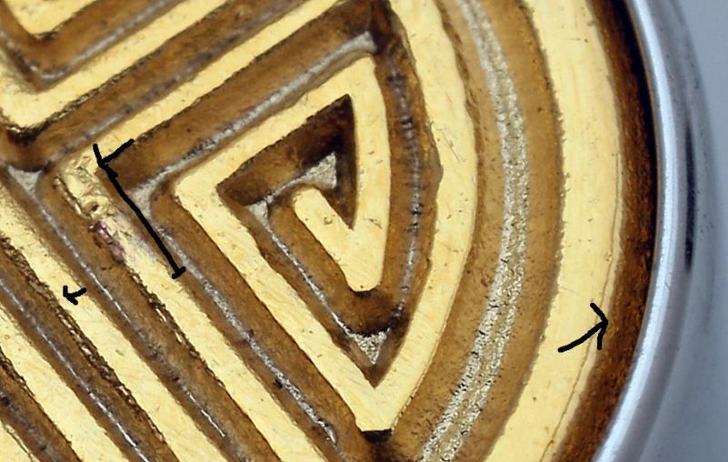

First I need to say when you take photo's at the detail that I do you will see just about every flaw there is. Good, bad and the ugly comes out and what I saw in this series I first thought was a major deal. The more I looked and the more I ask the more I found myself questioning my high standards on this.
Due to photo size restrictions the main flaw that I see is not very visible, but I will try.

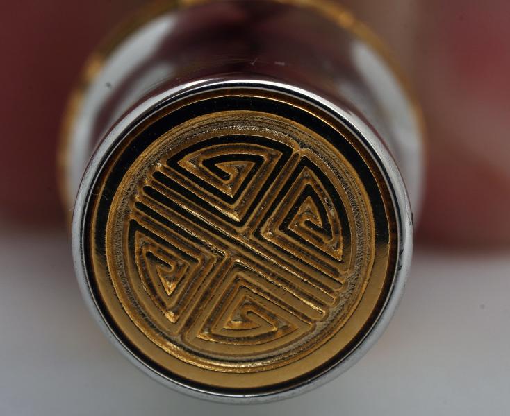

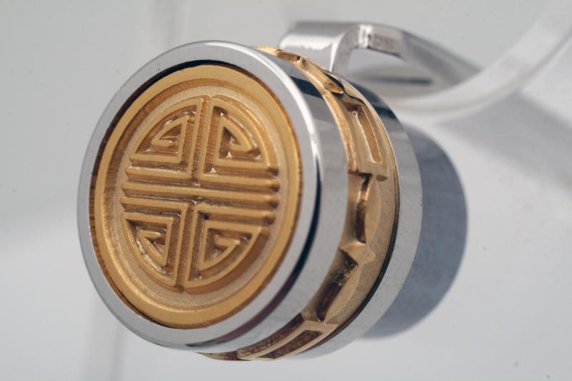

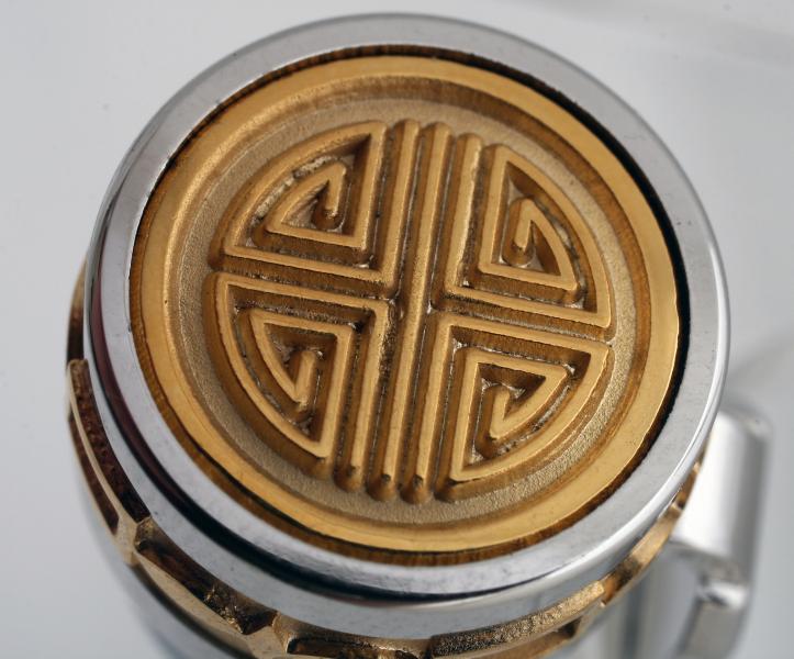

first it is the matting between the gold insert and the rhodium frame, the angles does not match with the design in the gold insert and it is grossly off.
attachment.php
The black arrow on the RIGHT is the key point that I first noticed, BTW this is the small end cap on the bottom of the pen, In the above photo the distance is approx 1/4" left to right. The left black arrow is the variation in distance between the valley's, also the high spot ridges than seem to be ugly chipped looking corners, possibly flaws from manufacturing.
attachment.php
attachment.php

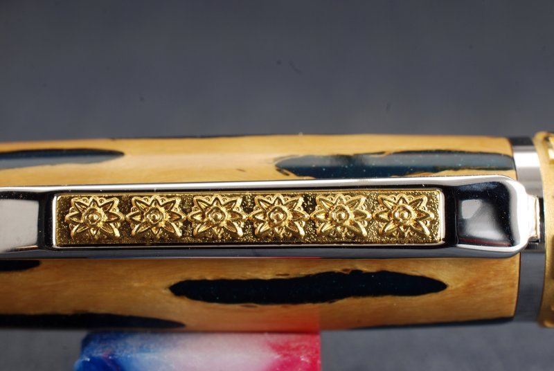

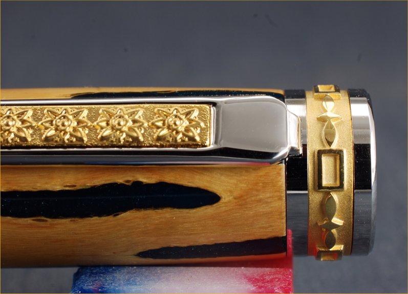

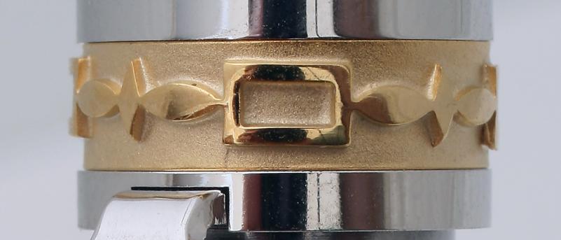

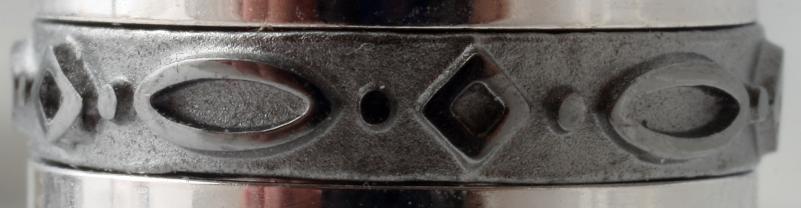

Note the first image, the gold ring band right after the fish and square seems lumpy compared to the rhodium, well that is because it is. Oh and yes that is casting flaws you see.

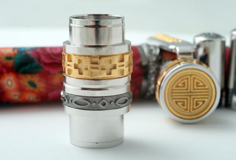

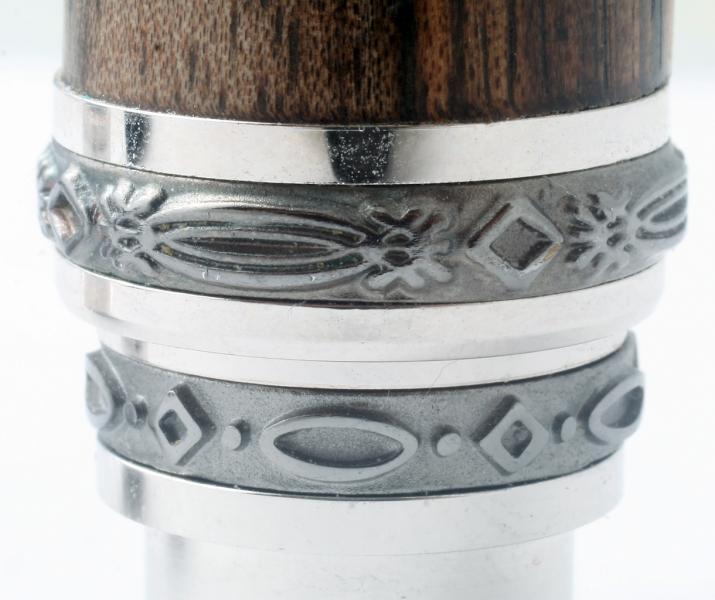

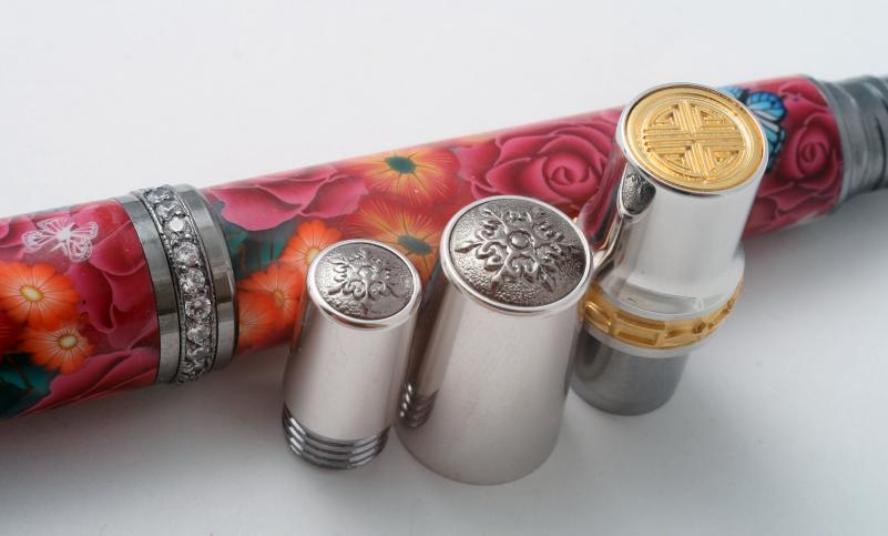

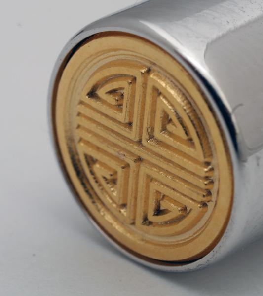

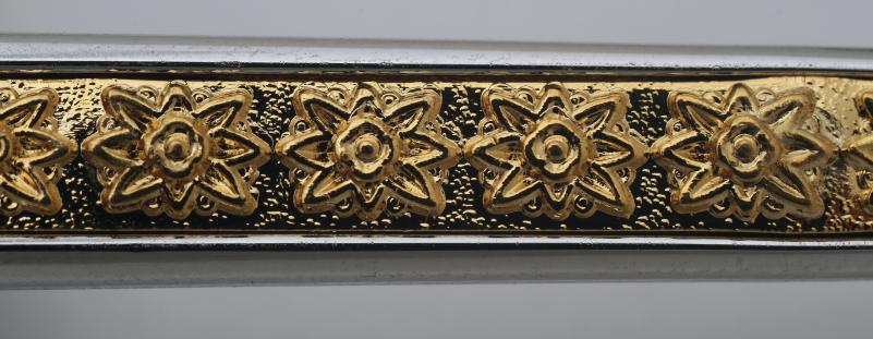

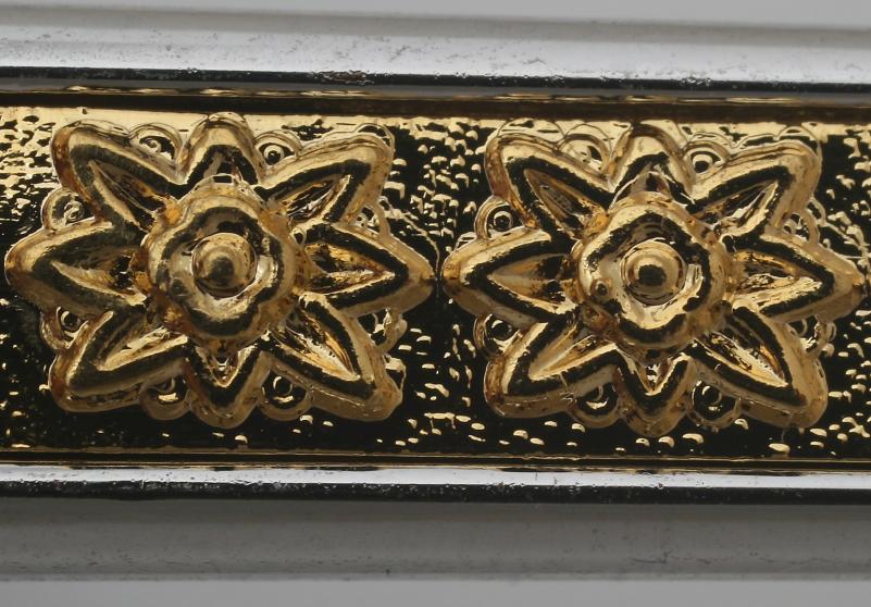

Second The pattern in the end caps, clip, center band and blending in all these places are well across the board.
attachment.php
attachment.php
attachment.php
attachment.php
Yup all different and somewhat dysfunctional but workable if used properly. Which means not just any blank will flow.

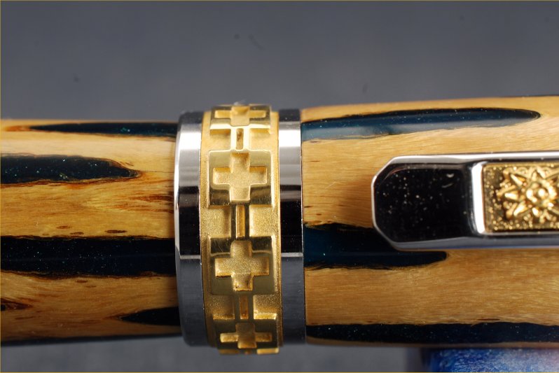

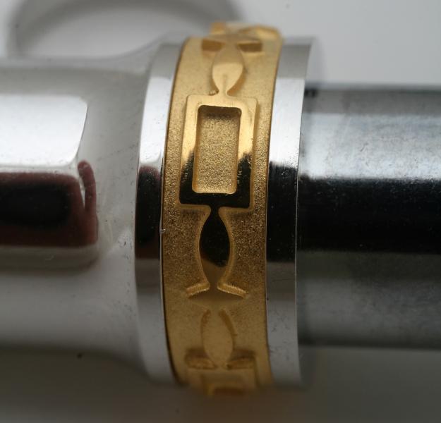

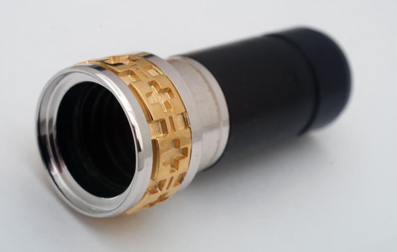

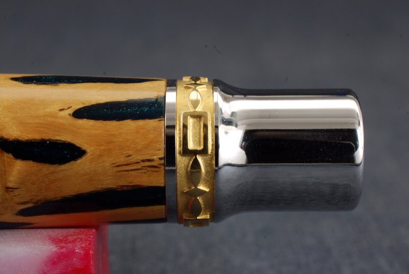

Third. It is worth nothing that yes that gold ring band on the cap looks off.
attachment.php
Yup it is. The square box on the left side, center and right side is not the same height. The whole band is skewed, this is not a casting problem. This is another design problem.

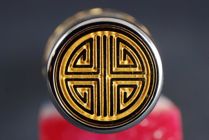

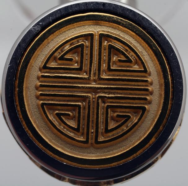

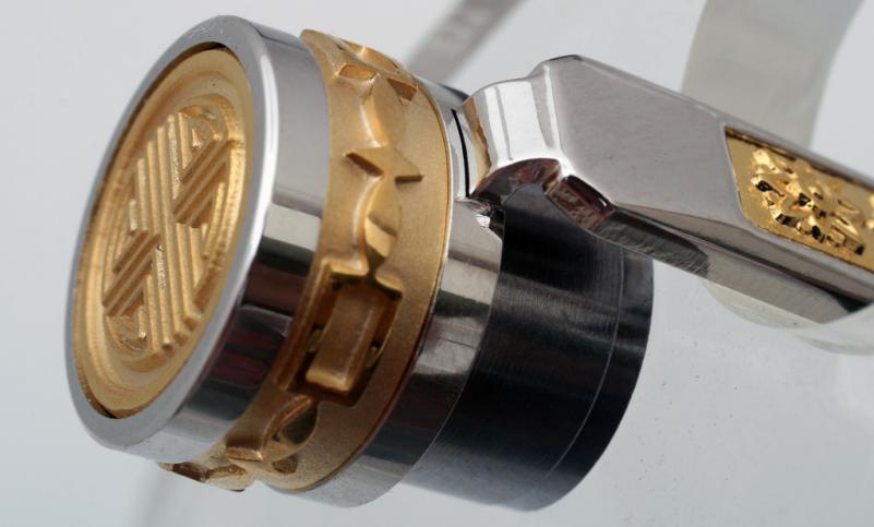

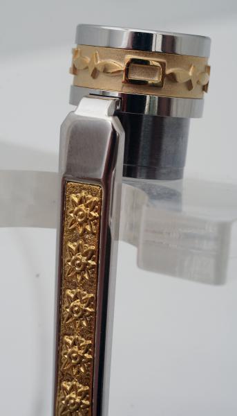

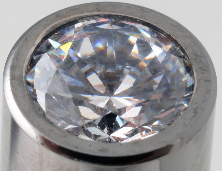

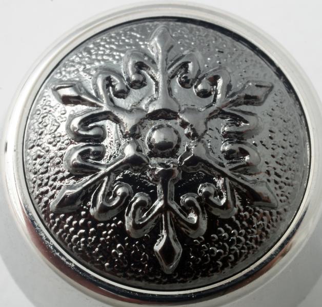

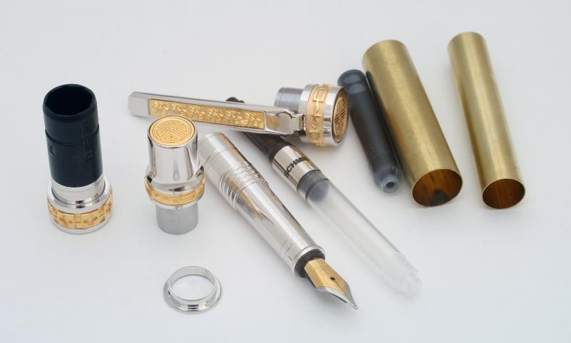

Fourth. We still see the plastic insert in the cap, yet the clip is reinforced and the buttcap is press in rather than screw in like in the gents/statesman series. I can see this being an annoyance to some, mostly in rollerball setup.
attachment.php
This has been a somewhat common theme in this series with plastic being shaved off and the plastic cap not making good contact or staying in place. It is pressed into place rather and can/does come off.
I have been told by several things like 'these emperors, they are good sellers', 'if you have that many problems with it why not return it?' and 'this is nitpicking/perfectionism'. Bottom line is I wanted one and now I have one. My leaning now is perhaps I have/had unrealistic expectations.

Some things, such as the flare gap, look fine to me and may even be considered a design feature rather than a flaw. The poor molding, however, is not just a lack of feature detail... it looks very amateurish from a quality standpoint. I consider pens with those type of detail failures to be a couple (few?) hundred dollars, max (at least if I was the purchaser). If I was paying more, the pen had better have very sharp details (that first pic is scary... looks almost like they tried to fix it with some solder).
Just MHO...
Thank you very much for the review. I have been thinking of trying this kit as a top of the line model. The extreme high cost has kept me from getting one to sample.
I have always heard that these were very popular high quality components. Based from your review, I don't think I will be adding this to my regular collection.
That being said, this is only one example. Can anyone chime in with their experiences with this kit. I love the design, even the poor casting I can get by with. However I could not live with the miss aligned components. The improper sizing of those rings would make it unsaleable for me.
Once again, great review. Thanks
I've never bought one as I've always considered them over priced for any kit. Things like the skewed casting on the center band, the rough casting detail and the fact that at the end of the day it's still a kit just turn me off at that price point.
I'm sure they are good sellers for many but I just don't see the value in them.
I would like to point out that at the level and detail of the photo's that I take, macro 1:1, any flaw, problems, big small or minute will show up in gory detail. From casual observation you may be very hard pressed to see some of these problems with the naked eye. Also with this level and amount of detail you can clearly see everything and everything does indeed have imperfections.
One person did point out to me today that the original insert, bands and the like may have been artwork done by hand, i.e. clay or similar. Then like coin making that object reduced in size and mass produced. This could clearly explain many aspects that I noticed.
One think that I would be curious to hear is from other people who have emperor's (oh btw this one is a junior) and the second thing would be great for me to see other emperors and possibly the bulk of things I noticed is limited to this one kit and not widespread in the entire series.
'over priced' does come to mind greatly and often on this. I first ask myself, why the cost, the plating itself could contribute to the bulk, also fee's to the designer(s) possibly, higher production cost for quality and techniques I could also see. That question is still unanswered.

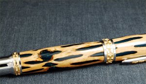

I have done 10 or so of the Jr Emperor pens over the years and have seen no imperfections. Love everything about the kit except the price.
While I can see the imperfections in these photos as Ed said with the naked you and I most likely would not and so our customers also would be hard pressed if not impossible to see them. I have sold a couple of hundred full sized Emperors for anywhere of $300 to yes over $1,000.00 and have yet have one customer complaine about the plating,design flaws,poor molding or any other aspect of the pen.

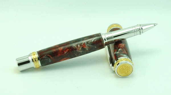

I have made five of them and the Emperor is my favourite pen kit. The fountain pens are smoother to write with than any other fountain pen kits that I have tried and I have tried many. As far as price, penblanks.ca has great quantity pricing on the titanium ones.

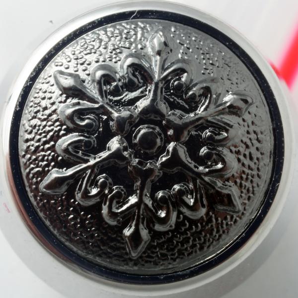

As we can see, super super light use here and we have some serious scratching going on. Usability is good and this amount of 'damage' is not notable by the naked eye just yet but any type of real world usage will likely see much more. I would like to point everyone's attention to the SCRATCH PATTERNS, is that consistent with PLATING? This is a Gent JR postable rollerball pen.
Next up we have the small end on a venus pen. Remember this is a show pen and never subjected to abuse, been in a pen bag or clear holder most of it's life.
attachment.php
Here we see a very rough sloped surface that shows some bad cleanup marks before plating, possibly some issues with plating itself and the 'bling diamond' that is plastic of some sorts ;) has several dot chips all around the edges, *NOT* on the top where would be consistent with wear.

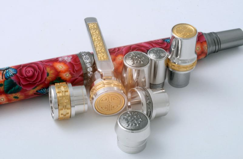

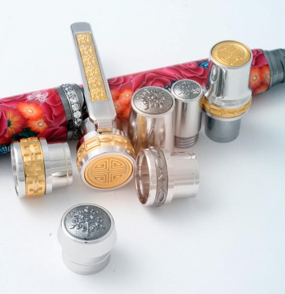

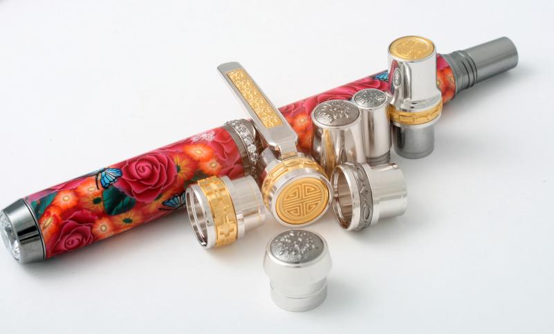

I had to tie in the emperor with these to get some compare going on. Here is a more glamor shot showing the top cap out of focus in the background and the center band with a statesman JR band in the foreground.
attachment.php
statesman Jr postable, statesman non-postable, emperor Jr with the polymer clay venus by Toni Ransfield.
attachment.php
Same setup but showing the reflectiveness of the emperor jr.
And finally the 'group shot'

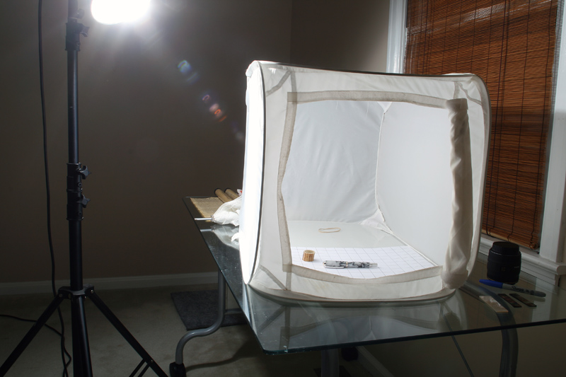

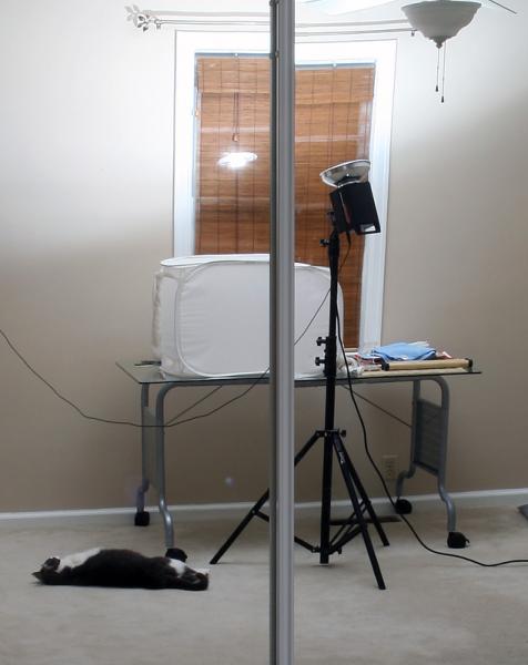

In case anyone is wondering: All shots done at ISO 100. The bulk of the shots are done at F/22 and 1/200 (some caps at 1/125), with the exception of the very last image. It was shot in manual mode at F/29 and 1/200. I hand hold and do not use a tripod (I do own 4 tripods). Lighting was done inside a light tent with a photogenic 500W/S monolight on a direct path at 1/8 to 1/4 power. Lastly camera is a canon Kiss Digital X with a sigma 50mm 1:1 macro lens in manual focus.
This is 'direct path'
attachment.php
As opposed to 'bounce path'
attachment.php
And lastly inside the light tent I use
attachment.php

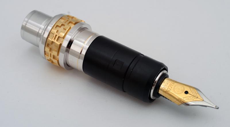

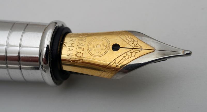

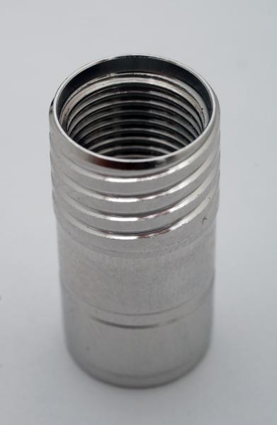

OK, it took a little longer for me to get these than I expected, but here's closeups of a full-sized Emperor I have on hand still.
First the lower (body) finial, it looks a lot like the Jr., with maybe cleaner lines.
attachment.php
The larger cap finial has a lot more room between the lines, and also over all looks pretty good, but you do see the micro scratched in various spots, and to the left there is one line that narrows down from lack of material.
attachment.php
I believe I can see some "slight" variations in the positioning of the squares on the cap ring.
attachment.php
I don't see anything noticably wrong with the clip. Detail seems pretty even across the length.
attachment.php
Center band ornaments seem pretty evenly positioned, but the the one just below the center line of the photo looks slightly twisted.
attachment.php
And the lower band looks pretty evenly spaced, but a few imperfections showing.
attachment.php
As has already been discussed, these are very close-up shots that really bring out details that aren't even perceivable to the naked eye however, as evidenced by the whole pen photos I posted of this pen about a year ago (click to see the larger copies in MPA):
Does someone have aMontblanc, Visconti , Aurora or high end European pen they can take some close ups of so we can see how they look? I was never much interested in pens until I started making them so my personal experience with fine pens (other than the ones I make :) has been limited. I have a friend who has a Visconti that set him back a few grand. Its is a marvelous pen. It absolutely reaks of class and quality and writes like a dream.
Dave, your kit appears to be in significantly better shape than Ed's... the imperfections you point out are relatively minor, and I would feel significantly more comfortable selling that set of bits in a higher end pen ($1k?). Beyond that price point, however, I truly would want perfect bits/baubles... likely something of my own construction.
I have a few questions and concerns here.
first, what is 'perfect'? there is nothing that is perfect, everything has flaws. To what degree do you draw the line with acceptability. If you look closely at the link he provided you will see the lower band is also at a cant angle. If you look at the center band on the left you will see it looks ok, look on the RIGHT side you will notice a non parallel end. The other think is the very very first photo I posted is at most 0.25" from left edge to right edge of the photo.
The larger size pen vs the Jr also makes the difference as well. Not only is there more real estate to work with but you have number of units made for that specific mold which apparently the junior that I have has a higher count on that specific mold.
Sadly I do not but if someone does and would like to send it to me I will take several photo's of them and mail them back.

Some excellent photography there Ed - nice work.
Now if I were going to use that pen cap to print money, I would be concerned - greatly....but if I owned it, that isn't what it would be doing. It would be on display with the ones I do own inside a glass case. Folks, including myself, can see it with their naked eye (or through their specticals or contacts) from no closer than about three or for inches. At that distance none of the imperfections shown in your pictures would catch their eye.
I've got a Emperor pen done for me by OKLAHOMAN using one of his special blanks and even if I could see such imperfections you'd only be able to get it from me by stealing it. I have another made for me by CaptG with one of his special blanks and you'd also have to steal that one even if I knew it had the kind of imperfections that you show. I also have a number of pens that are not emperors that fall into the same catagory. If there are imperfections in the components, they are just not important to me.
