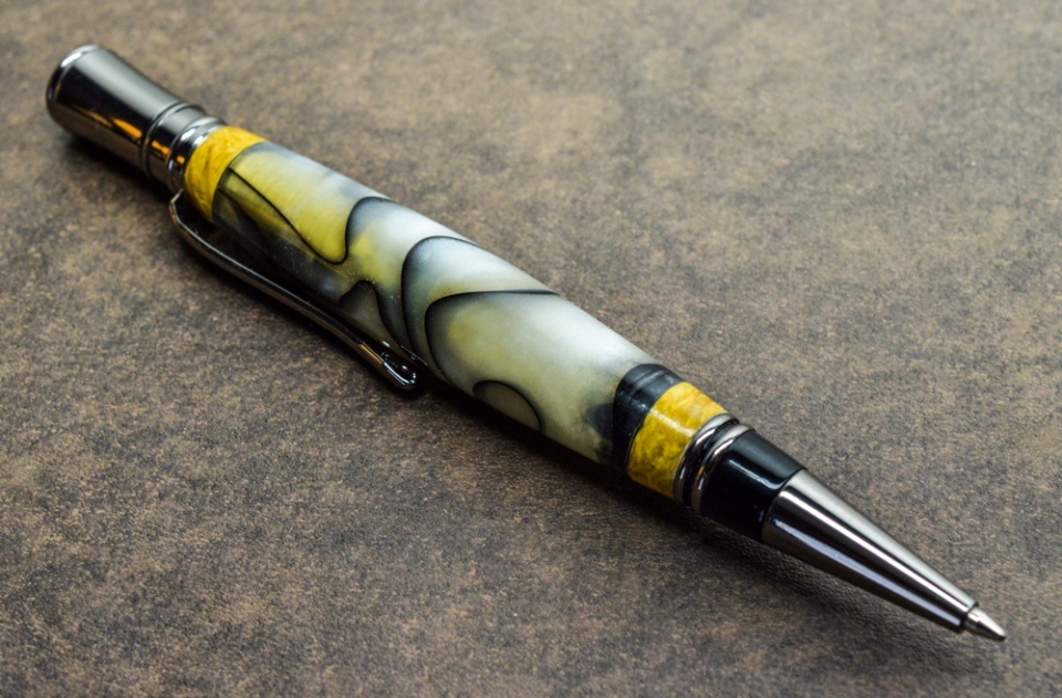

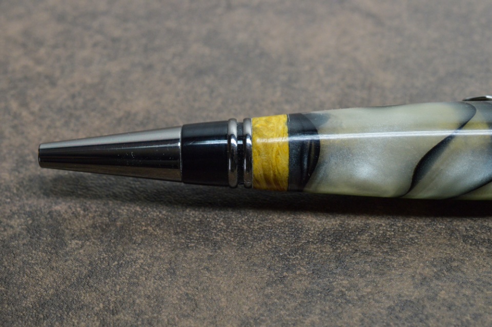

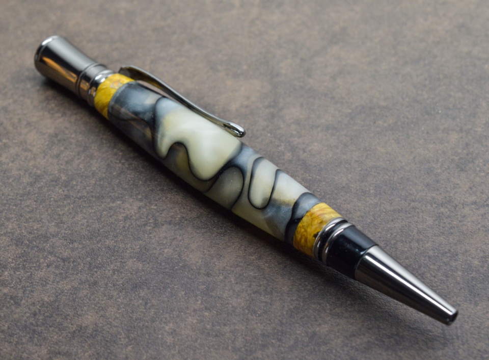

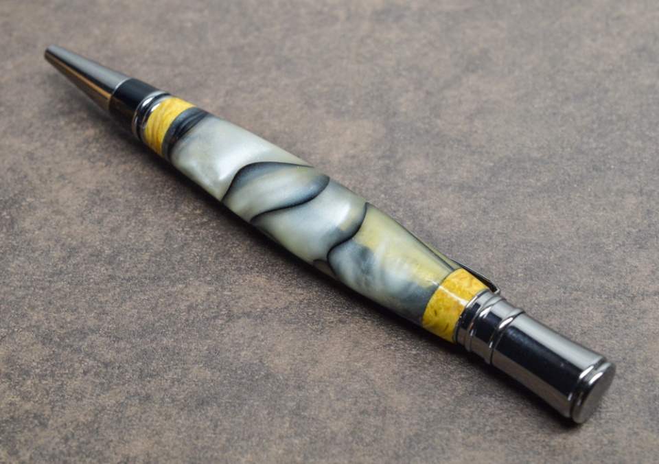

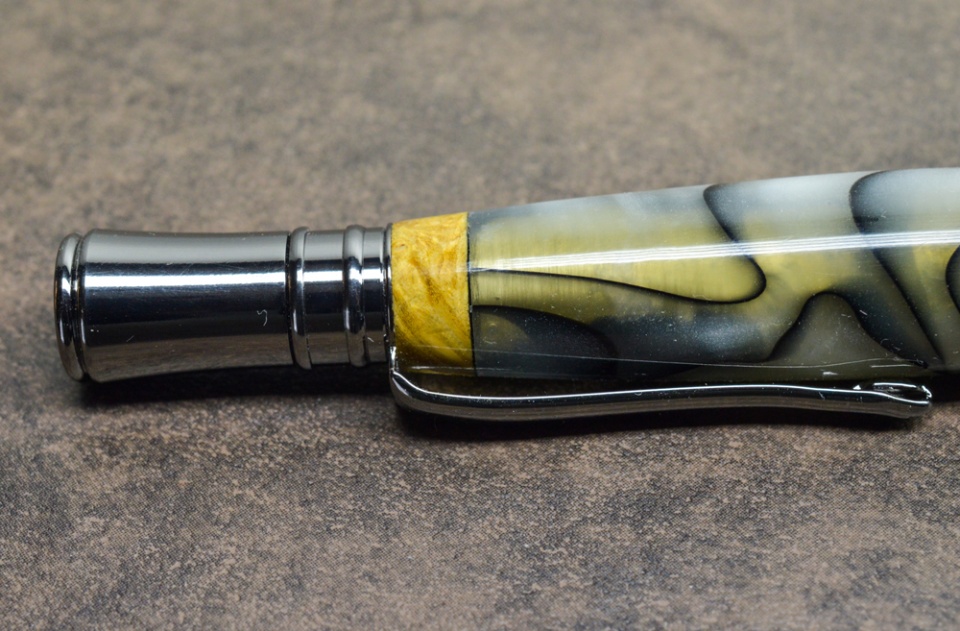

I botched the drilling process probably because I was in such a hurry to use my new drill press instead of using the collet attachment on my lathe. That would have saved me all kinds of problems. The Spalted Pearl or Aquapearl blank was a cylindrical piece that would have fit perfectly in my 3/4 inch collet.
So I cut off 1/4 inch on both sides of the blank then used some stabilized elder burl I had leftover from another project.
As the saying goes "When life gives you lemons, make lemonade"
Thanks to Mal of Magpens suggestions I was able to get a nice finish using the Novus scratch remover and polish. Thanks for the help Mal!
Mark James also suggested I try something like the Executive style pen. Thanks Mark!
Gary

I think you did quite a nice job on that pen.
I am not a fan of the Executive, and I think your pen shows why ... the material ends up too thin particularly near the ends ... and I think we can see the brass tube showing through with that semi-translucent blank.
At first I thought that the blank had some yellow in it and I was going to say that your choice of (perhaps dyed) box elder for the ends was a good match .... but I can say that anyway .... it is !
Painting the inside of the drilled hole in the blank would be strongly advised in future.

Thanks for the good advice Mal. The next time I make one of these pens I will do as you suggest and paint the inside of the blank. The finish came out so nice using that Novus scratch remover and polish I didn't really need the CA glue to finish it. I did put on a few coats just for protection.
Thanks for the helpful advice! Gary

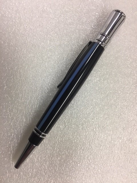

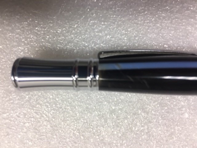

I too botched the drilling of an acrylic blank.. The bit caught and bound at the very end resulting in deep internal gouges. Because the blank did not shatter or split, I didn't realize it until it was turned down very thin to fit the executive pen kit. It buffed up fine.. No external scratches but can see the internal gouges and the brass tube at its thinnest edge.
I have four more to do to complete an order. What I will do differently on the next 4 is, I will cut the blank 1/4 longer than needed so I don't have to drill completely through. Than cut to size after drilling. Also, because this kit requires to turn so thin, I will take Mal's advice as suggest to Gary to paint the inside of the blank.
Live and learn..

I think I like your blank with the subtle graduation towards the center better than the way I did it. Mine is much more pronounced, but it would have shown even more of the brass tube if I did do it that way. I was also thinking that it might be better to use colored epoxy rather than paint for the inside of the drilled hole or the brass tube.
Mal is correct that the Executive Kit does have a particularly narrow shoulder.
Bushing to Tube OD:
Executive: .480" - .410" = .070"/2 = .035" for your final "Material" (That's not to bad... :eek:).
Jr Gent II: (Upper Tube): .567" - .483" = .084"/2 = .042" for your final material.
Zen: .512" - .400" = .112"/2 = .055" for your final material.
Berea Sierra: .474" - .410" = .064"/2 = .032" for your final material.
AND I have made many Berea Sierra's with end caps that did not blow out. I do not disagree in any respect with the thought that the end caps are very thin. But... I believe the problem lies in using translucent acrylic (and similar) vs wood (that has been treated/stabilized with a bit of CA). Thin end caps are fine - with non-translucent plastics, or treated woods... but also a challenge :cool: And yes, properly painting the holes is crucial.
I'm just poking ya!!! (Guess I like itty bitty stuff!) Have fun.
Useful info, Mark.
In the case of the Berea Sierra: .474" - .410" = .064"/2 = .032" for your final material.
I cannot understand why they designed this way.
There is plenty of room inside to make this wall thickness greater.
As I see it, the problem must have begun with the first Sierra twists and never got addressed.
The twist mechanism in that kit is unnecessarily bulky (large diameter), and a redesign would solve the problem ..
There is really no need for a tube diameter of 27/64" nominal.
Maybe at the time of the original design there was such a need.
But not now ... look at the Majestic Squire, for example, with brass tube of 3/8" nominal and let's say 0.370" actual (don't have one to measure)
........ Majestic Squire: .495" - .370" = .125"/2 = 0.0625" for final material ..... to follow Mark's format
That's a big improvement in this regard over any of the above.
I even am confident it could be improved by a few thou. more.
So why hasn't the actual Berea Sierra Twist (which many copy ) been redesigned to overcome the end-material-thinness problem ?
That's the biggest problem with that kit, IMHO.
