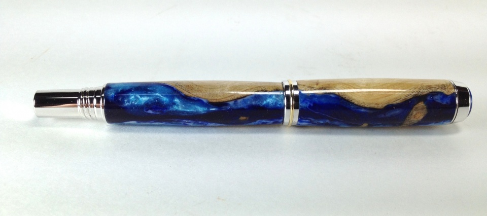

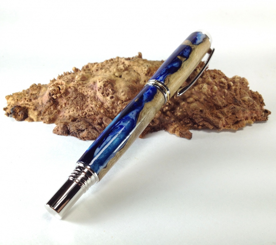

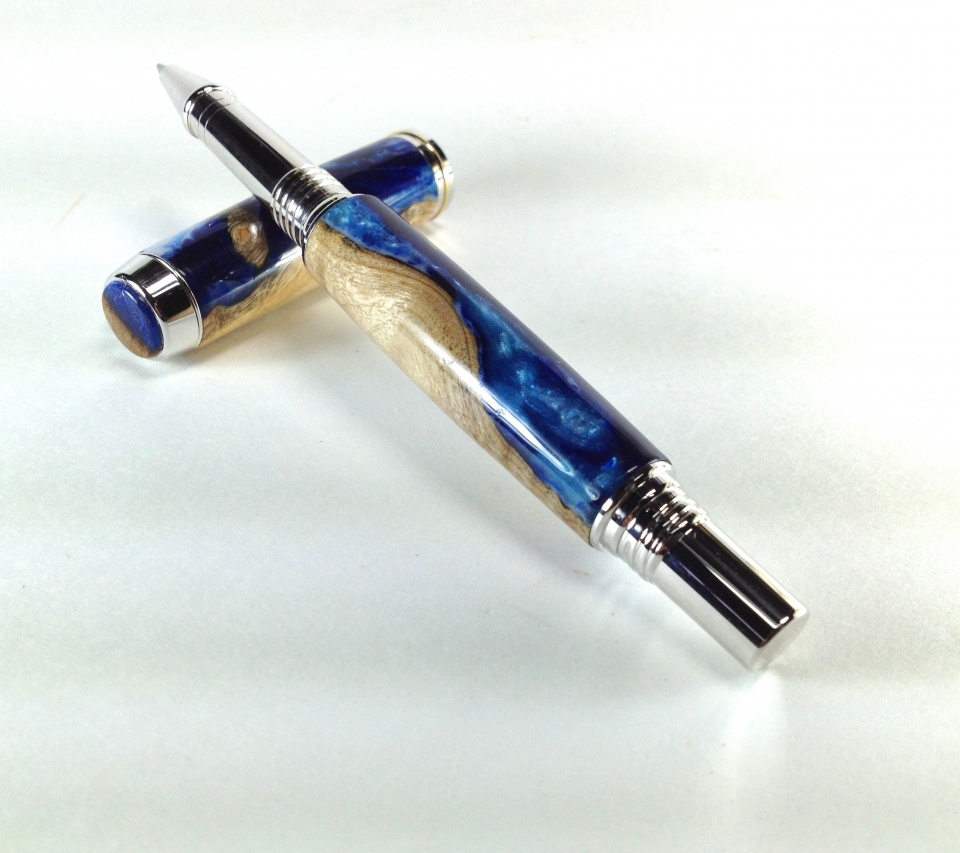

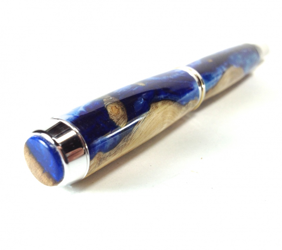

This is a Wayne Ryan Blank I've named "Aqua Burl". Wayne does such a fantastic job on these blanks. Tubes painted a light blue, with custom finial.
