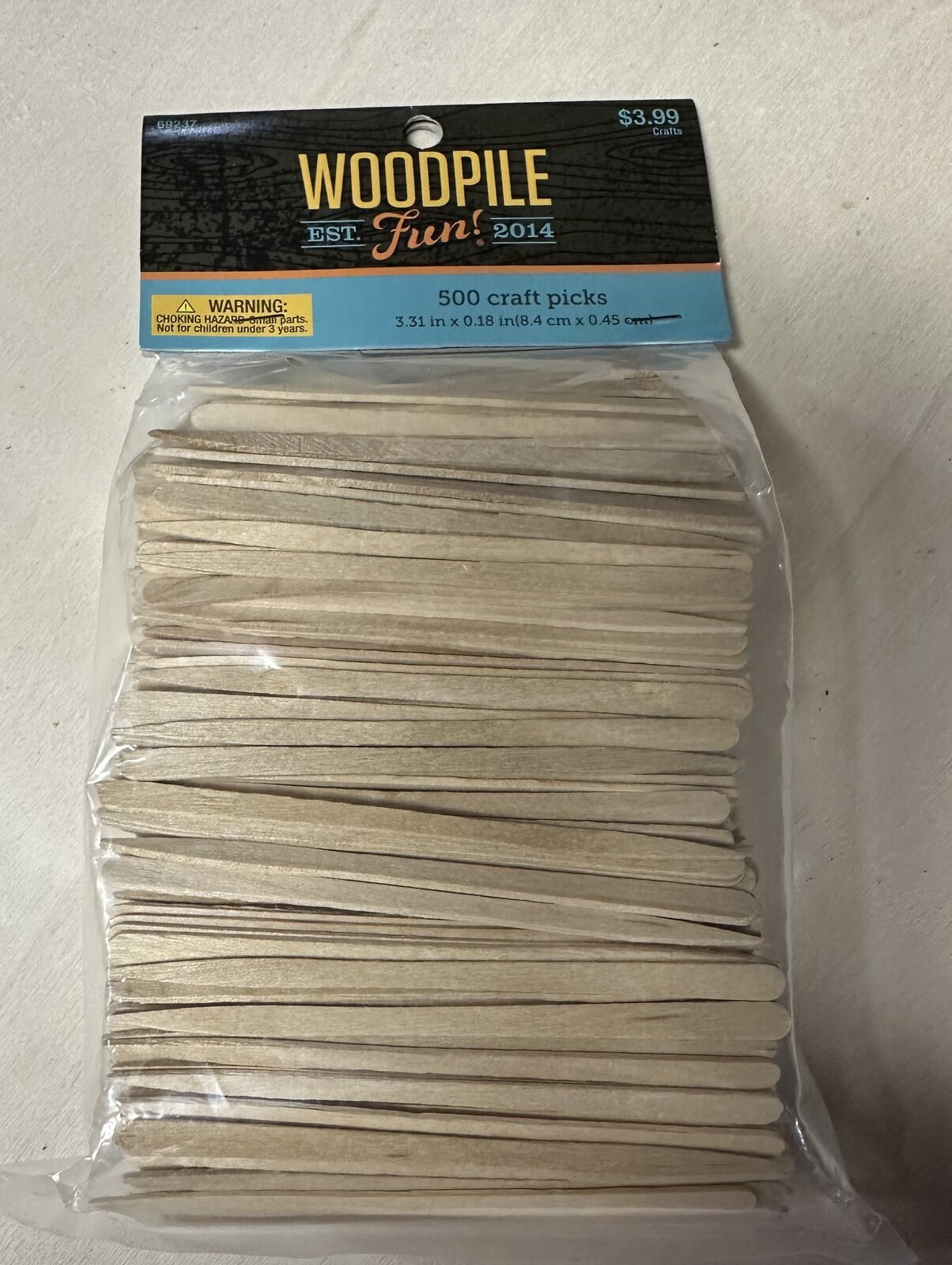

I buy these at Hobby Lobby, 500 pieces and they work great.
