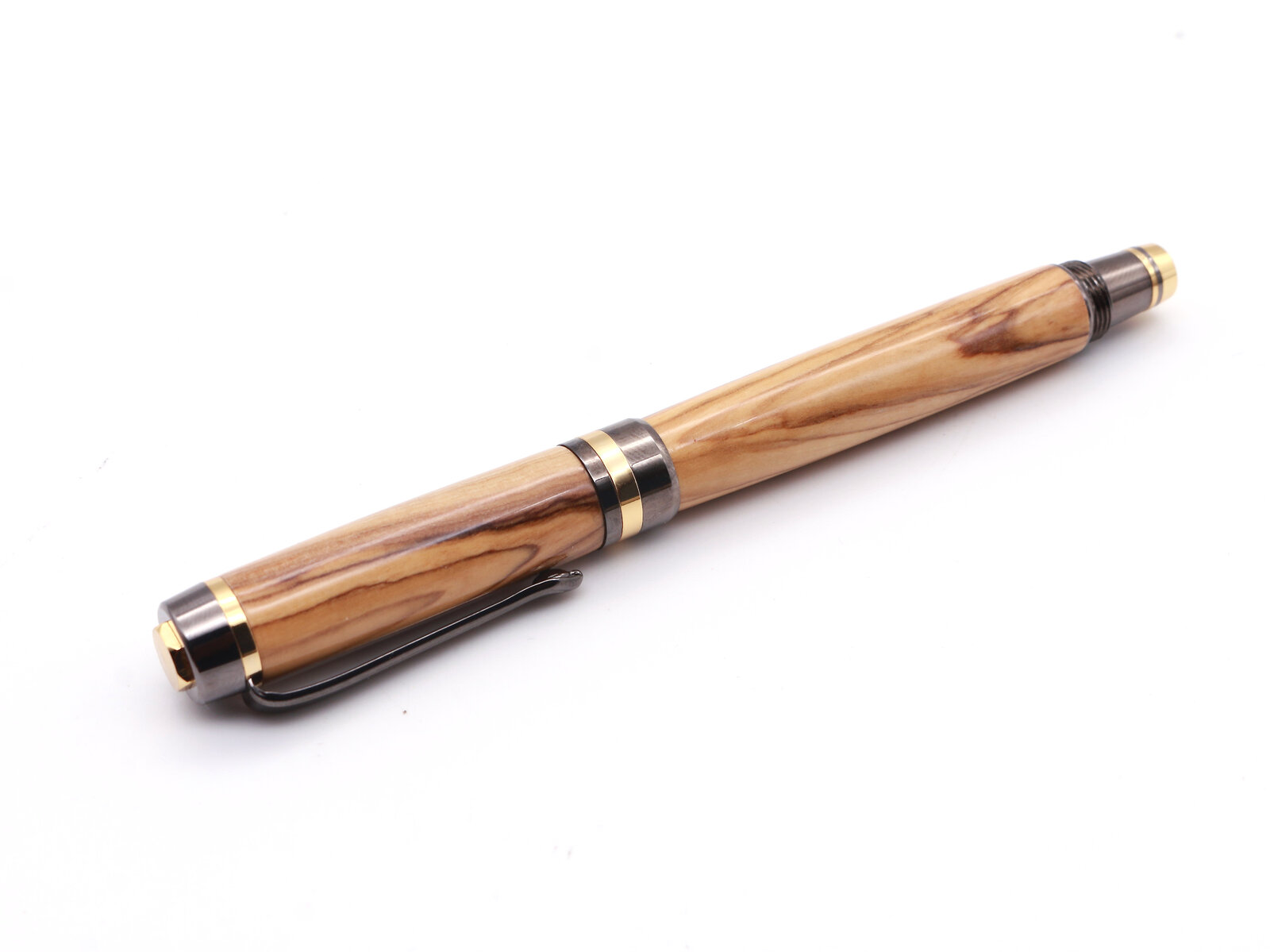

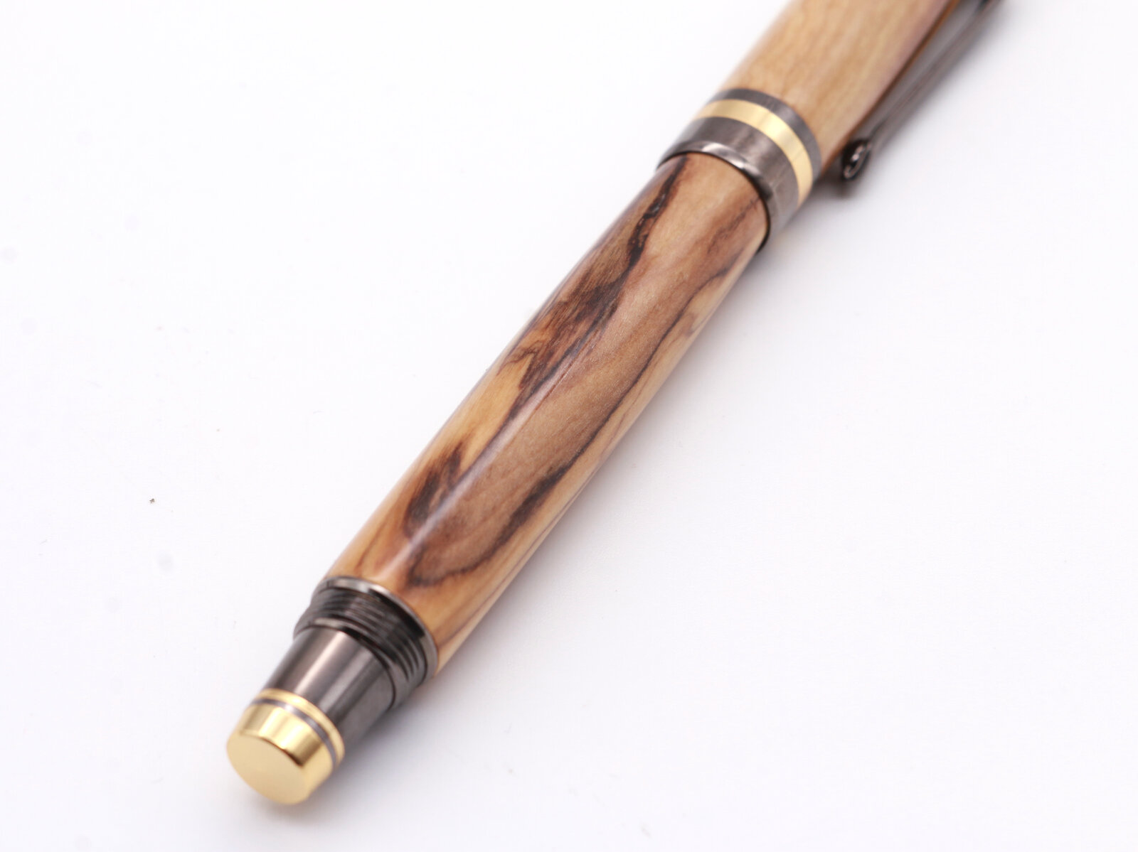

You can look on this site for CA finishing... For Olive wood... it is the same. Here is an Olivewood I did recently with CA.

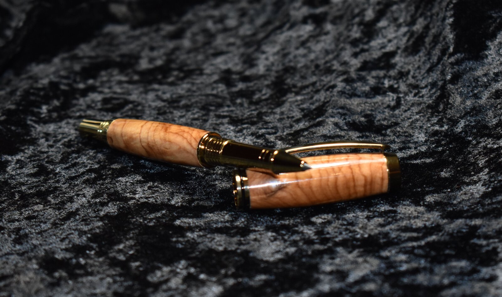

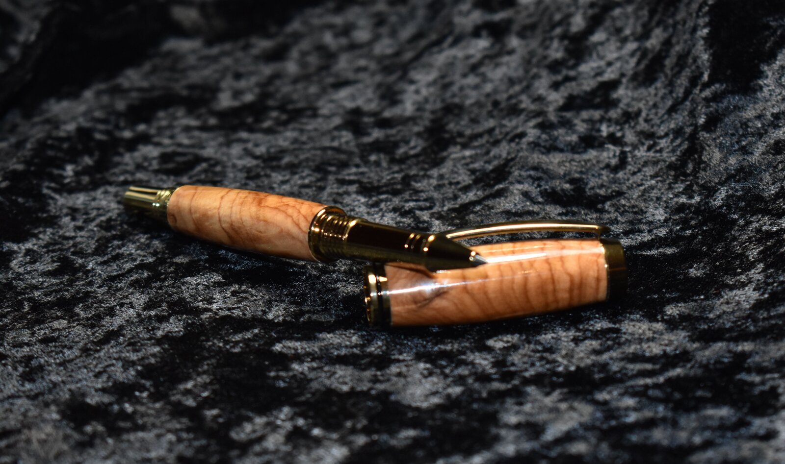

I turned this olivewood pen before the lockdown here in Malaysia. I actually loved it sanded without any CA but decided to anyway.
I used maybe two coats of thin, one coat of medium CA.

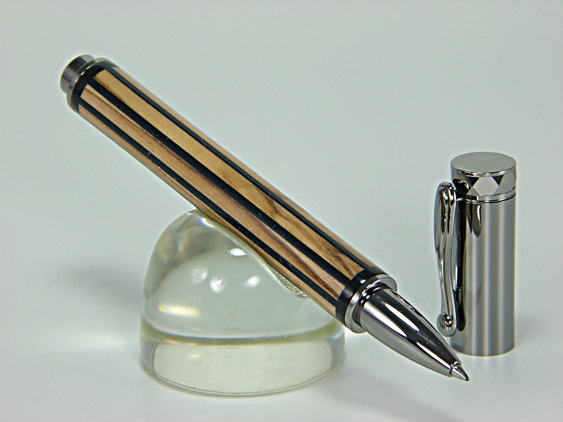

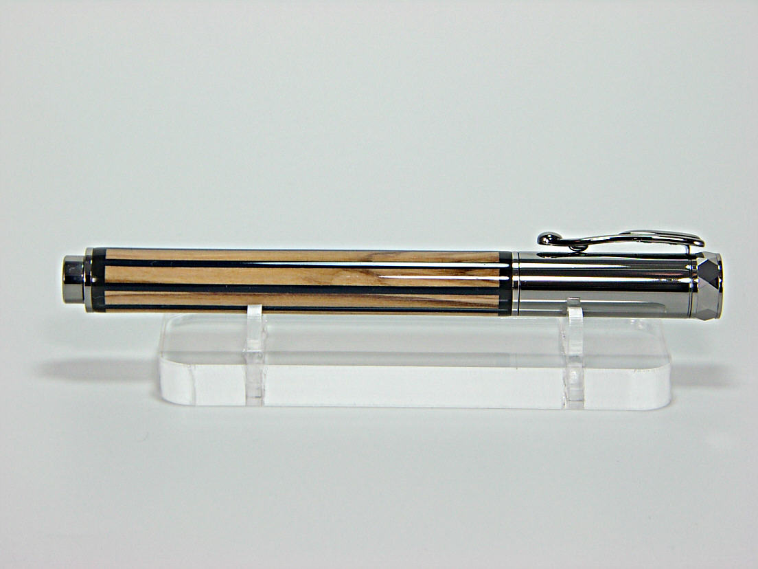

I have made many pens with Olive wood and treat is as any other wood when top coating with CA. I never use thick CA. I put 3 to 4 coats of thin and 3 to 4 coats med. Then sand and MM. Now I do not take photos of all pens I make but here is one segmented with black acrylic Zen. Treated the same way even with the acrylic.
