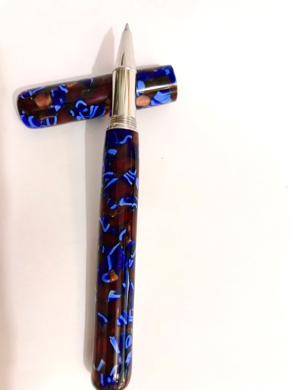

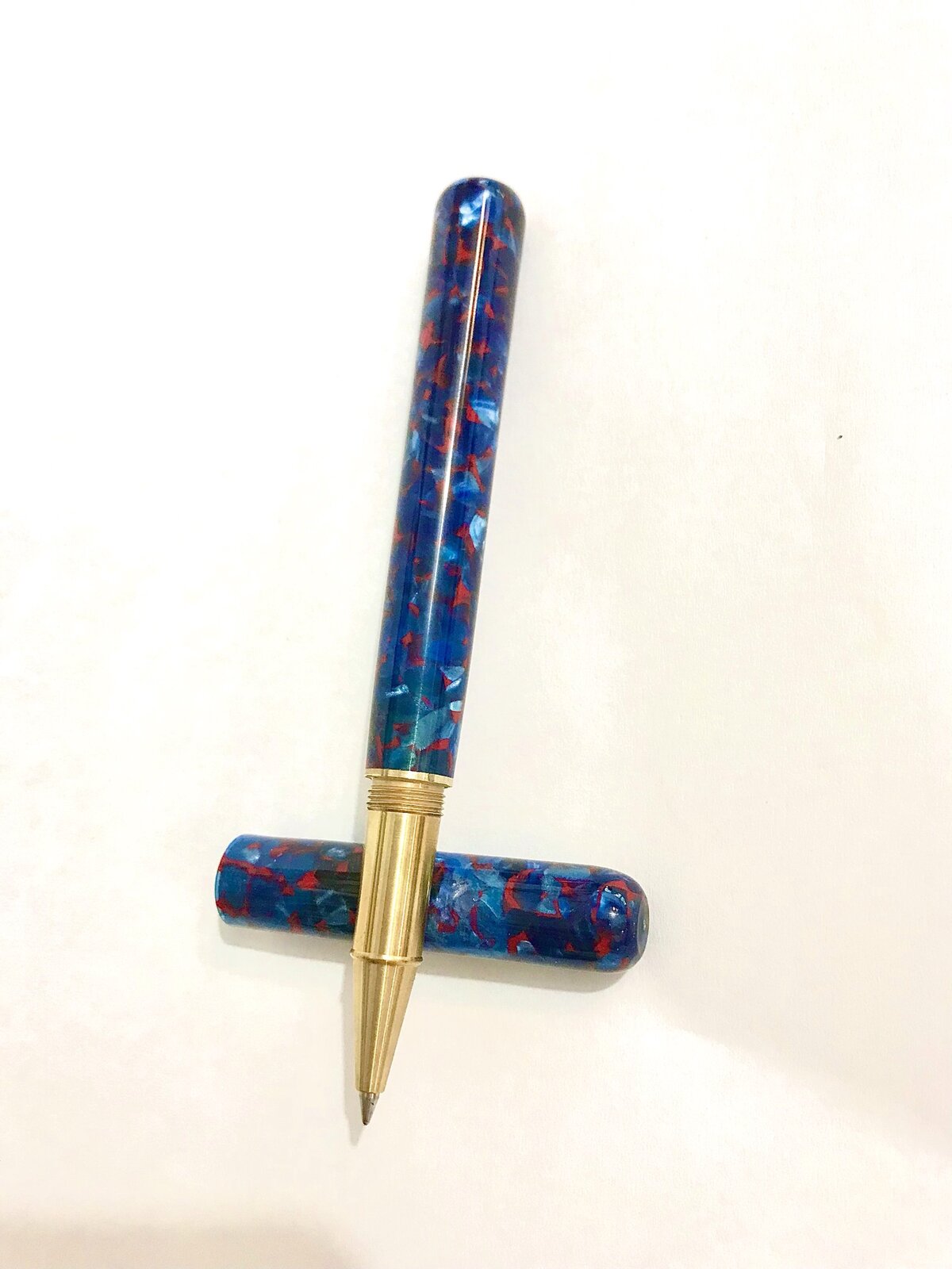

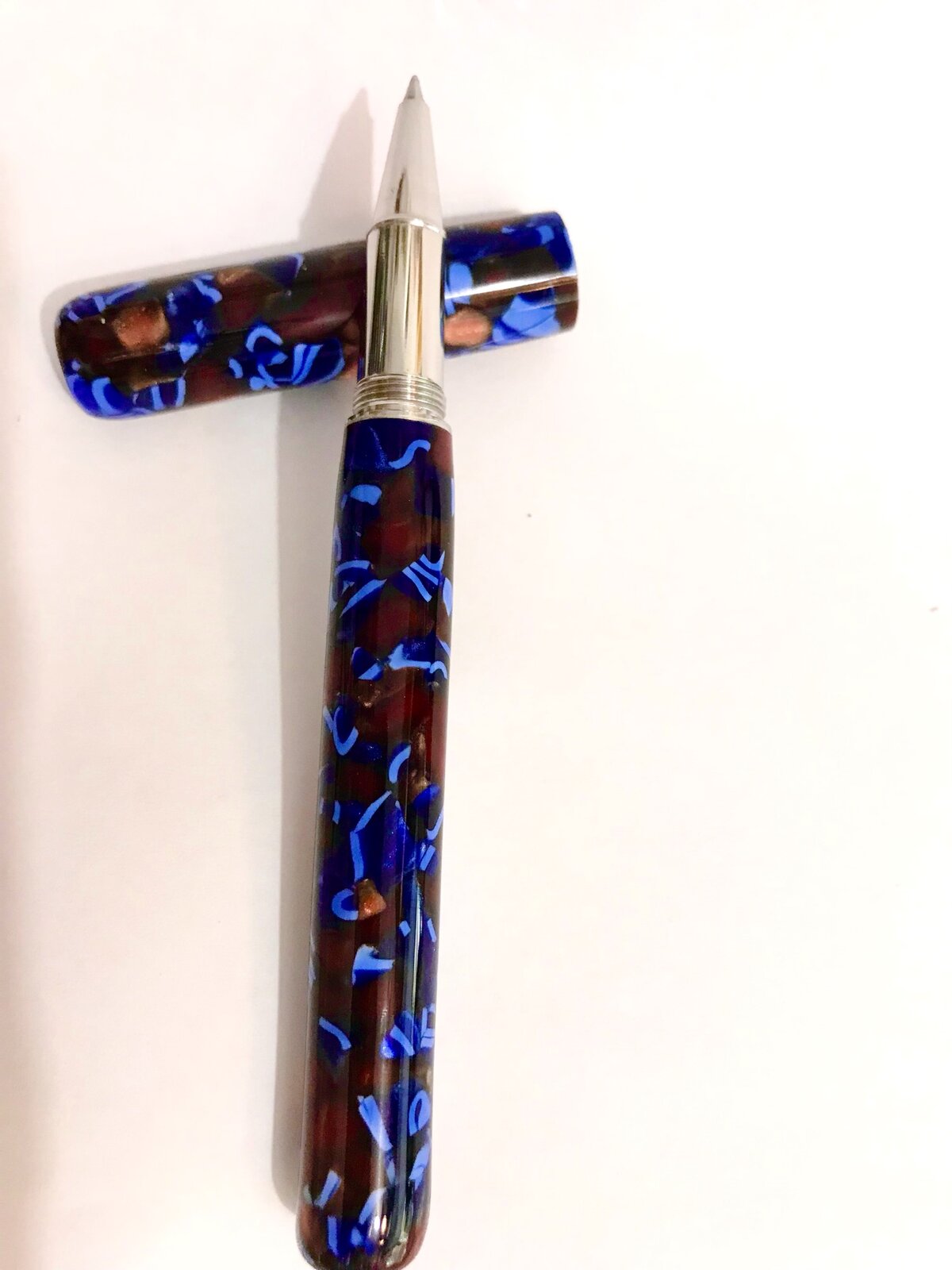

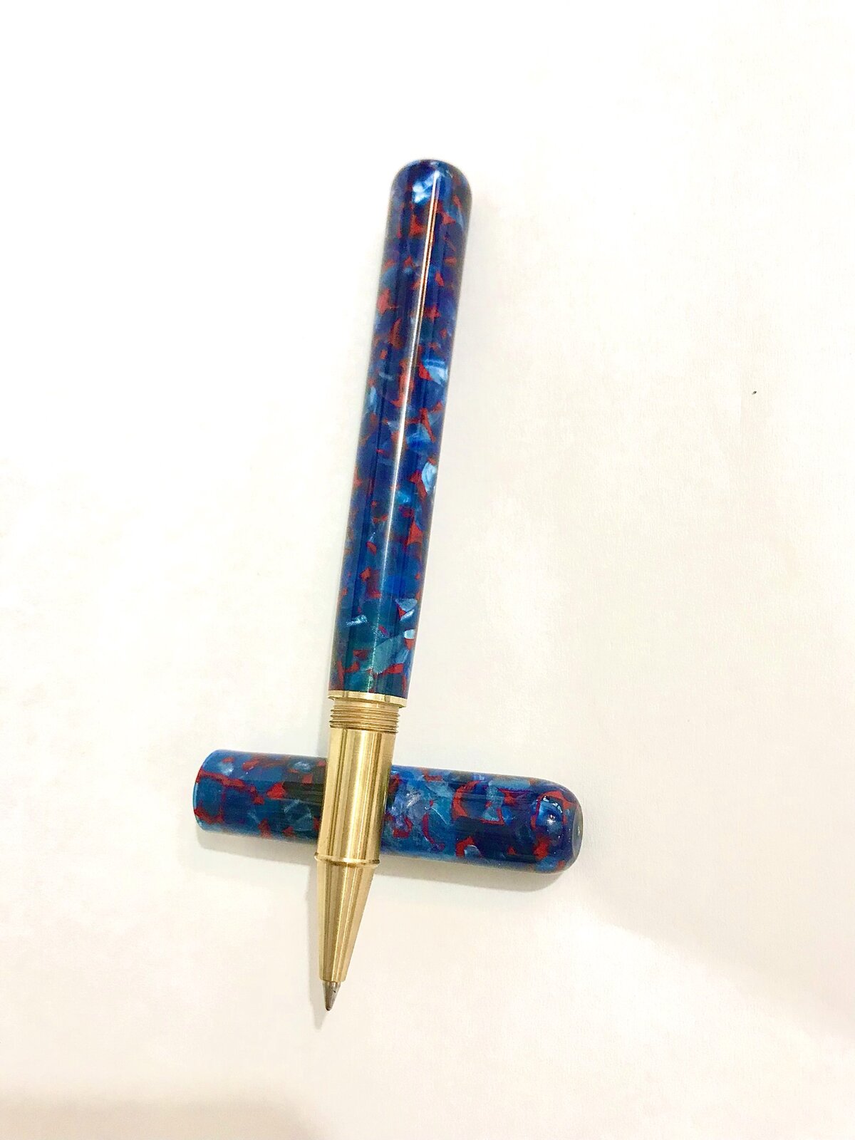

I have made many Apollo pens both ways, regular bit and Stepped bit. I really like the stepped bit with the Apollo. I use wood lathe also with no problem
