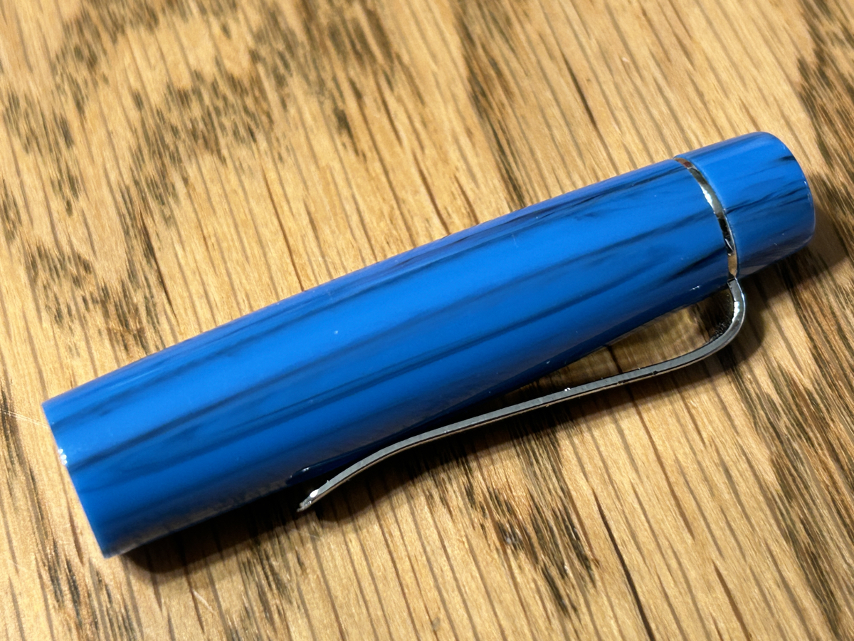

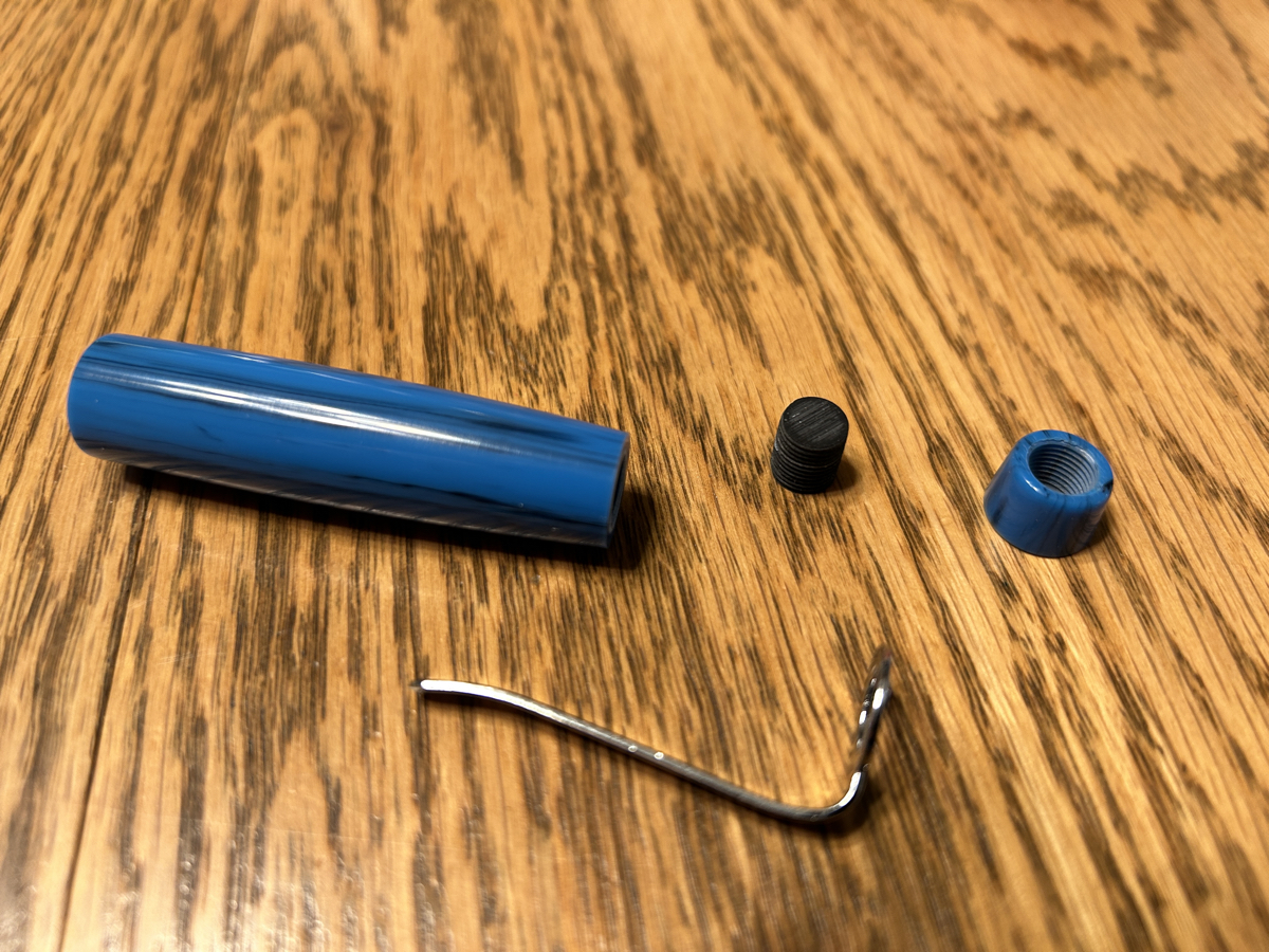

Hey Guys,
I know some of you are making Apollo pens from Bullseye... do you ever wish it had a clip? I do, or I should say, I did! This morning I experimented with adding a clip to the Apollo. Besides the clip, it also required making a set screw M8x0.75 and a finial. This one happens to have a hole in it. I could plug it maybe, by making a longer set screw, and sanding it flush with the finial. What do you guys think?

On Facebook Marc Werner suggested just using a tenon and pressing it in. Seems to me that would work also!

That look great! One thought - could you have made the finial w/o the hole in the top and then just screwed it on top of the set screw? I think given the current finial I would, as you mentioned, make a longer set screw and sand flush. I think once it's polished up the black set screw sanded flush would look good with the blue.

Hindsight is always 20/20. I was not planning on making a finial out of that blue blank. So Kate's instructions say to cut the blank for the cap to 2.5" long (I cheat, I cut it to 2.625"). Then I drilled a hole all the way through for the M8 set screw... Then Kate said, cut your cap down to 2.25" long. So I did, and let the scraps fly where they will.
A short while later I said, I need a finial. Hey wait, where did that 3/8" piece of scrap fly to? I found it, and it became my finial.
Next time I won't drill the hole all the way through! Haha!
Mike...

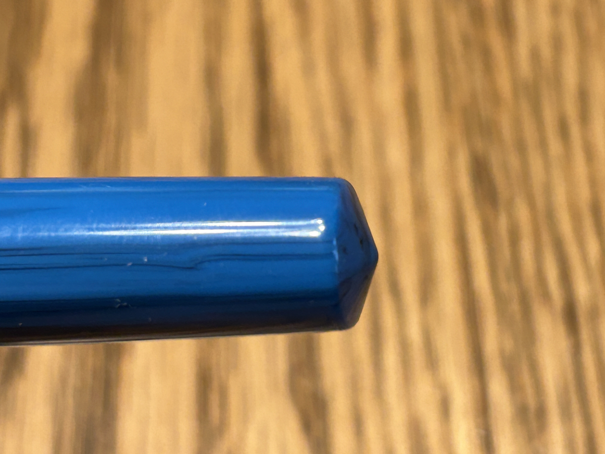

Why not thread a finial tenon from blank leftovers or other attractive blank & eliminate the setscrew?
What you've done is attractive in itself. :)
Well, the setscrew was turned from alumilite, but it could have been turned from anything in the garbage can. And yes, whatever it takes to make the pen pretty... especially if it pokes through the finial!

AH - gotcha. Like @mark james I have one of these ready to turn - I just haven't got to it yet. Sounds like there is a step or two that could be consolidated if one wants to go this route. I do think the black will look good sanded flush and polished - or - you could even put a slight dome on it
I like sanding my 10 degree finials on the bench sander... quick and easy, so your idea of a dome would become a 10 degree finial! Haha!

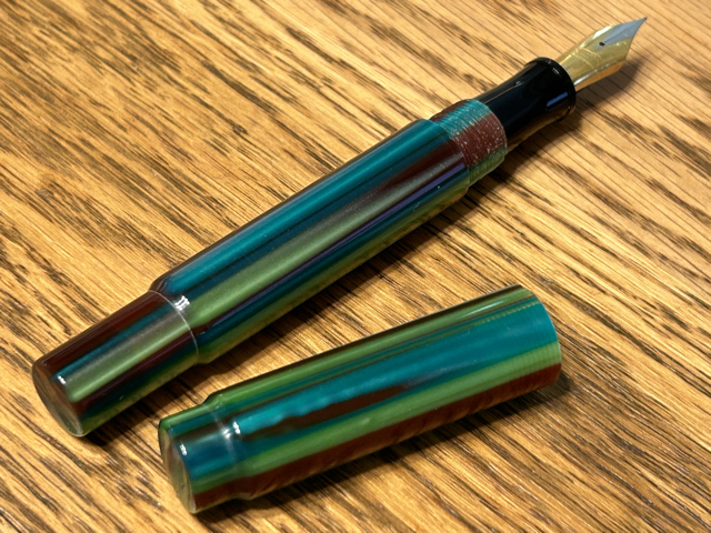

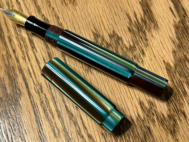

Hey @InkyMike
My first pens were squared off, kinda like this. I like the 10 degree finials better.
P.S. You should add a few photos to your website so I can see what you are making! ;)
I like the look of that, but I can also see how the 10 degree would look great as well.

Hey @InkyMike
I made a pen with squared off ends today... I see your point! The squared off ends look good too! ha!
