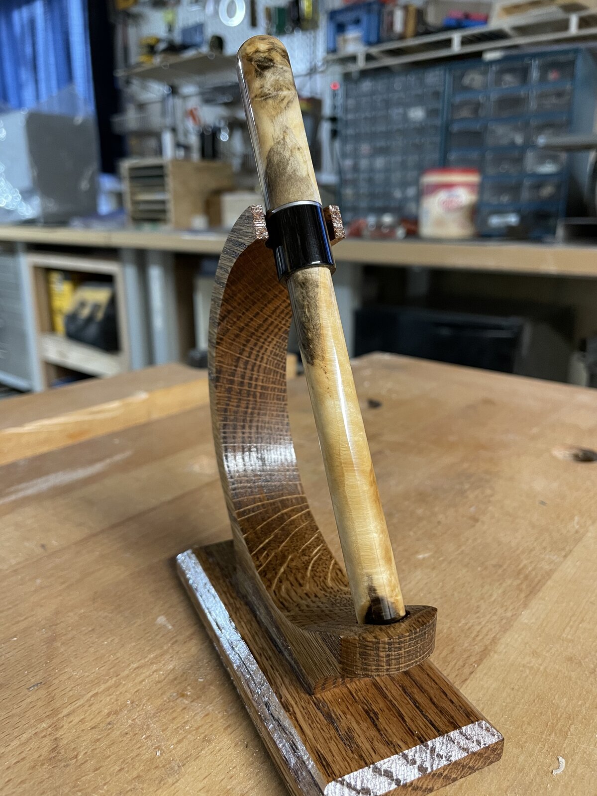

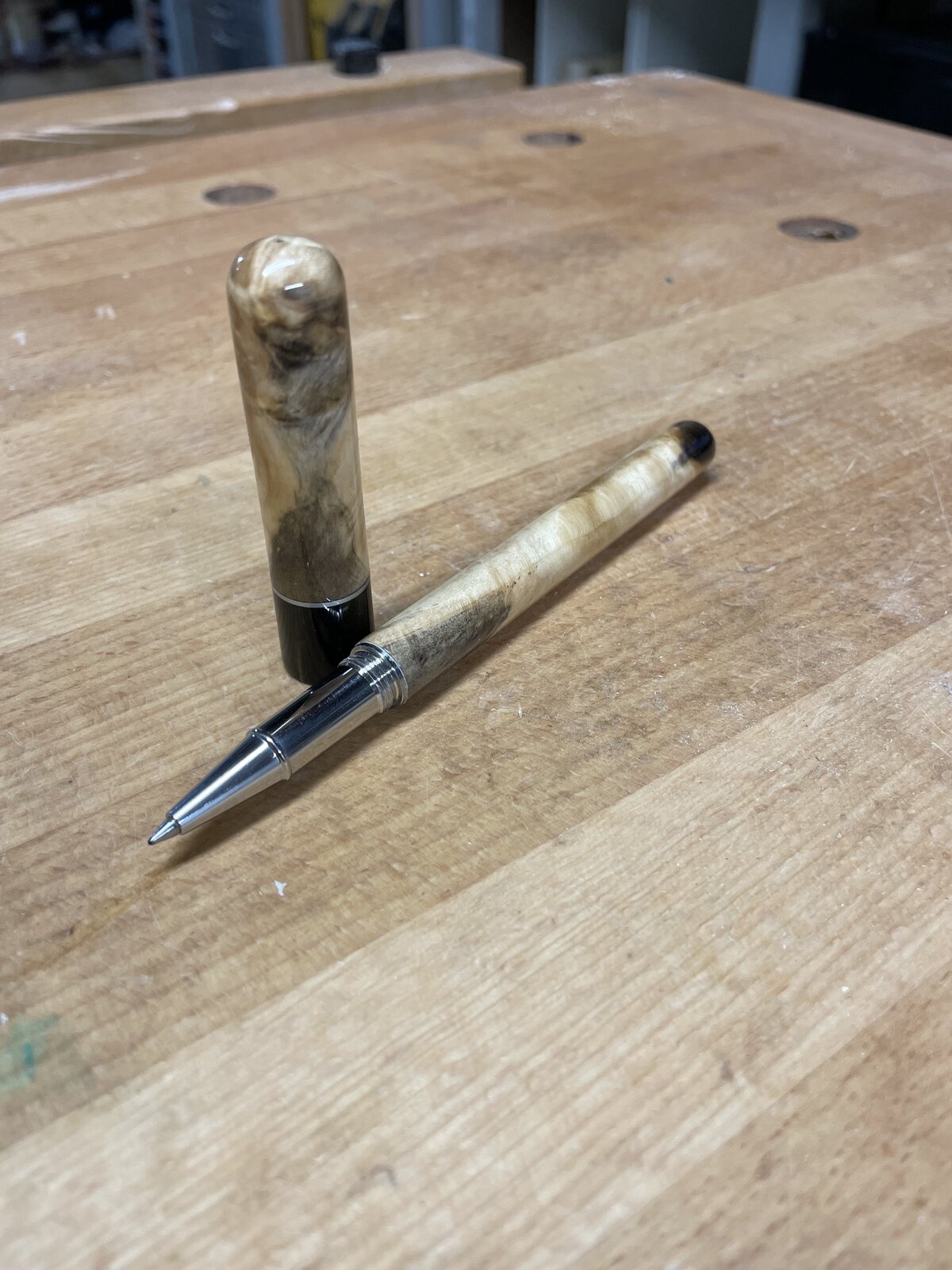

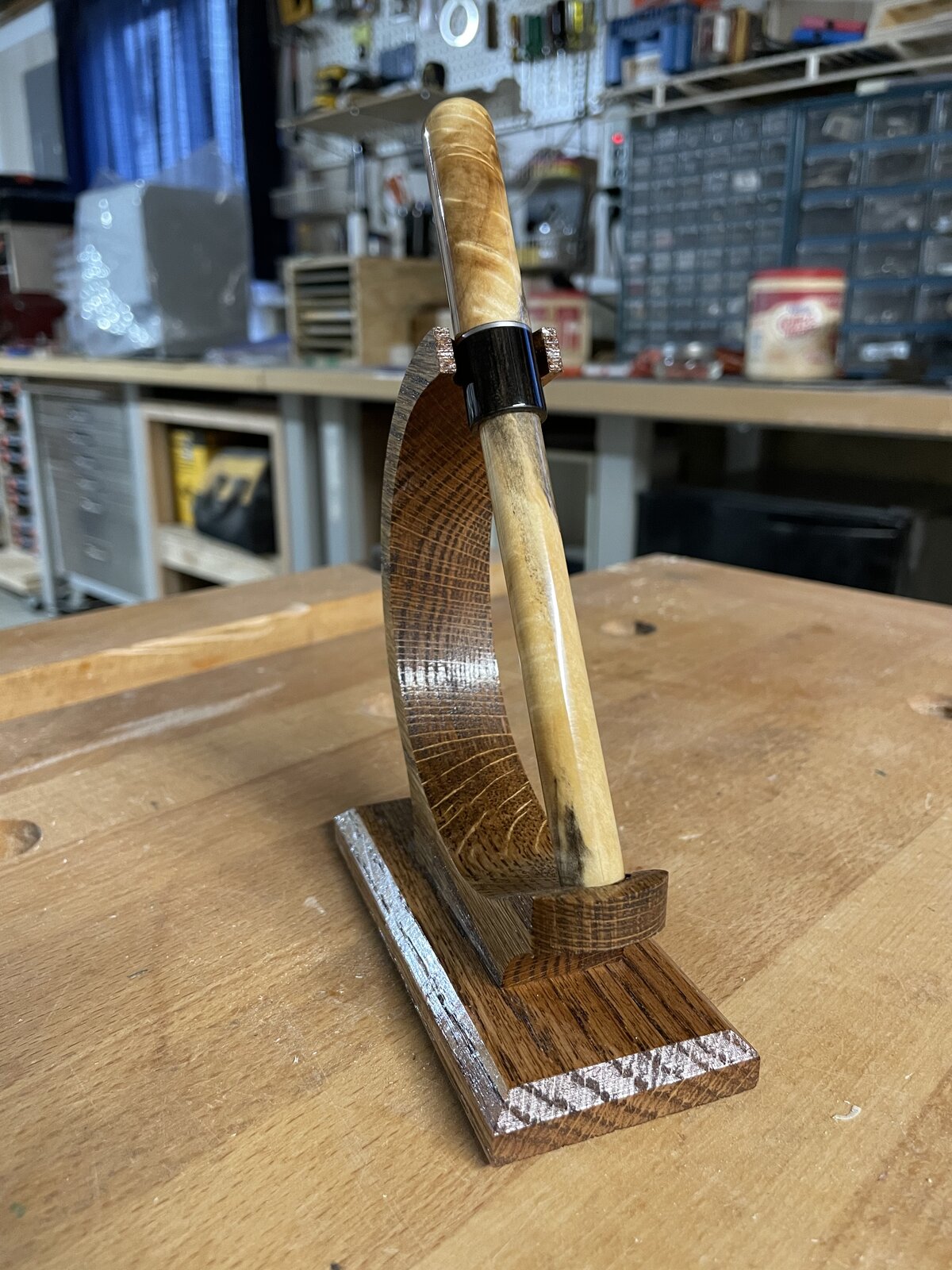

Stabilized maple, Gabon ebony, aluminum spacer Glu Boost finish and my shop helper.
Is that the pen kit from Bullseye ( FP version ) ?
Great pen Ken! Nice shop helper. Does he/she help drill blanks on the Laguna? On a side note, did you make the larger hand wheel on the headstock? I am still trying to get used to the stock handle on the Laguna, and I think a larger diameter would be nice.
Yes, that's the one. Very fun pen to make. I bought the roller ball ones though.
Yes, that stock handle was the only thing I didn't care for on the Laguna, so I just used a faceplate and made my own.
Very Nice Pen Ken! I bought the fountain pen version of this and have been having a few issues. Following the drilling instructions and drill sizes given resulted in a very sloppy fit of the inserts (yes, I checked my drills and alignments). I've since abandoned the instructions and switched to measuring my drills closer to actual diameters of the parts. I found that my measurements reduced the drill sizes a fair amount over the instruction listing. Curious if you or anyone else found similar things. I do like the pen kits - nicely made and as your pen shows, make a nice piece...... I was not expecting the instruction issues.
I have not run into any issues. The fits are so good, I have to drill a small air relief hole in the bottom of the threaded insert. I believe that is in their tips sheet. Are your holes for other kits on the sloppy side?

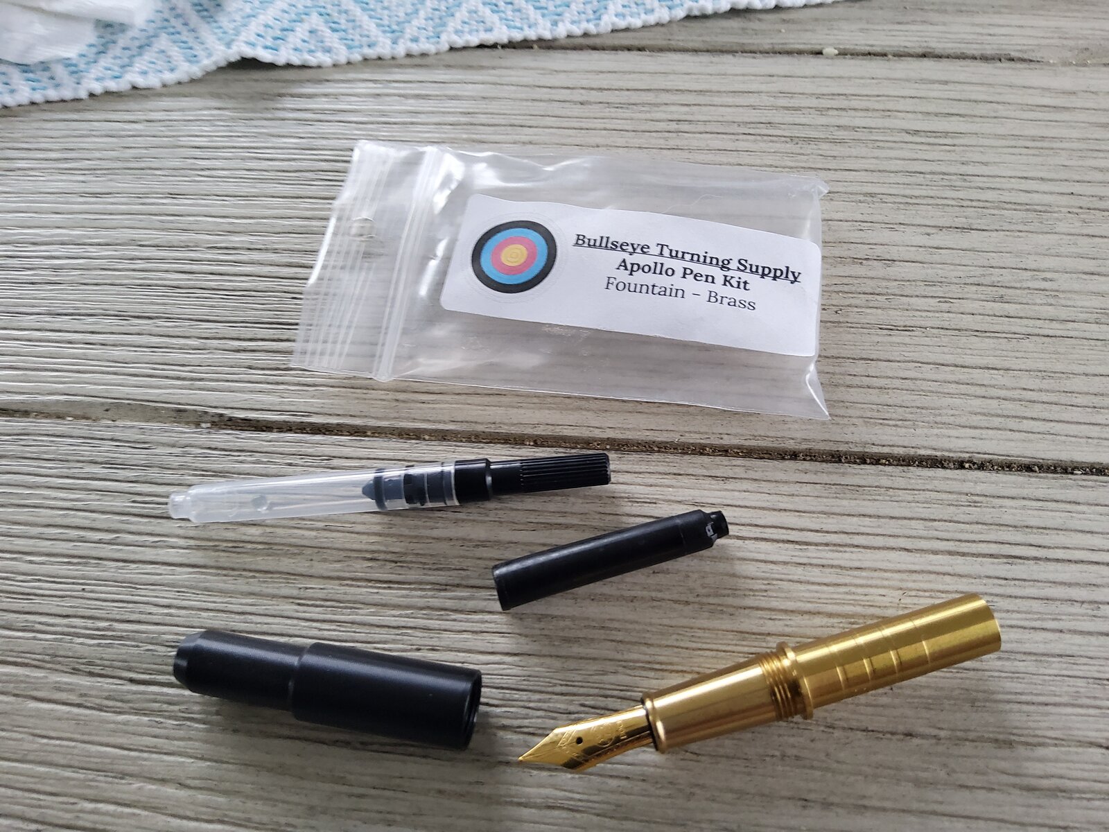

Mal, one side is black plastic, one side is metal, one gets glued into the cap, the other into the body, very simple design to make. I have only made the rollerball version, I am assuming they assemble the same way. I'm sure Kate can answer you in full detail.

Mal -
Kit - nib and section of brass are in the body. Pump and ink cartridge are provided. Black plastic is cap insert.
Triple diameter drill is in body, double in cap.
Kevin

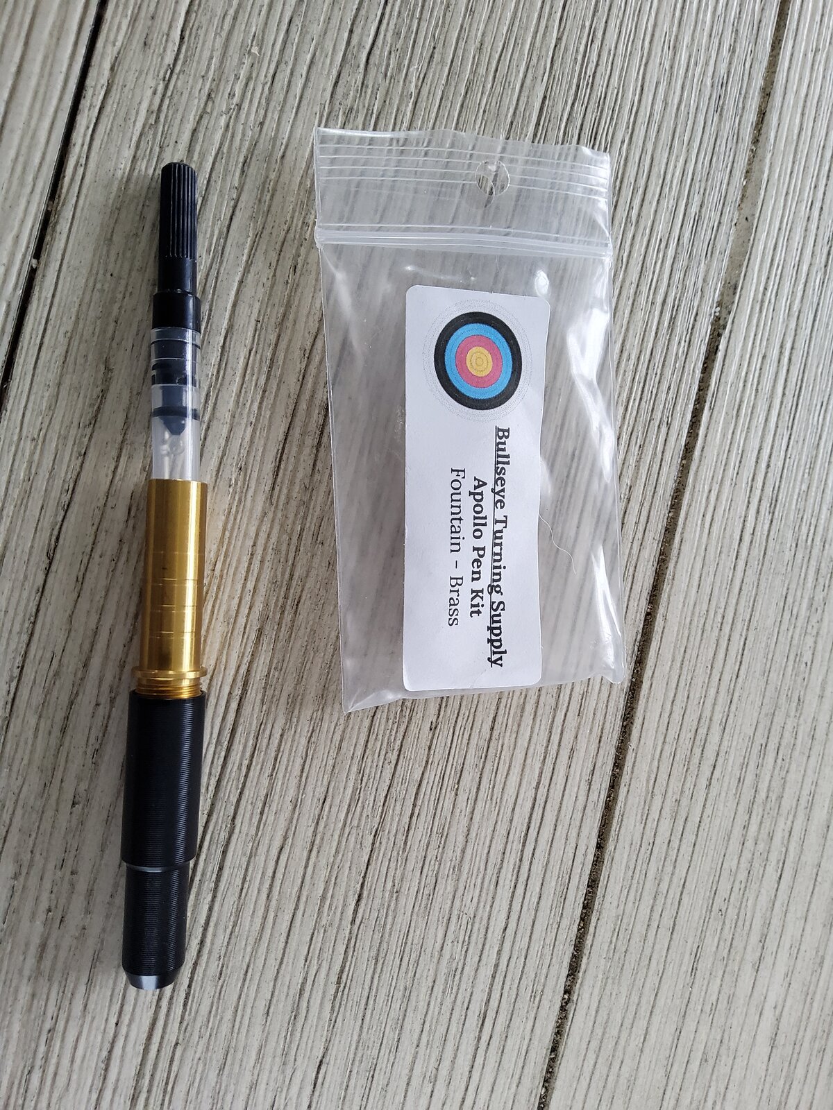

And here is the thread of cap section into body section per instructions. Pump in place. Shows three diameter drilling requirement in body and two in cap pretty easily.
Kevin

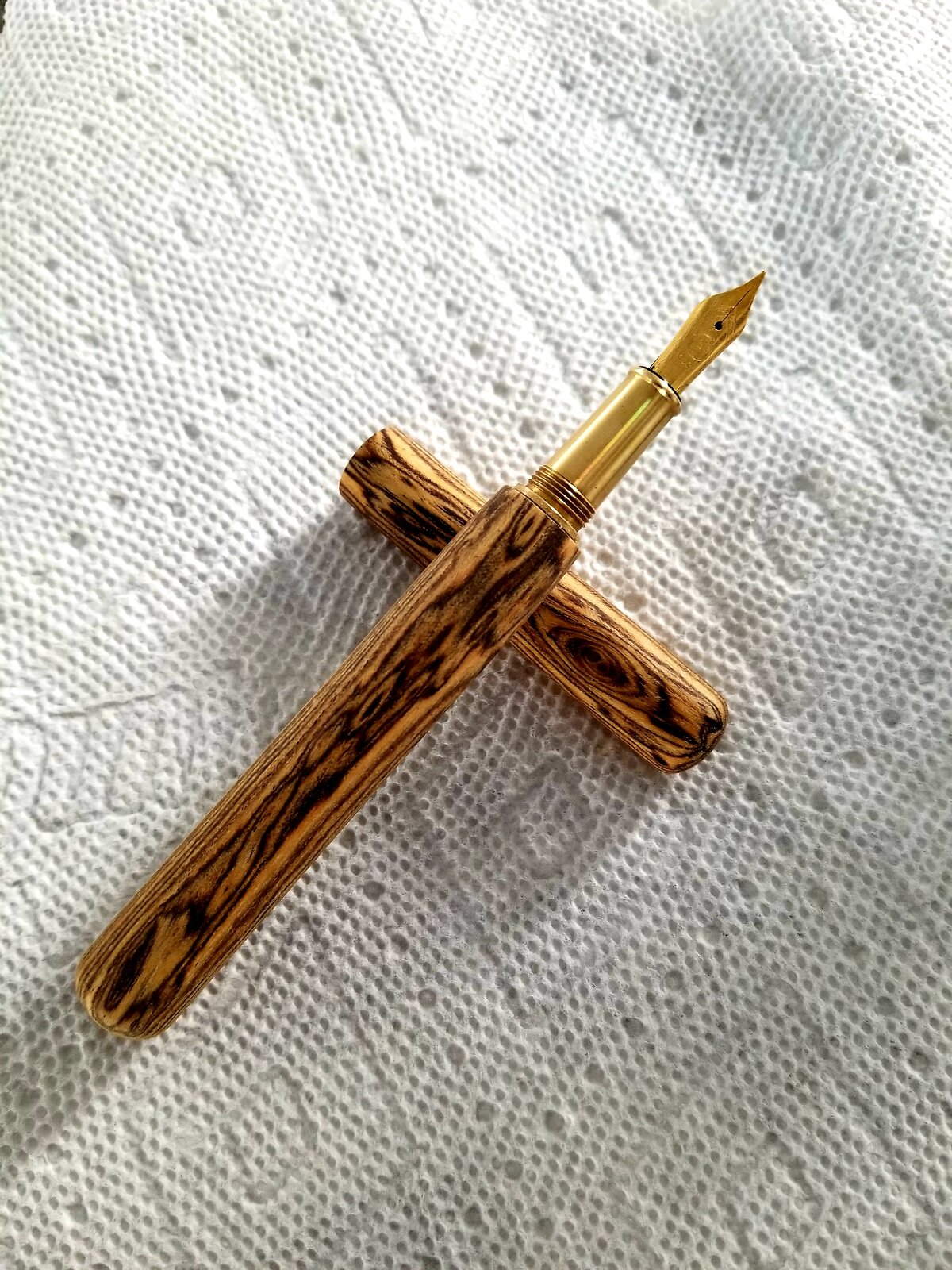

To end the saga of my creation of an Apollo fountain pen, thought I would post one of the pics here as well as the others in the show area. It's Bocote Wood on a Brass Apollo fountain. Finish is Glu Boost. I am pretty pleased with this as my first attempt at this kit. I have a couple more of them that I am going to try doing some customizations to the kit, but wanted to do this one straight out of the baggy.....
Very nice, the wood you chose goes very well with the brass hardware.
Thanks Ken & Jim!
I wasn't sure about using the bocote with the pen because the color was good, but matching the lines and coloring of the grain between the cap and body is always a large challenge. These kits do not have triple start threads on the cap/body connection - they are single start, so the match became much simpler!
Kevin
