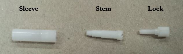

The directions list it as a "3 piece mechanism" and the kit only had a 2 piece mechanism. There was/is a white plastic piece with a threaded end on it that fits inside a white plastic tube. I don't know what the 3rd piece is supposed to be?
The kit instructions look like what I consider a standard PSI click mechanism. You have the outer white tube, with a threaded plunger inside. On the other end, there is what I can best describe as a lever that actually is what makes the mechanism function.

Thank you sir for your reply. Tech support from PSI returned my e-mail yesterday. They are sending a new click mechanism. I am missing the plunger.
They sent me a diagram with detailed pictures of the click mechanism. I am going to attach the diagram and pictures tonight after work. It's good information for somebody with this same problem.
Not to mention, the instructions that are included with the Apex are lacking. They don't detail the mechanism at all. Also, since I only had two pieces I couldn't tell how to orientate the white tube since it is different on each end.

Here is a picture of the three piece click mechanism.

Completely different click mechanism than the one PSI uses on the Vertex and Stratus pens (and maybe others). Thank you for taking the time to post the photo - if you had an issue with the mechanism, someone else did as well and hopefully the photo helps.

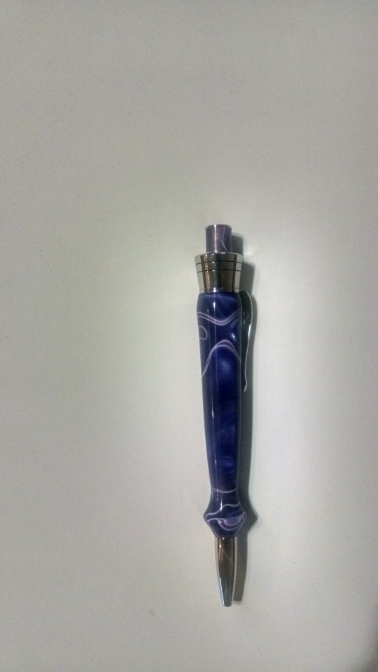

Well, I got the clicker mechanism back from PSI. Got the part installed and the pen barely works. If you click lightly the pen works fine. If you click too hard the refill will poke out through the nib too far and stick. Not sure whats going on.
I don't see any damage to any parts, so I'm not sure what went wrong. I most likely wont buy this pen kit again, though it could easily be my fault I suppose.
I made a "long clicker" for my wife and I much prefer the click mechanism in that pen to this. Also got a vertex and I think it will be better too.
Oh well.

Well, I think it sorta smoothed out on its own. I took the refill out and checked the spring orientation and put it back together. I was a little rough for a while but started working better.
It's not super smooth by any means, but that could be because I had to assemble and disassemble the pen several times to get the click mechanism out and re-install before I figured out it was missing a piece of the mechanism.
I won't be buying a click pen that has a click mechanism that needs to be assembled. The other click pens such as vertex and long clicker are very nice and aren't as difficult and have very nice clickers as far as I'm concerned.
