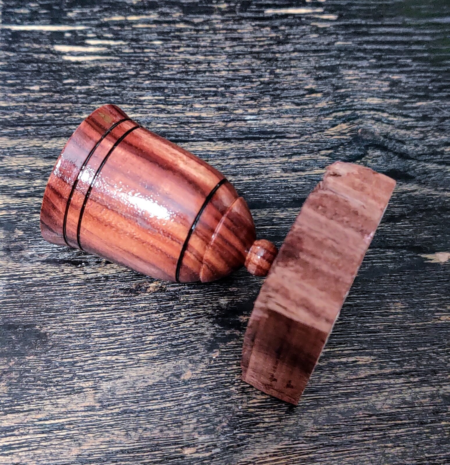

Here is an example of a shiny bell ornament finished with MinWax WoP. This was one of the cases where I had some problems, and it took a couple of weeks to actually dry properly (and there are a few spots on the inside that are dull that need fixing still.) This is two coats...I'm thinking I'll do a third, since I need to fix some spots on the inside. (Sorry for the bad quality...phone camera...)
Anyway...this bell, along with one other, had what I think were a few issues that caused the drying/curing process to falter. First, I had already finished a number of other bells, all matte, and I decided to make the last two shiny. I didn't re-mix the finish, though, and it had been sitting for a while. Further, it was quite cold that day, so the finish was sitting, unmixed, AND cold, and it was applied cold. Worse, I originally left the two pieces outside, where it was cold, so it was drying in the cold which also extends the dry and cure times.
I eventually brought them in, but I don't think I had a proper mix of solids, oil and volatiles in what I actually applied, so on top of the cold application and initially cold drying environment, there was that to contend with. In the end, it took a couple of weeks for them to fully dry. The other bell actually took even longer, and I accidentally ended up putting a fingerprint in the coat it had. I ended up blotting that out, but ended up with a dull finish as a result. So, both bells weren't the best application of the finish...although in the end, they did still dry, and the finish on this one is shiny, and properly demonstrates the effect of applying WoP as described above so it stays shiny.
