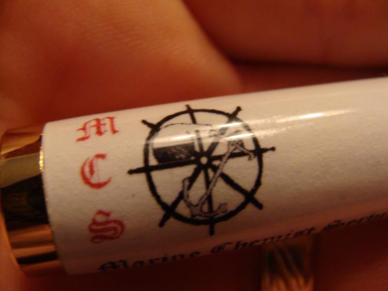

I did these for a company for Christmas time.
