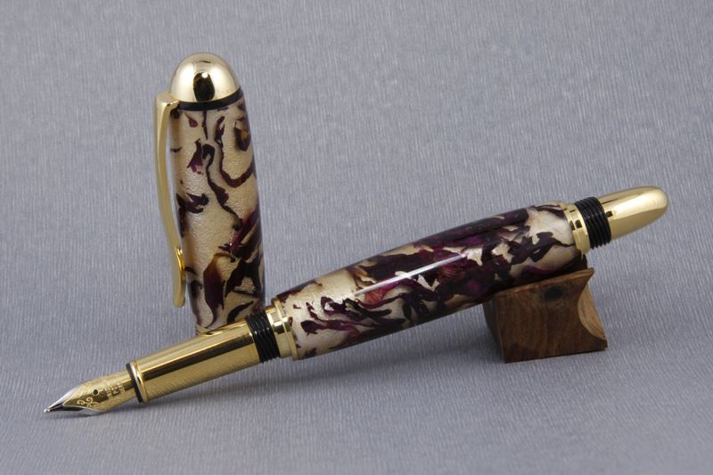

This is a cigar where I used a spray pearl paint through the hole followed by a brushed on/in acrylic gold paint then used thick CA to adhere that onto the unpainted tube.
I did that using the standard 10mm drill bit. It was snug but better that than sloppy, IMHO.
GK
GK
that is a cigar? Where did you get it?
DOHHHHHH
That is what I get for posting in a rush while my wife is calling me from the other room. That is a sedona.
But I did make cigars with multiple layers of paint using the original 10mm drill bit.
Sorry for the confusion!!
GK

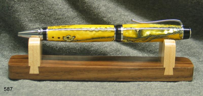

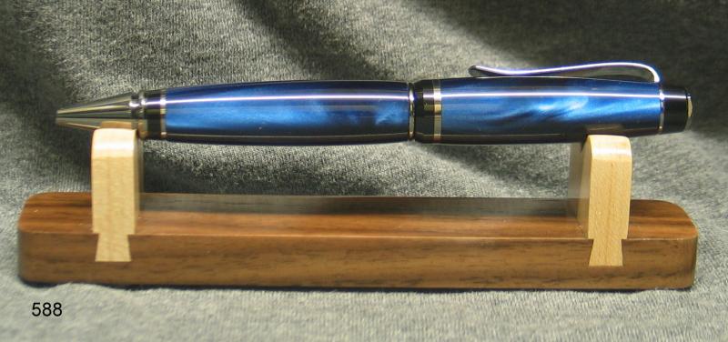

I tried the 13/32" (10.3mm) and seems to work ok. I use epoxy to glue in the tubes which also makes up some of the gap. Couple of freebie blanks using the 13/32" bit and reverse painting the blanks with acrylic paint (Yellow Jacket from Ernie at BTW and Madreperlato Royal Blue from Dawn & Ed):
