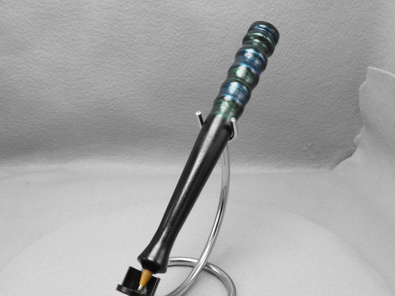

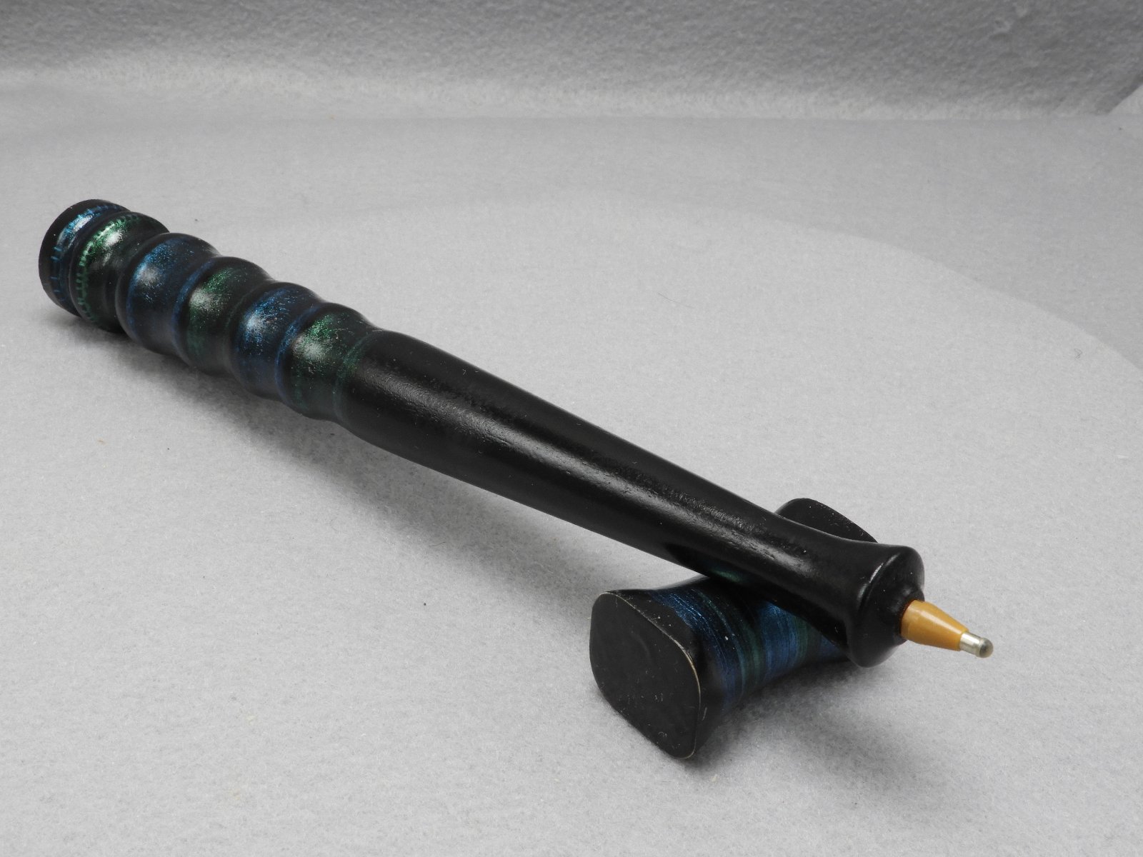

Here's some I did. I wanted to replicate the original design. You could shape it in any form you would like.
Played with the concept.

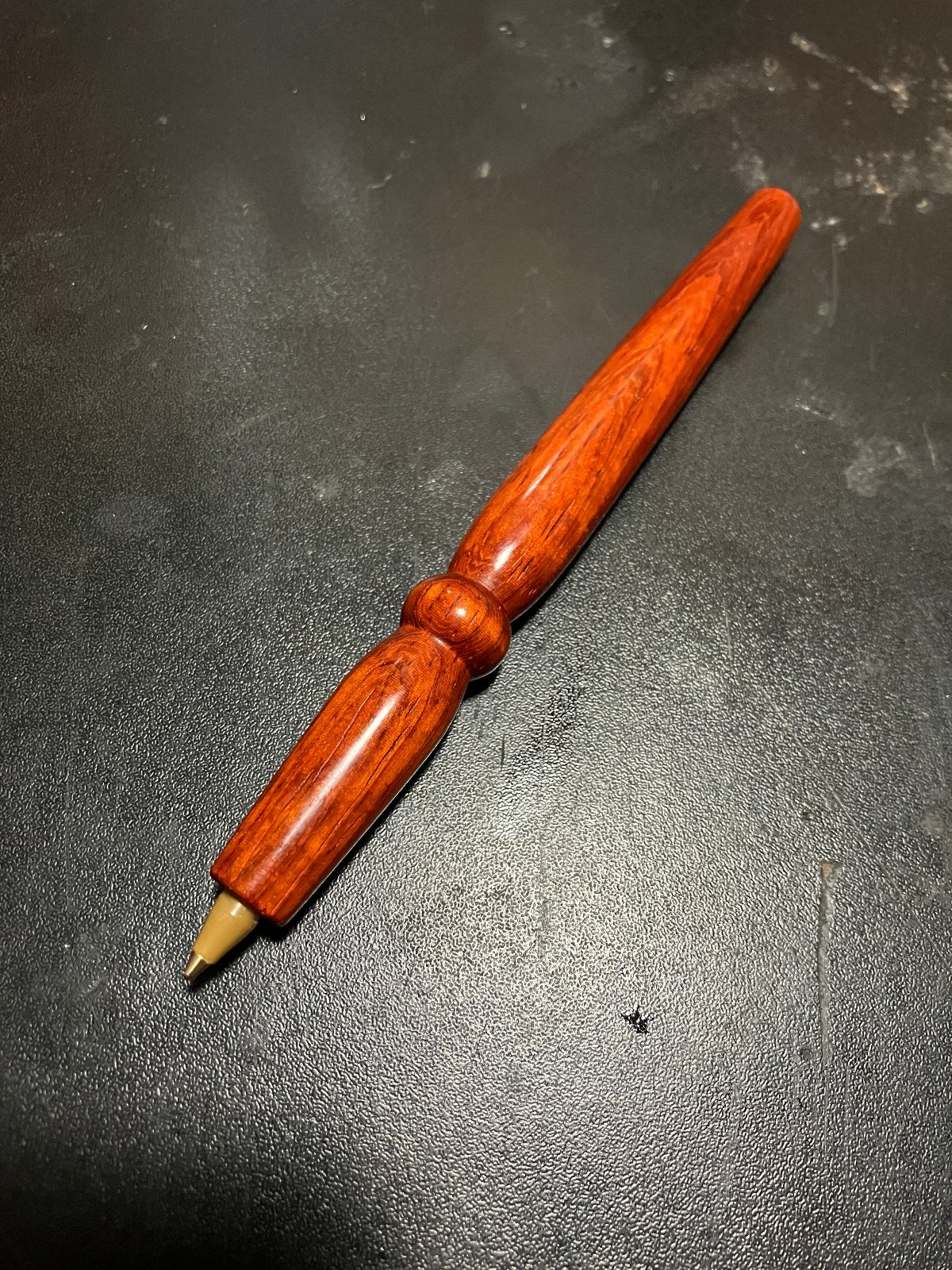

Seems straightforward enough. I should clarify that the Bic Round Stic and Bic Cristal have similar but different sized refills. The Cristal will need a hole significantly narrower than the 1/4" that worked great for the Round Stic. Might be a bit of a challenge to find a drill bit narrow enough and long enough at the same time. Then again, maybe I can just drill a normal 7mm hole through most of the blank, and just the end gets a smaller hole. I'll figure something out and report back when I've given it a shot.
I think I pulled it off okay. The part of the refill I hoped to friction fit had a diameter of exactly 5/32". I bought an 8" long 1/8" bit, did my best to drill a straight and centered blind hole in a piece of padauk (tricky but it went okay drilling on the lathe), and then used a hand drill to expand the first inch or so of the hole to 5/32" with a regular bit in my hand drill. Then I just mounted it with the dead center in that hole and a standard 60° cone center in the tailstock and turned it. Sanded quickly 320/400/600, did one application of scratch freee, and 3 coats of Pens Plus (I'm new to this stuff and pretty impressed so far). Then one last coat of ren wax for good measure before parting off with the skew and lightly touching up the back of the pen by hand. The refill had to be trimmed a bit shorter, but slipped right in and stays put no problem.
Good to have this method in my arsensal now! The material cost on a pen like this is so cheap it might as well be free. Time cost isn't bad either. And as far as ballpoint refills go, I think Cristal is one of the better ones.

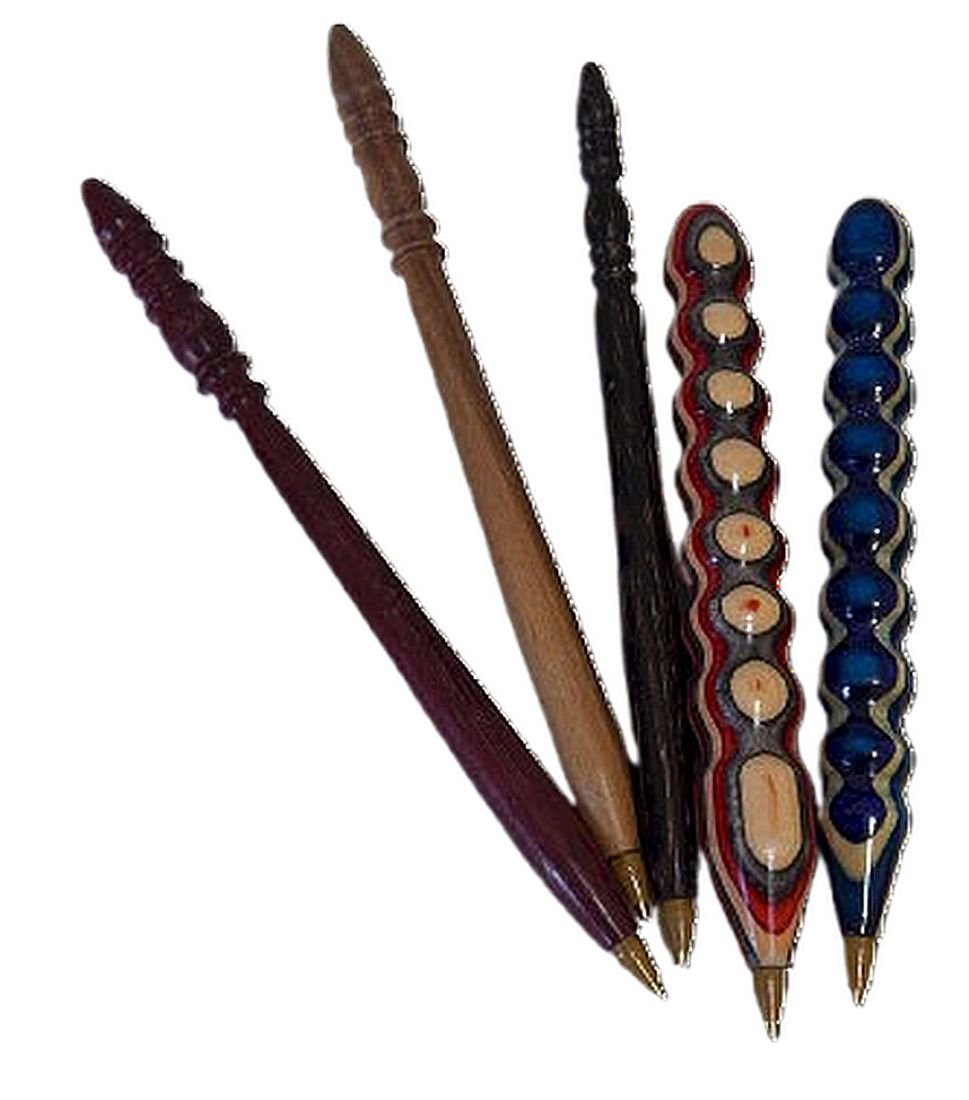

Love the Bic Crystal refills. I make the super easy stick pens with them. By the way, the refills are great and seem to last forever. My stick pens bleow made from Spectraply and also dimensional hardwoods. All contain the Bic Crystal refill
