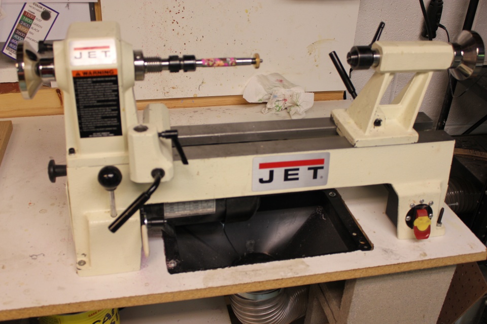

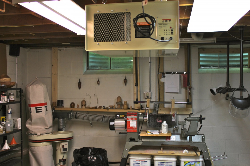

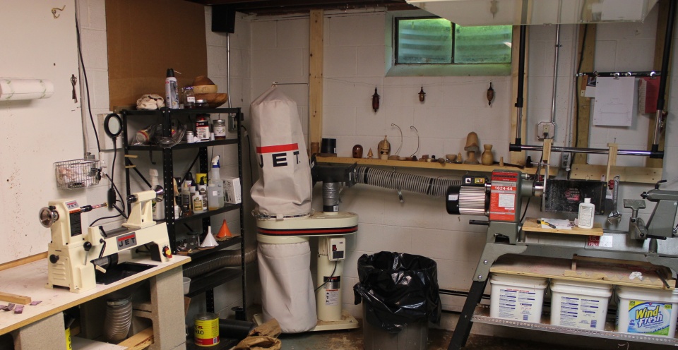

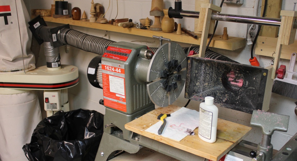

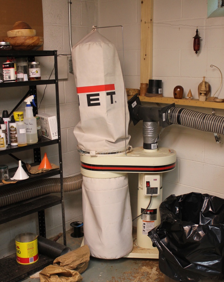

Hi Warren
I have a Jet 1 HP cyclone filter that I use for 2 lathes with blast gates to shut off whatever I'm not using; and a ceiling mounted Jet air filter.
I am sorry I did not go for a stronger (1.5 or 2 HP) cyclone! I do love the ceiling mounted unit, but that will double the cost. I'm in a spacious but musty basement with little ventilation. Recently I mounted a window fan simply to pull air out, and installed an open screen in a window 30' away. I can turn this on to simply circulate outside air in and out - has helped tremendously with just a fresher smell.
I think you'll have better luck with a 1.5 HP unit!
FYI: Woodcraft has a 15% off sale on JET right now I believe.
Best of luck!
