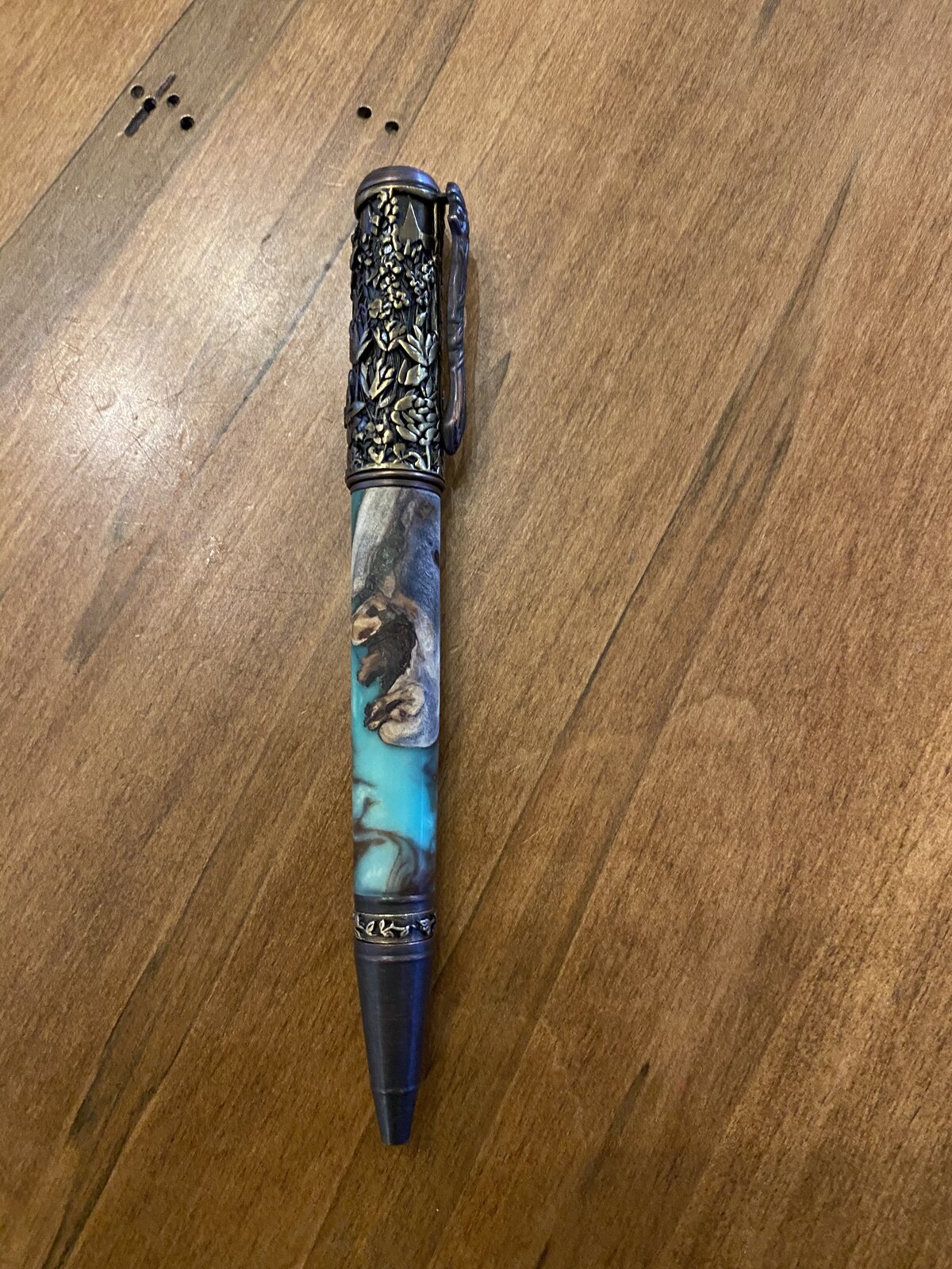

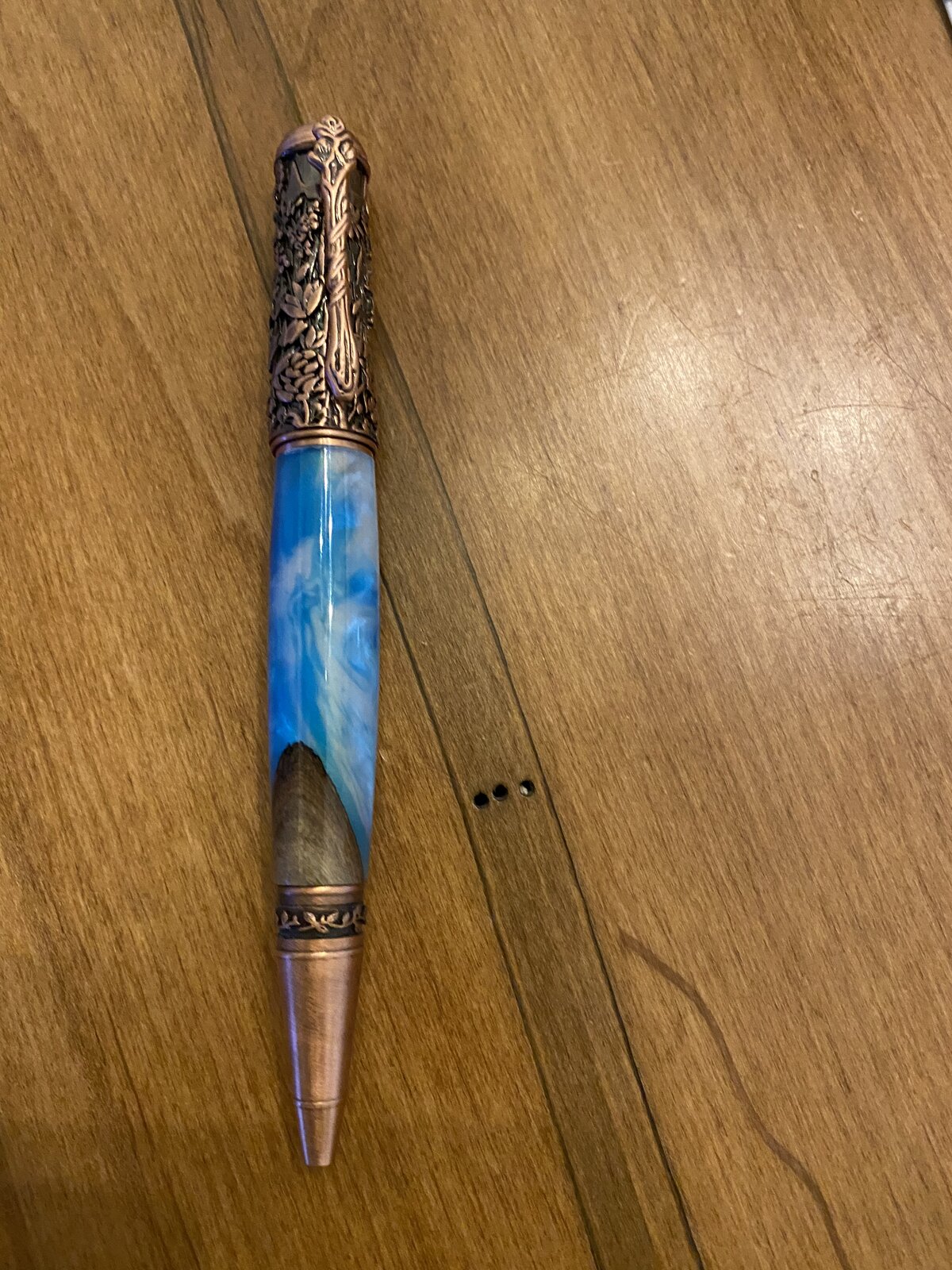

I just finished 4 of them. I did not have any issues like Monty described. Pieces are high quality and heavy. I did have to mess with the transmission depth a little before I assembled top piece but that was it.
