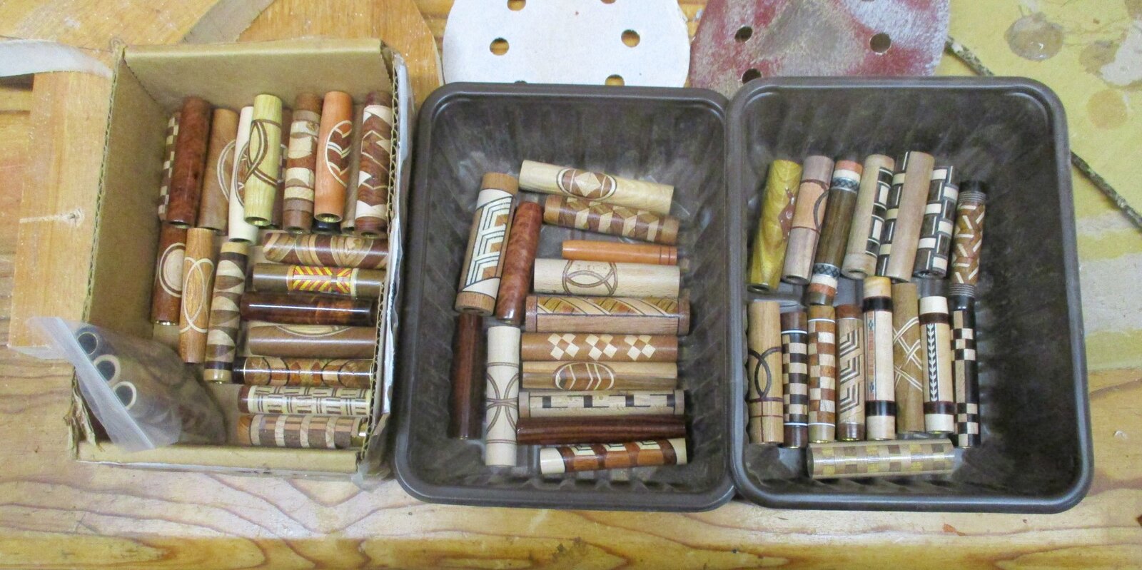

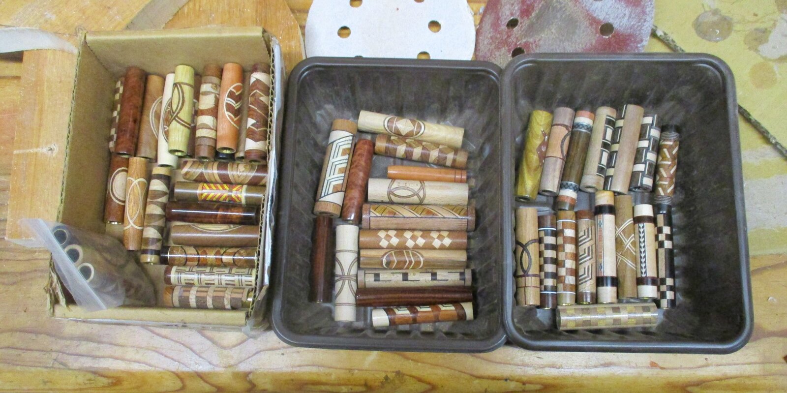

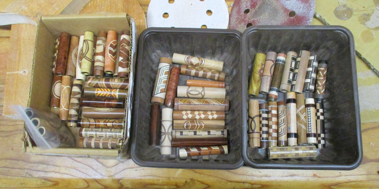

I normally only make segmented pens and my enjoyment is in the design and construction. Very few end up as pens.
In the early days most went into pen kits but now instead of a drawerful of pens I have a drawerful of tubes. IMG_1932.jpg
In the early days most went into pen kits but now instead of a drawerful of pens I have a drawerful of tubes.View attachment 339989
That is an impressive drawerful - several! (of blanks). Excellent artistry Alan.
