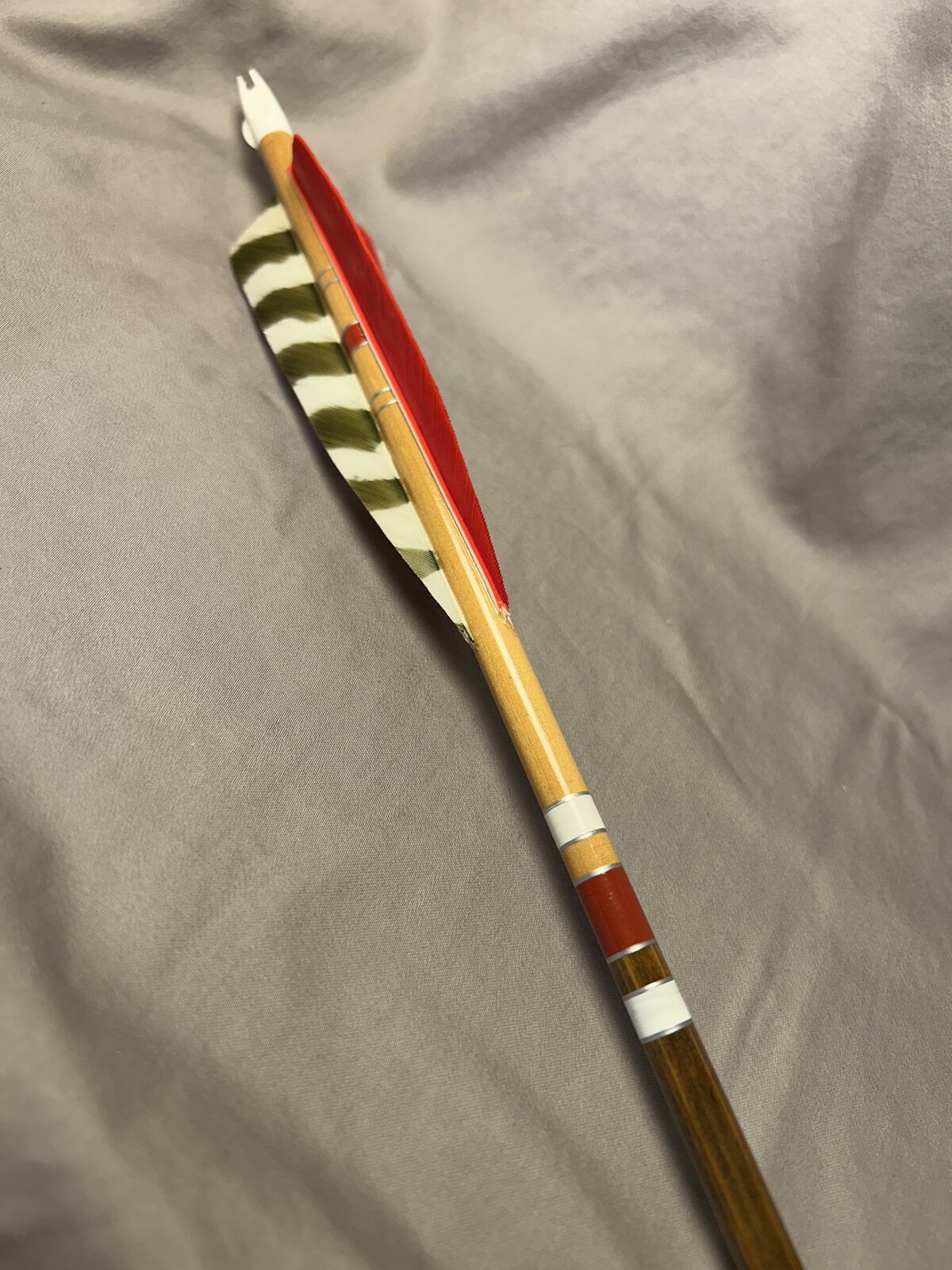

Made a lot of arrows out of Douglas fir, never a pen (and I didn't turn it🙄)
