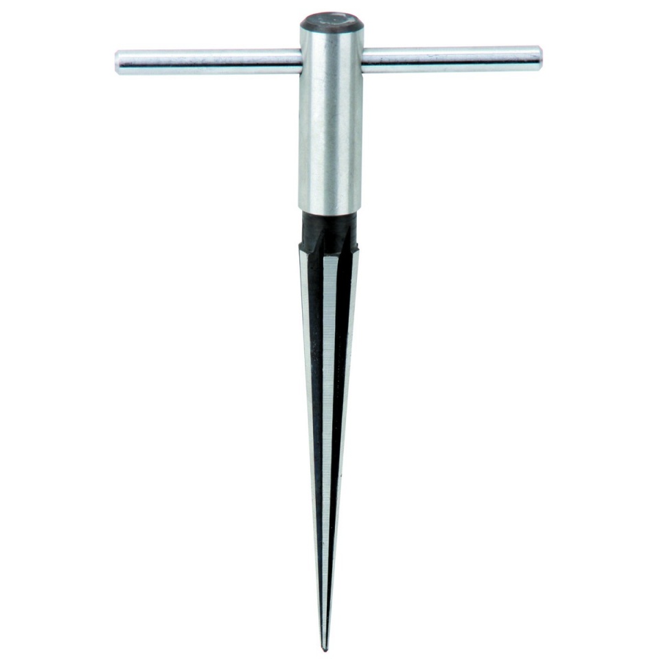

I have used a chamfering tool on the inside . It worked great solved the problem and everything slipped in and out smoother.

Just made nine today, Carl, with no issues. Solid end first on the spring. Before turning I hand ream both ends of the tube with a size "L" bit. If the spring gets hung up on the ribbed side when inserting, carefully pull it out with some needle nose pliers and try again. If it goes in past the ribbed slots, but is still protruding a little bit you can carefully press it in.
