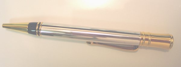

I have turned aluminum. You can actually buy the blanks in PSI's catalog I believe. I got some bar stock and made the blanks myself. the pens turned out good but take a long time to turn down to shape. You better be good at sharpening your tools. Regular HSS tools can be used although I used a carbide tool to rough it down.
Chris

I have made few aluminum pens and each one was a challenge but very fun. I have found that the type of aluminum used is very important. The first ones I made were from aluminum from a home improvement store. I thought it turned ok but I had nothing to compare it to. I then purchased some 6160 aluminum, I belive that is the same as the blanks you are referring to. This aluminum turned much better and had a better finish. Play with the finish a bit. Some like the mirror finish, like on Chris's pen above, others like a more satin finish, which tends to hides scratches and dents better. As far as tools I used HSS tools but I was a sharpening fool. I belive carbide tools would work much better. You can do many things with aluminum from powder coating to anodizing. It is a fun route to take.
