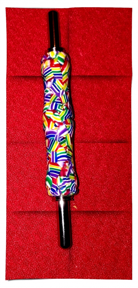

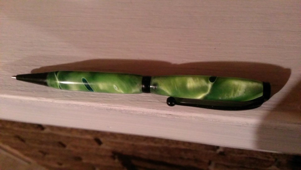

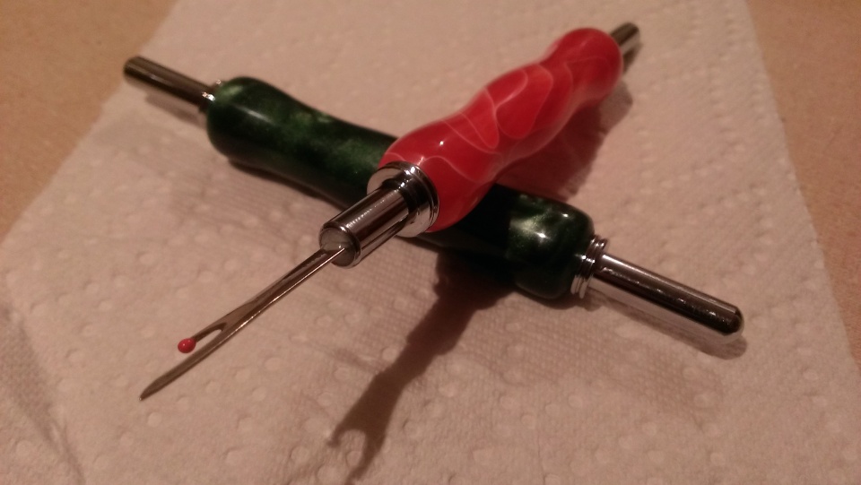

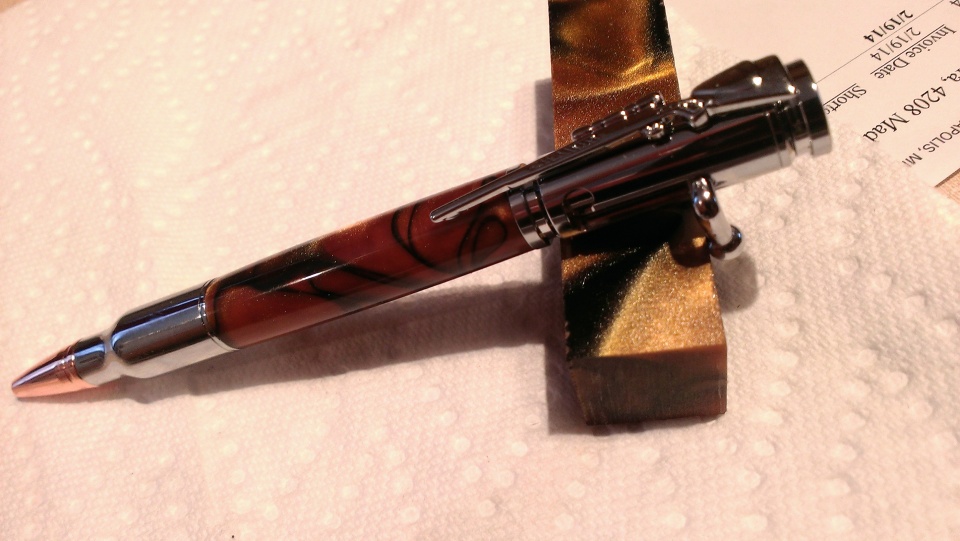

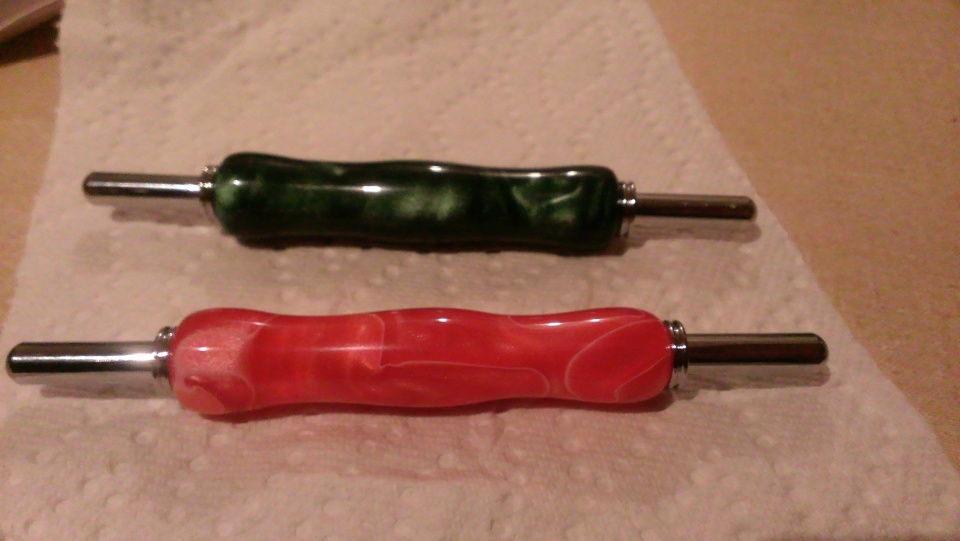

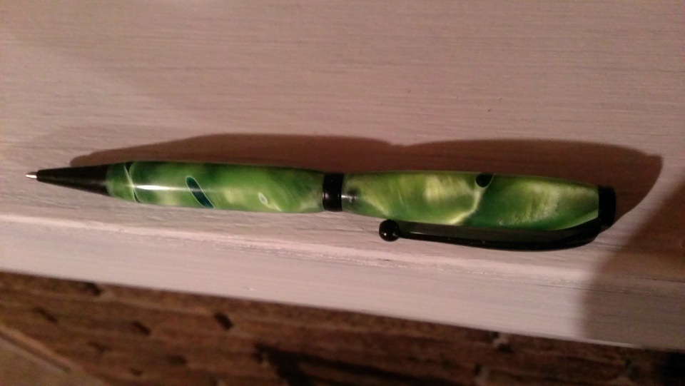

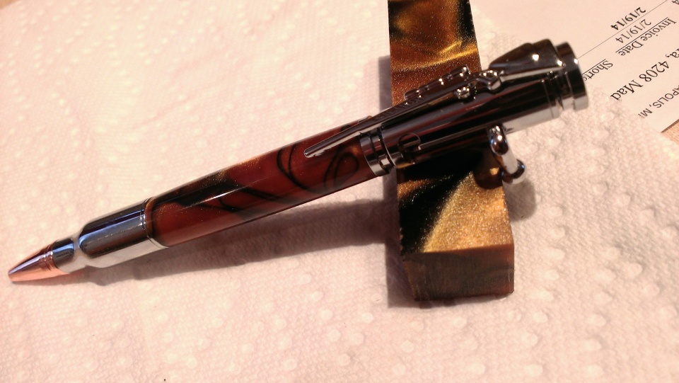

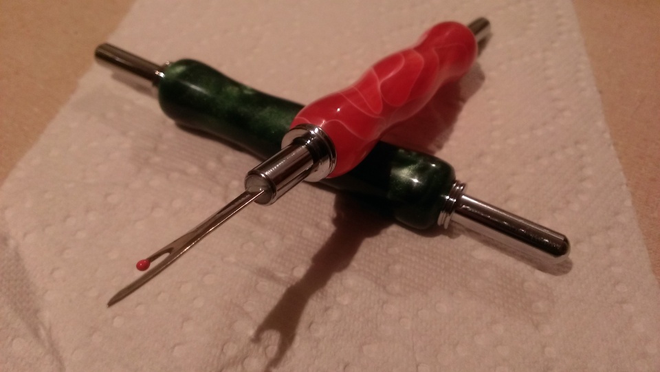

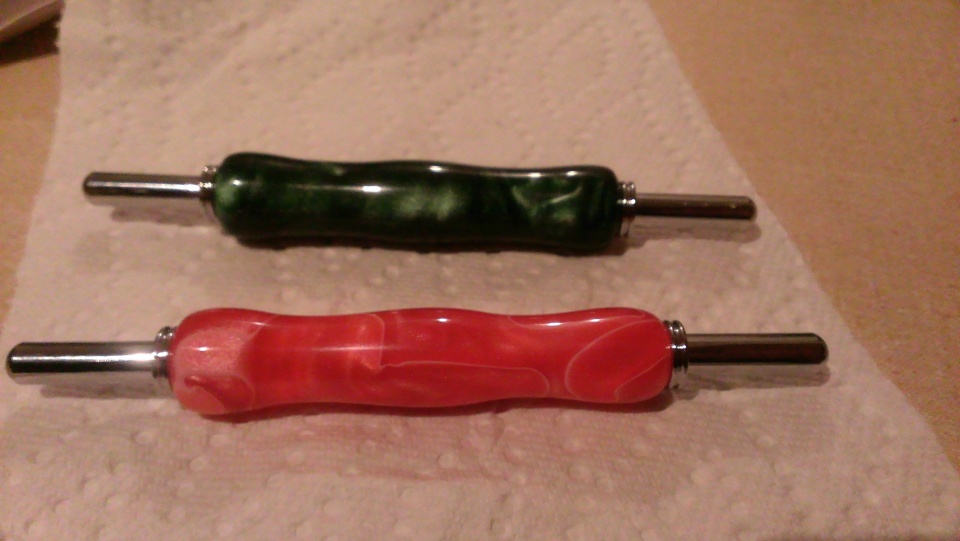

This is an amazing product that saves a lot of time and had the same high shine gloss as going all the way to 12k wet micro mesh. If your acrylic blank has edges or hard to sand area this stuff is great! I and to 600 wet then jump to 1k. Wipe dry and put on the waxes. Attached is some pictures of 2 seam rippers for a customer. And a few other acrylic items with this great polishing wax.
